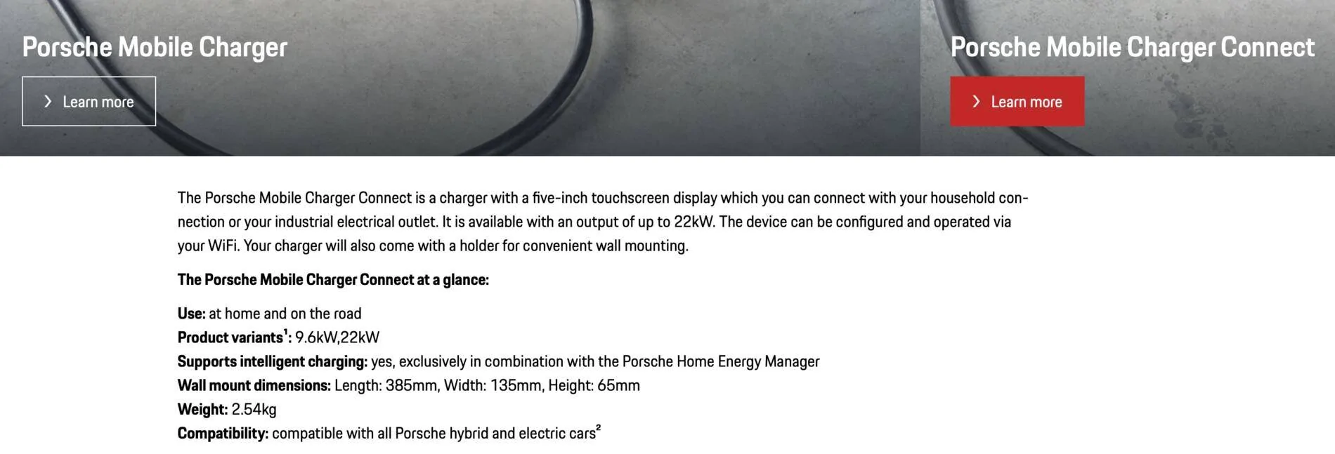

But I will strongly disagree that it is useless. Here in Europe we can have 3 phase connection and the charger then delivers 22 kW. 3 phase power supply is a real differentiator compared to the US. And none of the cables get hot when charging at full power. The 2020 Taycan unfortunately can not make use of this but others can. The Zoe for example works just fine. Early Teslas should work fine also but I have not tested. The charger as part of the Porsche system will also show the charging cycle on MyPorsche if it is connected via WiFi. It can be configured to be private or work etc and show the cost for each charge if needed and you are interested.
And one really great feature we can have in Europe is that it is portable! You can take it with you, plug into a standard 3 phase Commando socket and have 22 kW on the road. I would have loved to have had the option of 22 kW in the car and could hve charged the car quite quickly at the marina. Just plug in and you are charging!
I will agree that it is quite big but it works great. I guess long term quality will show in a few years time.
Take it for what it is and you will be happy, but there are alternatives of course. Are they any better. Time will tell.
