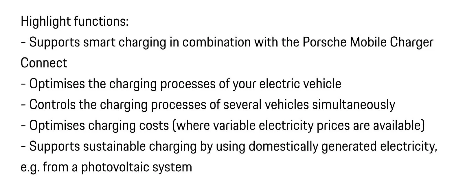

I have the HEM installed and it has not helped. Its only function is to prevent your wall charger from overloading your house's grid connection.
I dont quite understand that when i read the specs for the HEM…
Looks like it was supposed to make the charging programmable in every way?

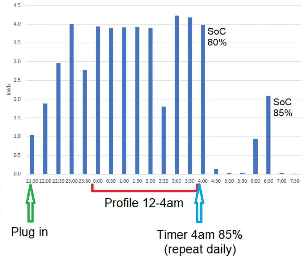

My first long charge with 12-4am profile and 4am timer. kWh power draw in 30-minute blocks.
From this I can now provide a comprehensive guide for getting your Taycan to charge the way you want it to:

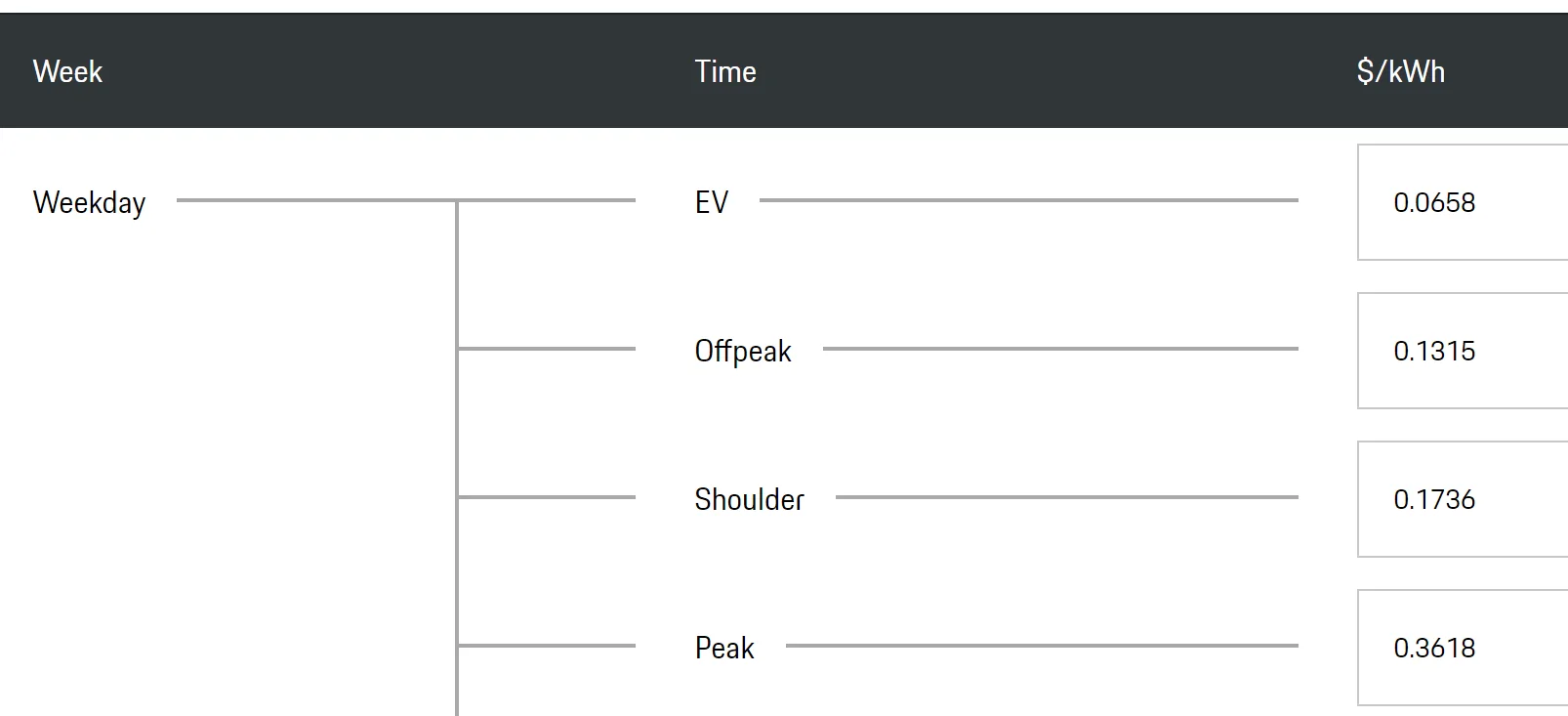

  2. Enter your variable electricity tariff (for the period between 12am and 4am) - may be fake a tariff that makes this period cheaper than the other period

Thanks for the idea... I have entered all my tariff periods (12!) and done all other steps. Still using a timer tonight (as I ran the car down to 21% and need it charged for tomorrow) but will try disabling the timer after tomorrow and seeing if the charge takes.

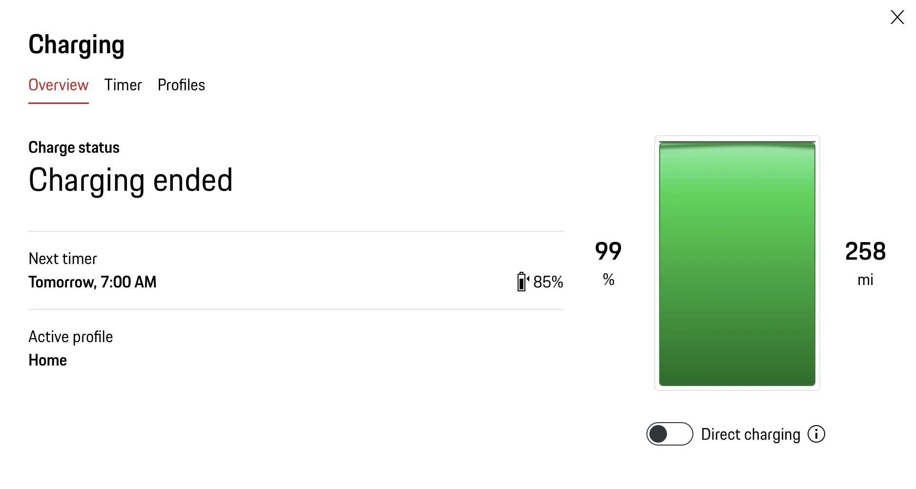

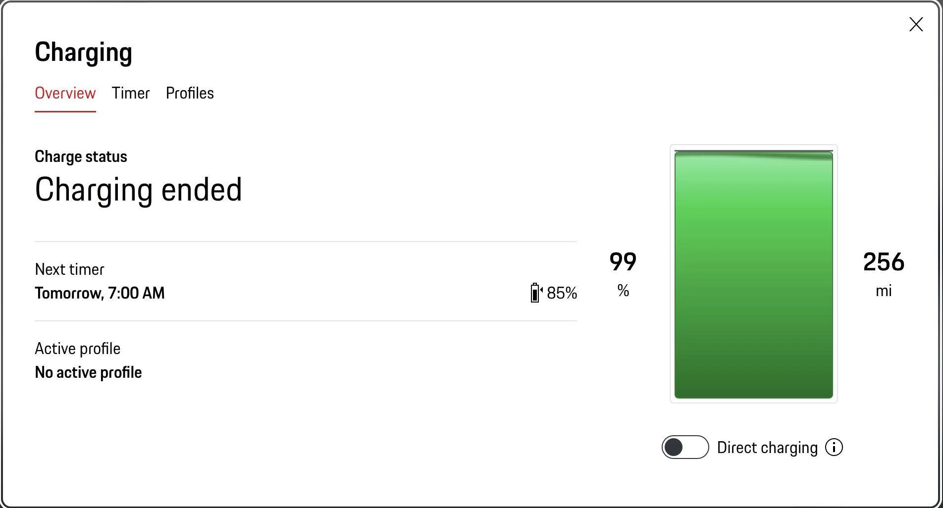

I give up, no matter what I do when I plug the car in, it charges to 100% every single time!!
Any idea why it says, "No active profile" even though I have clearly set one up and enabled it?
Porsche Taycan Taycan Charging Quick Reference [Profiles and Timers] Screenshot 2023-05-19 at 10.28.21 PM
Porsche Taycan Taycan Charging Quick Reference [Profiles and Timers] Screenshot 2023-05-19 at 10.30.30 PM

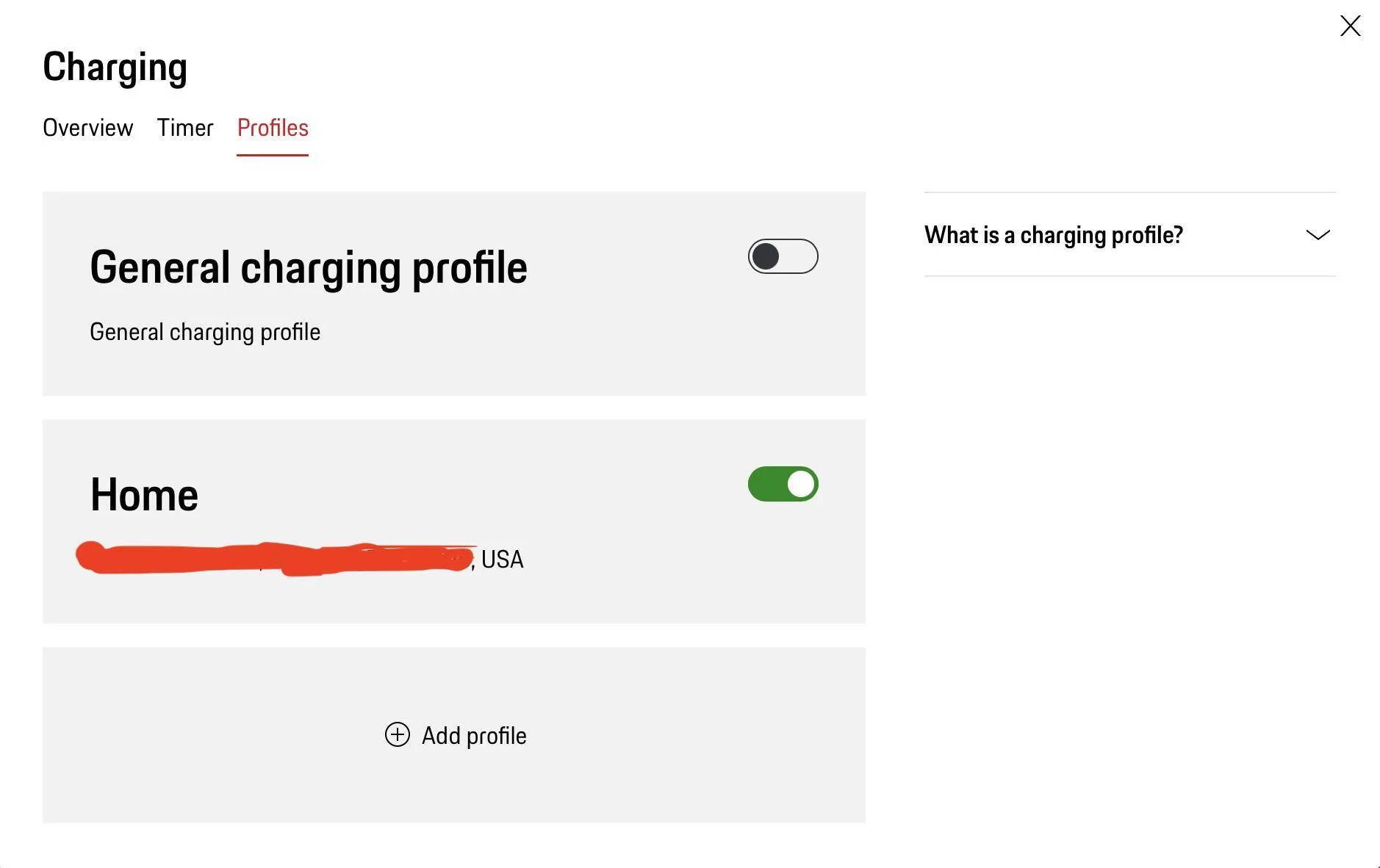

I believe I just solved my issue. I deleted the profile that I created named "Home" and simply created a new one. Sent to the car and my newly created "Home" profile is now active! ??
Porsche Taycan Taycan Charging Quick Reference [Profiles and Timers] Screenshot 2023-05-19 at 10.48.41 PM
