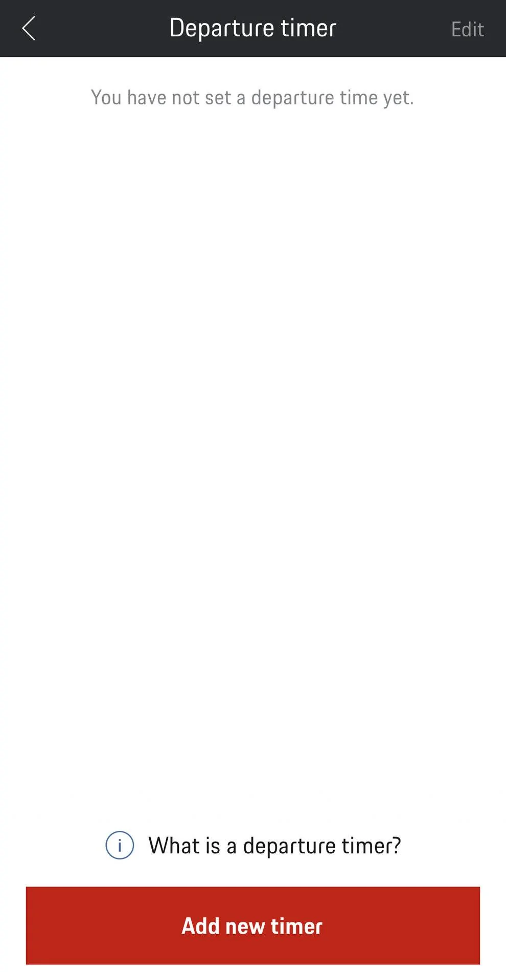

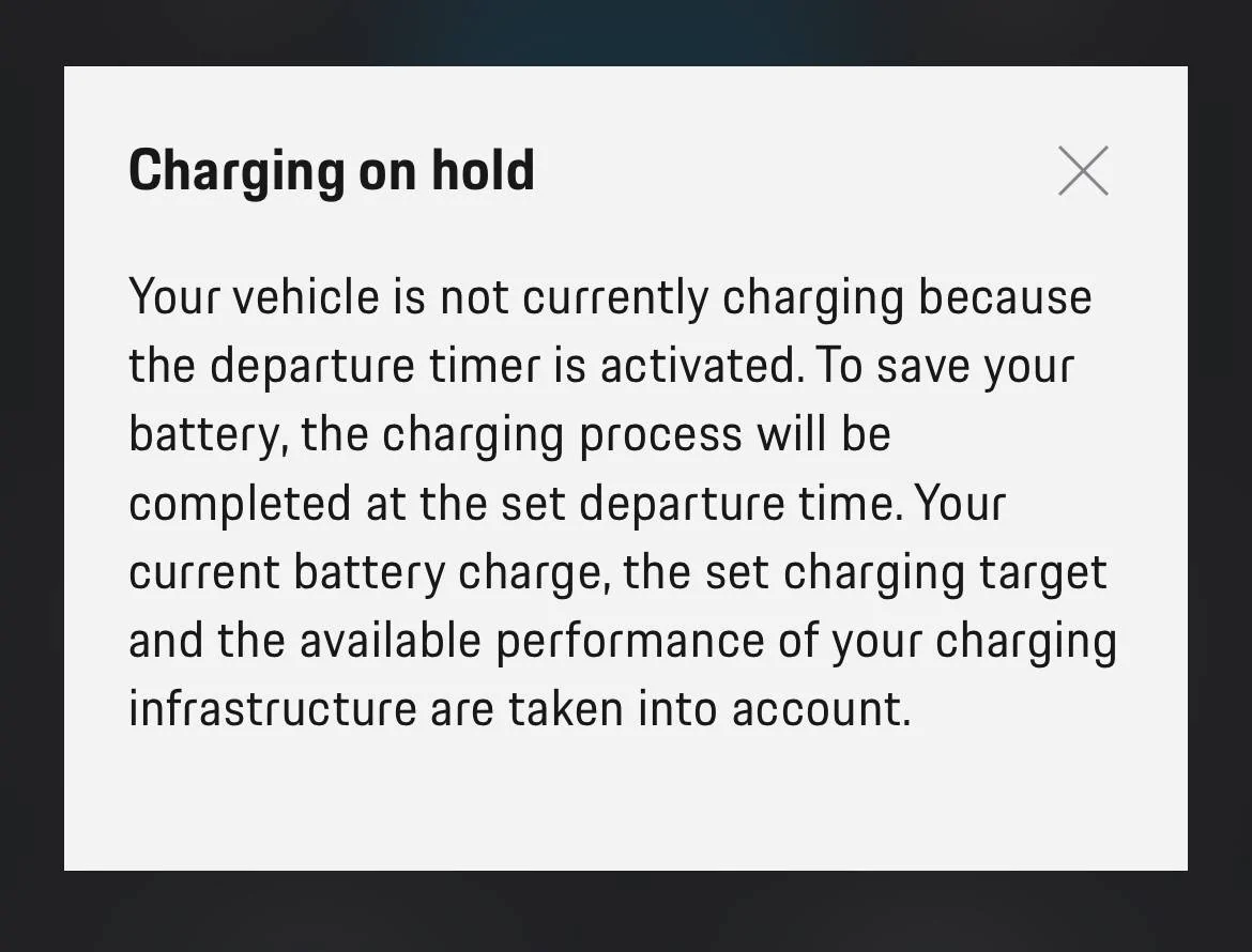

Thank you, the situation is simple:
The charging is paused with the hint as attached. But there is no departure timer set. See 2nd picture.
Based on this (limited) information, I would guess it’s just a bug and report it to Porsche, but there may be more I am missing. Sorry. ?‍♂
