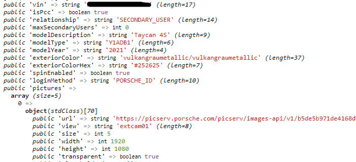

So, a quick tutorial...
This requires a valid cert in your php.ini. Get the latest here: https://curl.haxx.se/docs/caextract.html
And in your php.ini add (use
Code:
curl.cainfo = E:\LOCATION\cacert-SOME-DATE.pem
There is a way to skip this with curl, but due to it being a security nightmare I won't tell you how.
To get your API and Auth just hit up the network tab in the inspect window as outlined in the quoted post, refresh, and then just search for "Bearer" like so:
Click on the "Authoriz..." text and the right part of the window will show you both the apikey and auth headers under "Request Headers", highlighted in yellow for you.
Someone else is going to have to come up with logging in and capturing token to get correct auth for each and every option. This all reminded me of how much I despise web development.

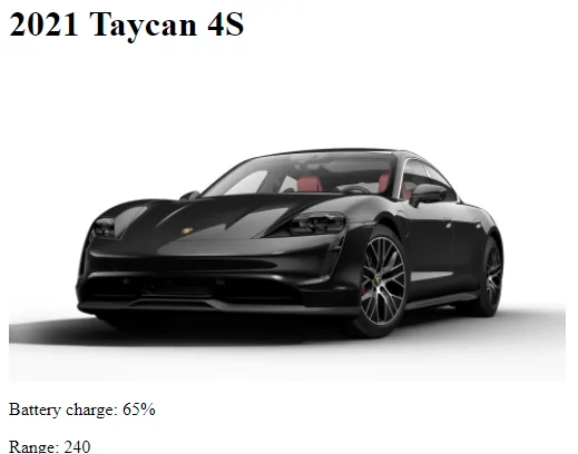

Just converted your code to PHP for fun. Works great! Will see if I can't get it converted to Kotlin for Android this weekend. Sadly no mac anymore so no Xcode. Guess I'll have to use my old Samsung for funsies.
Magic mirror next mayhaps? I mean, the API serves you correct images for your vehicle so it could look quite snazzy with some animations and be able to set heating while brushing your teeth f.ex.
