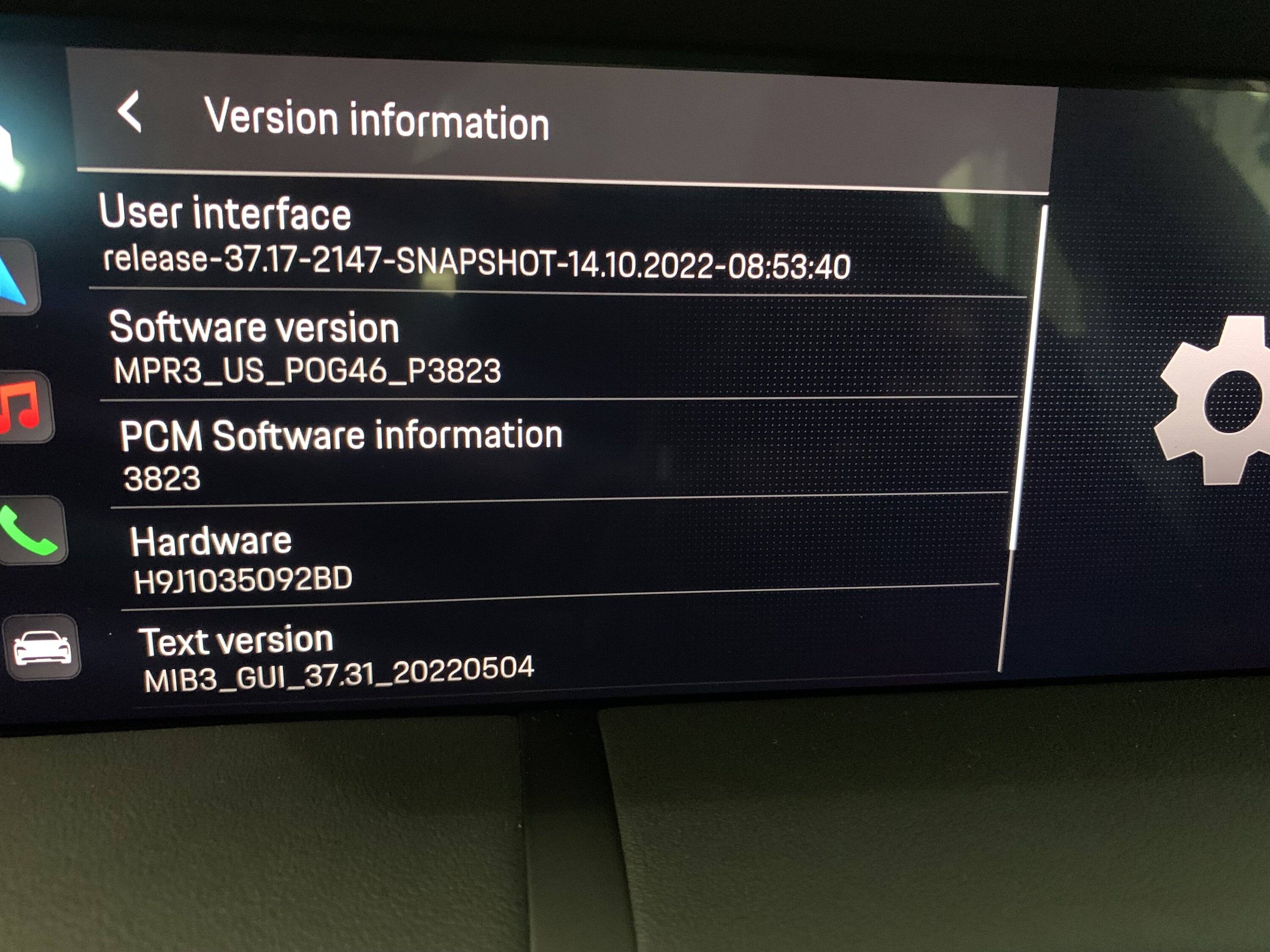

Hi all, I got the Porsche-Screen-of-Death for the first time today when starting my car. Reboot didn't fix it and I ended up having to use my phone to navigate as I was going to an area that I wasn't familiar with. Once I got there, I locked my door, came back 10 minutes later and all was good again.
So I'm wondering, do I have the latest software for my car?
I have this on my MY2023:
release version: MPR3_US_POG46_P3823
software version: 3823
user interface: release-37.17-2147-SNAPSHOT-14.10.2022-08:53:40
hardware: H9J1035092BD
text version: MIB3_GUI_37.31_20220504
navigation package: V03959817KQ_P1096_NA_2024.02
(Note: edit to add pic)
Looking at all those 2022's, I feel like I might have ancient software?
Does the car not do OTA updates? Do I need to schedule a visit with a dealer?
Thanks

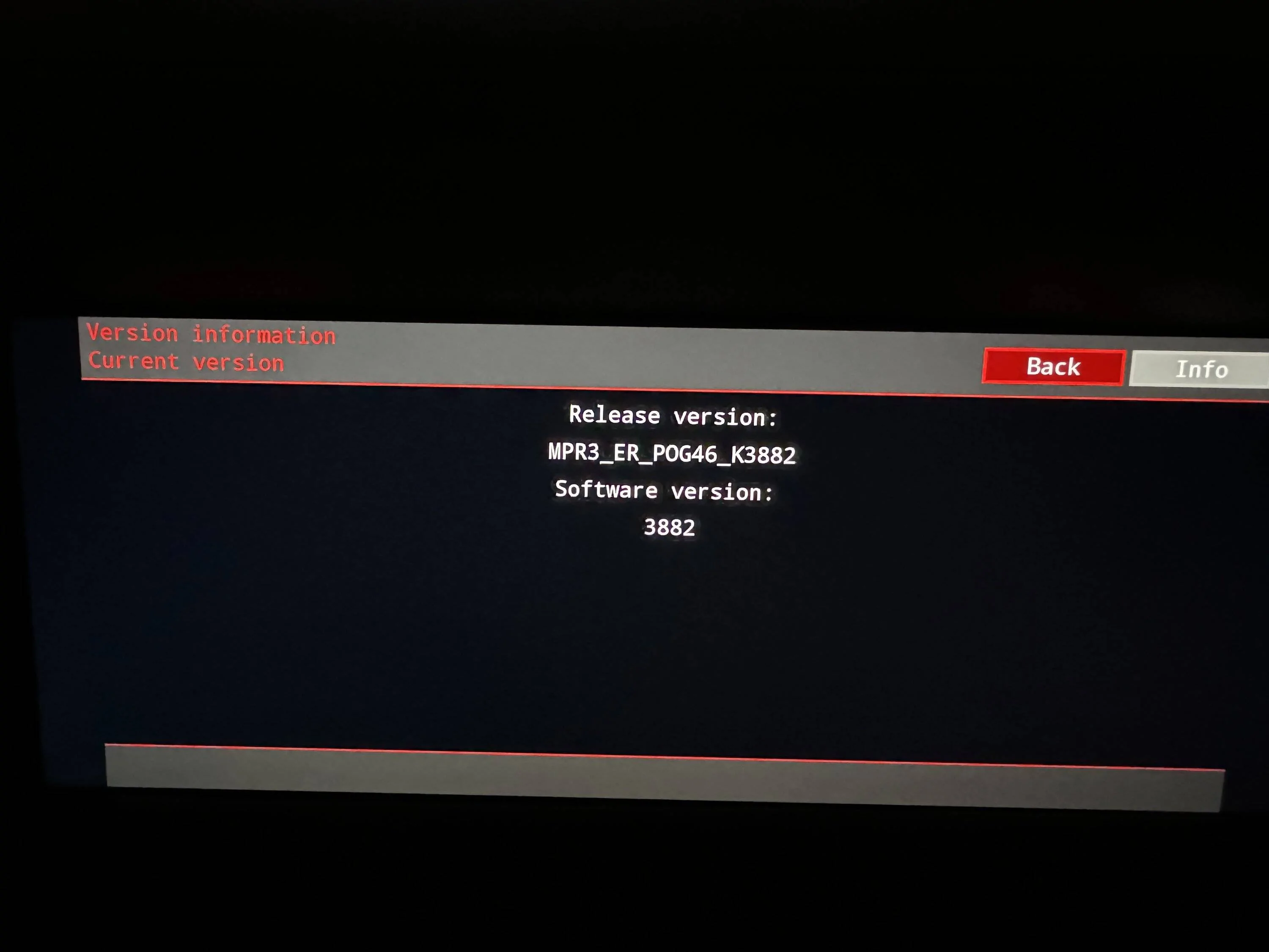

My 2020 UK car has the latest software and shows this PCM version number …

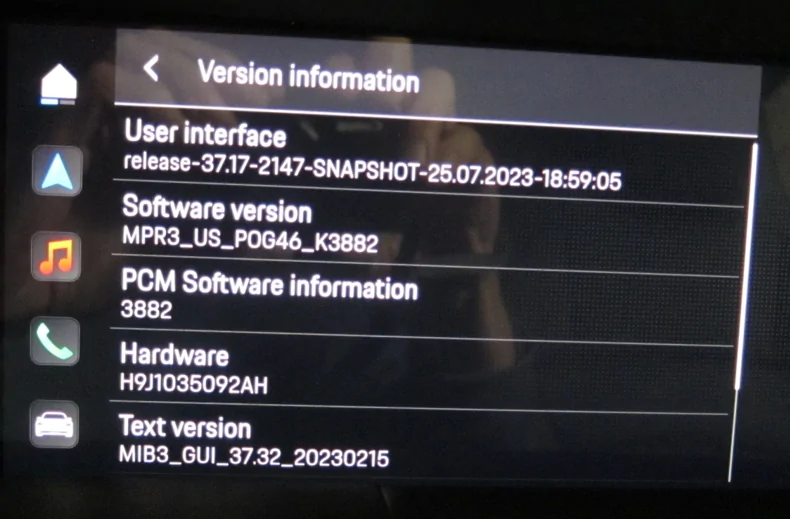

This is mine Taycan RWD (MY23) software version -> after doing WPN9 - Reprogramming central computer (PCM)
