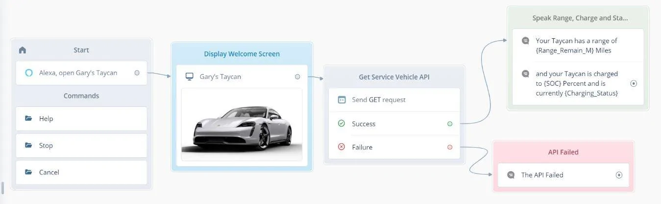

just following up my other post re Alexa integration.
Just sharing that I used voiceflow to build the quick test
You can setup a free account with 2 flow but it's pretty easy to get going if anyone want's to have a go.
I can share the config on main API request box if anyone is interested.

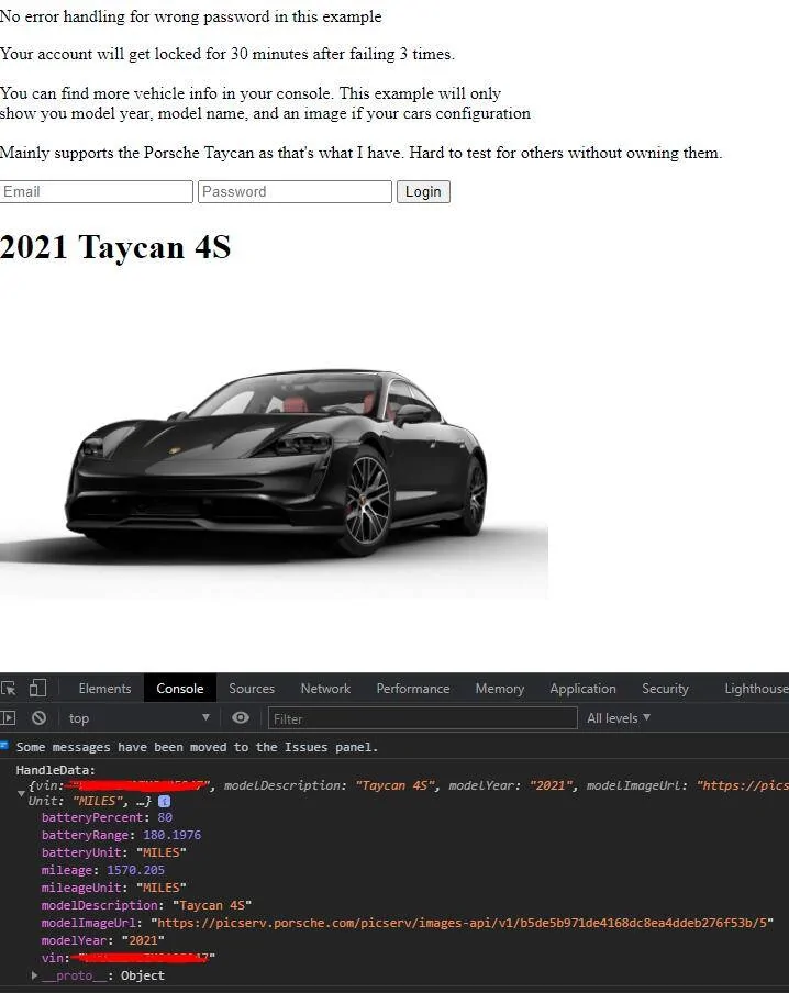

Here you go https://github.com/RiotNOR/phpporscheconnectapi
If you want to make a bunch of ajax calls you'll have to setup your own paths and functions. In the example it just fetches car info by vin directly after login is achieved. You could save the $webSession variable into the php session I guess so you can reuse it.
Do note I did not include any code for handling expiration date since it's all done with one login, so if you do as suggested above then just handle the received expiration that gets captured under "handleApiToken"
Included example looks like this + model logged into console for you:

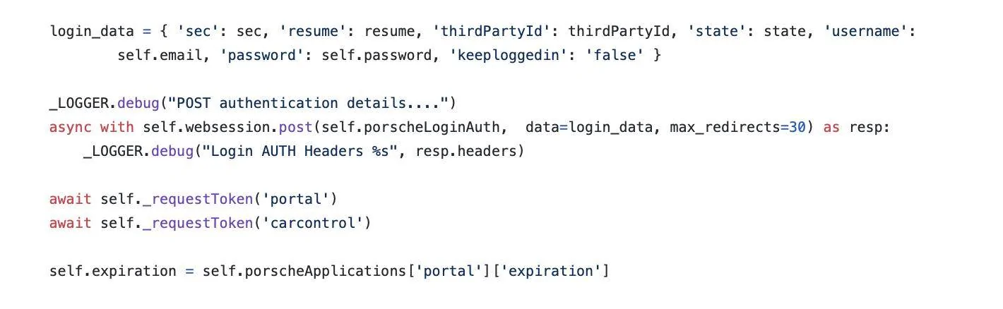

@cjne I have a brief question on one aspect of your code in relation to the Auth flow.
Is the purpose of the POST to the "porscheLoginAuth" endpoint just to get the cookies that are returned. And are those cookies then used in the two "requestToken" calls that you make?
If so, do you know are all the returned cookies required – are you just sending them all up (from your cookie jar) each time you make any subsequent calls?
This bit has me unsure – thank you!

Yes, the actual login (POST to "porscheLoginAuth") is generating cookies that are later used in the requests to get tokens.
I'm just sending them all up using the client session in subsequent requests.
The first requests for the login page was not needed by the way, i've pushed a cleaned up version to the repo.
I haven't done any code for session expiration yet, and i would like to investigate the possibility of getting a refresh token, it's not return with the access token and id token but maybe it can be obtained somehow.
Right now my code doesn't have much in way of error checking and tests are completely lacking, i might get around to do that at some point :)
