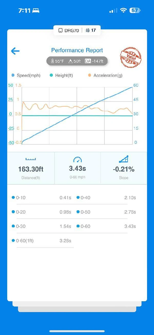

Just for fun, a few Dragy runs in a 2023 Taycan GTS with 21" Mission-e wheels and Pirelli P0 summer tires. Battery charged to about 75%. 76F battery temp, and 55F air temp, lukewarm tires at 36/41 PSI (a bit high?) and a road surface that was dry but a bit rough and a bit dirty, so not great conditions. Sport Plus mode, using launch control.
Times for the three runs were: 3.51 seconds, 3.43 seconds in the opposite direction, 3.41 seconds back in the first direction. Here's the middle run:
Porsche Taycan Taycan GTS Dragy results in non-optimal conditions (3.4 to 3.5 seconds) Dragy 1
The car definitely slowed briefly at the shift point around 50-ish miles per hour, then started pulling again. It "felt" to me like: a) The acceleration was limited more by software than by physics overall but b) The road surface and temperature perhaps did steal some time due to traction issues at lower speeds.
