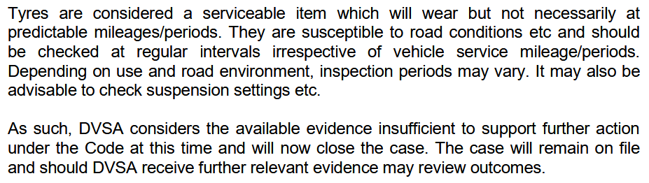

I thought I was on top of mine, but I just checked today (happened to be parked at full lock) and found:
Fr R: Tyre shoulder worn to cord in placed however only on shoulder - main tread worn evenly and measures a good 4mm all over (original tyre after car done 15,000miles). Not easily detectable - it's not even wear all the way around the tyre. Was in with Porsche (2 year service) 6 weeks ago and no issues found(!).
Fr L: Cords starting to show (yet still measures 5mm tread worn evenly). Done 5000miles.
I've raised the concern on the gov.uk link above; this feels dangerous (I'm a car guy and stay on top of maintenance so this caught me by surprise). Please everyone check your tyres!
UK GTS built mid-2023. Asymmetric 3 NF0.
UK DVSA have basically said they don't give a crap:
