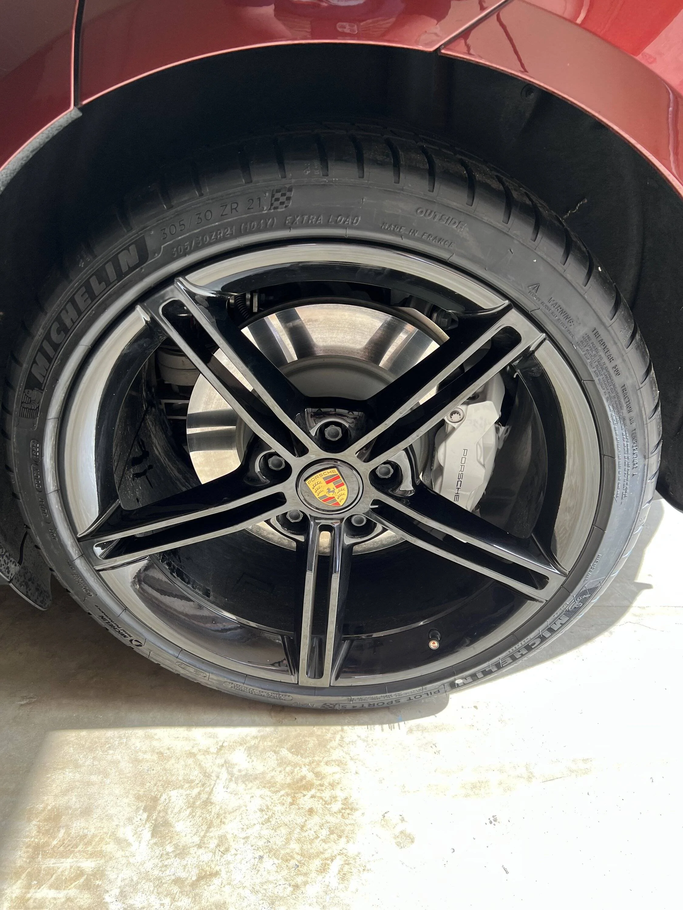

With that said, I've had Michelin PS4S tires on all my previous cars and it was a difficult decision to not go with them two weeks ago when I needed new tires on my Mission Es. But maybe not since the only available PS4S in 305/30/21 is a Mercedes spec tire...
DerekS
Derek
May 25, 2021
3,321
5,677
Los Gatos, CA
2025 Taycan GTS
Porsche Taycan Taycan Tire Expectancy? IMG_0005
mystermykee
Mar 30, 2022
708
487
Bay Area
9j1, 9y0 hybrid, 992.1
Yes mine are Asymmetric 3. Came on the car at delivery. I will certainly consider the same brand again when it is time to change. And now I understand they have brought out the Asymmetric 5?

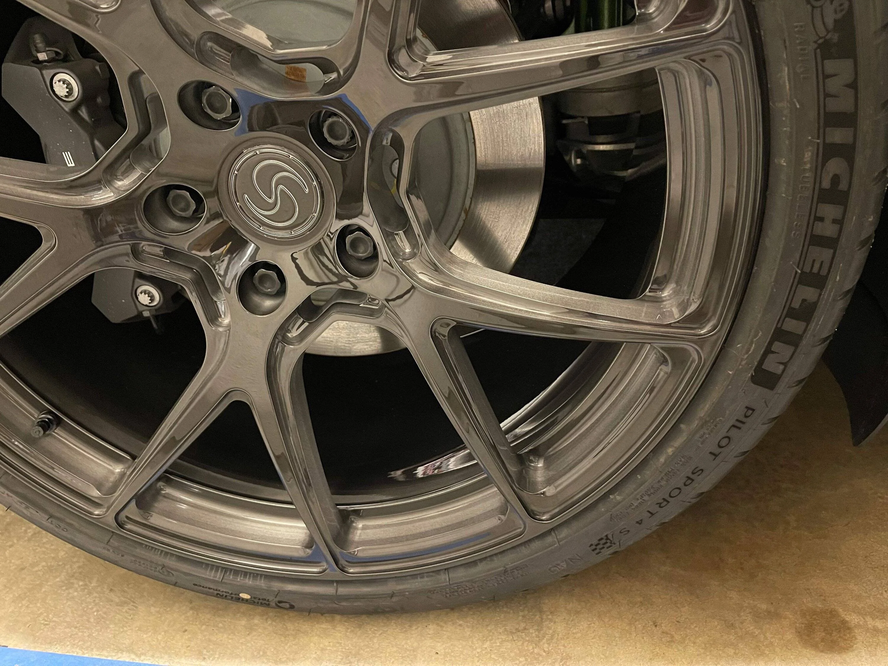

I replaced the OEM 20" wheels with Pirelli P7 All Season tires for the summer and installed a set of new 21" forged Signature Wheels with Michelin PS4S. Not a fair comparison between an all-season and summer only, but the difference is amazing !

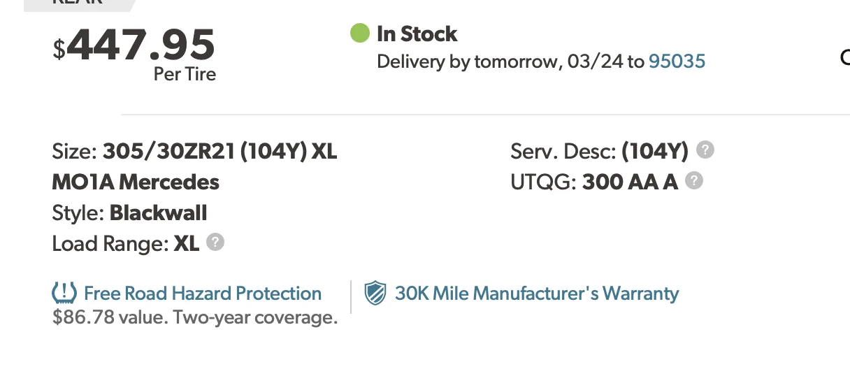

I'm on the Michelin website, and there are only two variants of the Pilot Sport 4S that come in 305/30/ZR21. One for the 911, and one for which I believe is a tire made for the Mercedes AMG GT.
mystermykee
Mar 30, 2022
708
487
Bay Area
Yep, those are the ones. Looked great, drove great, wore great.
I assume the "MO1A Mercedes" is just Mercedes' version of the N-rating nonsense.
Ah ok. I thought there was a generic version. I can't stomach mounting a tire that was made specifically made for an entirely different car, let alone two cars that have zero similarities. Glad it worked out for you.
