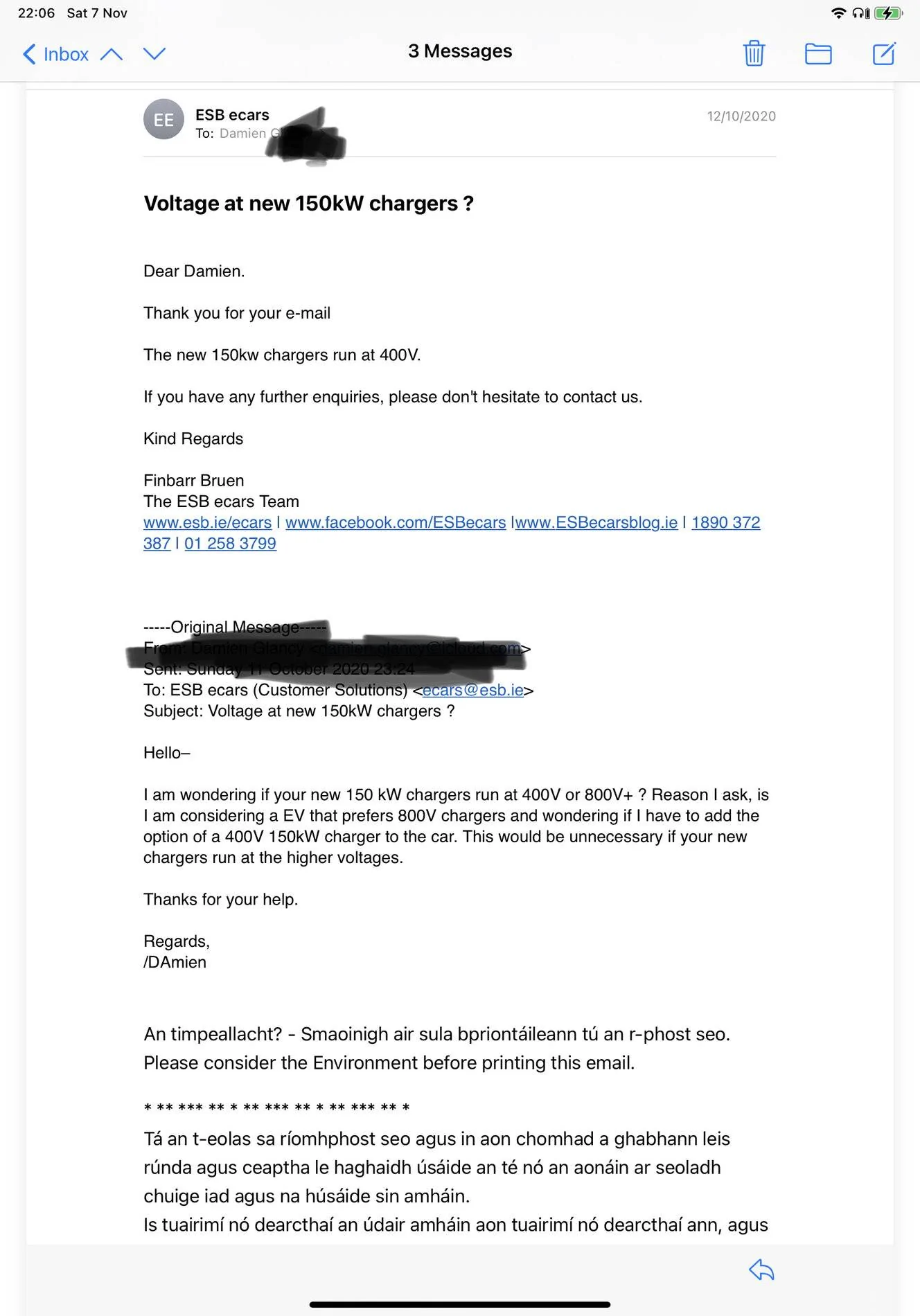

FWIW: The 150DC is required in Republic of Ireland too - there are a lot of 150kWH chargers planned by ESB over next year or two and they have confirmed to me that they will run at 400V.
well that might encourage me to add it to my Turbo spec. Darn all use on my 4S where charging at anything other than IONITY super chargers was tedious (Cork Kerry and Limerick were a problem)
Have you a link where I can read more?
(50kw charging is a pain for Taycan owners - 150kw would mean 30/45mins would add 125 - 140 miles (200-225km) bearable when 50kw applies a long stay penalty for visits >45mins)
