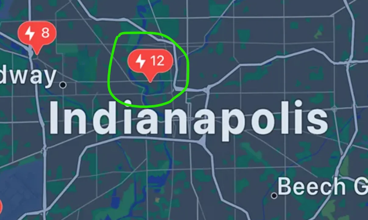

Which downtown station did you try?
This one circled that is by the Canal and then I went to the other one that is to the left near Speedway, but as I mentioned I could not test it as there was no room.
Both in the PCM and Tesla App as supporting non-Tesla vehicles with the adapter.

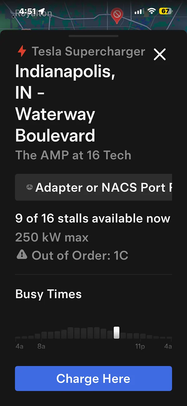

16 chargers, #1C out of commission (as shown in the app), so maybe that’s the one you tried to connect to?
In any case, with the difficulty you’ve been having connecting to what is by far the most reliable/accessible DCFC network in the US, you’re probably right not to count on using Superchargers...
That is the one and I tried 2C and 2B and then gave up. The expected behavior is for the car to start "thinking" by attempting to connect which may take 2 minutes. During that time on the working location, I waited to see if Plug & Charge would work but when it did not, I unplug/plug back and then initiated charge from the Tesla App. However, on both failed locations, the car did not react when I plugged in at all, no white light blinking, nothing inside the car, until it said, Charging Not Possible and Unknown Error.
