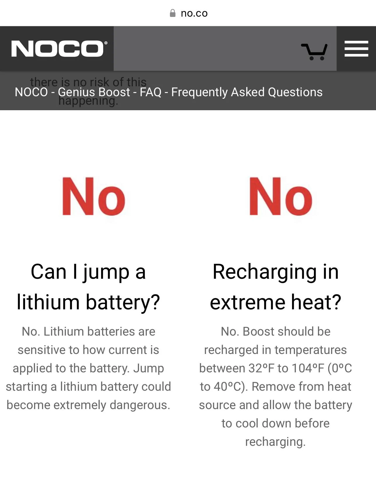

Just read this below…
Also read the attachment in @Scandinavian post above!
tells you everything you need to know without adding more words or videos from clowns on YouTube.
simcity
Sean
May 22, 2022
1,546
1,288
Suffolk, UK
'23 Taycan Turbo
We're talking about unlocking the frunk.
Yep. Don’t boost it. Charge it with the correct device which has a wake up function.
Long term you’re potentially fudging your 12V battery and short term it’s potentially quite dangerous.
