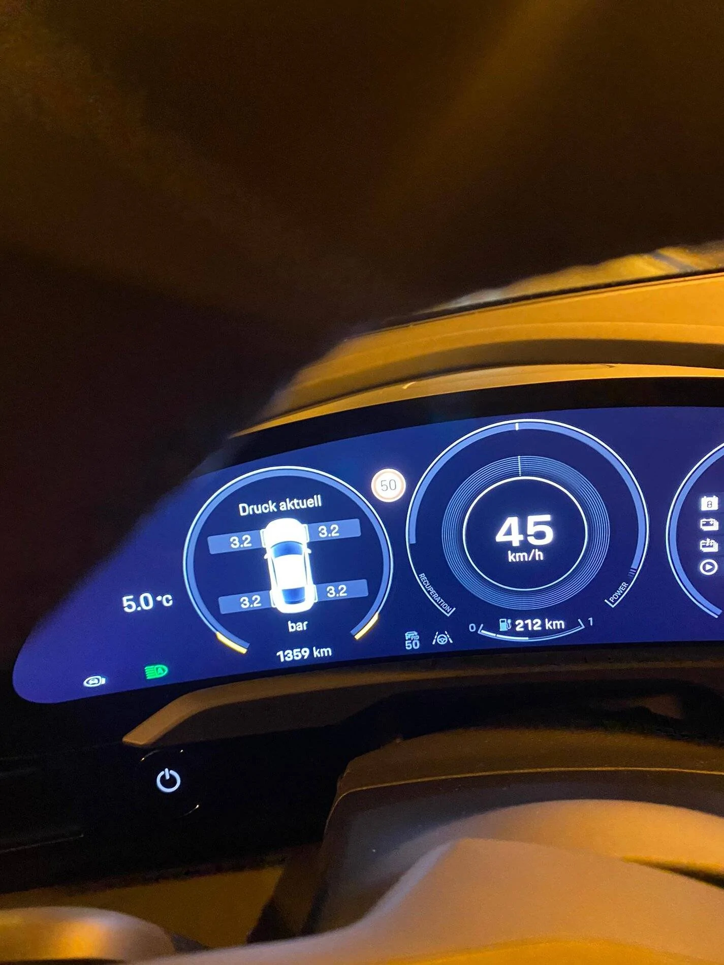

3.2 bar at 5°C is not bad, should give you good range.
Porsche Taycan Tire pressure 20210409_171809
I see up to 3.2 bar, when it is really hot!
I also agree, that the car gets slightly less comfortable with high tire pressure, but it still handles very well!
For long range high way driving, pump it up to get the range, for bumpy city driving let some air out.
I went down to 2.8 now. What I gathered from others here it might be close to what Porsche thinks fits the Taycan.
Another thing: why does the front need more pressure than the back? Isn't it with ICE that the weight of the engine demands that? I thought with the all wheel EV it should be even.
