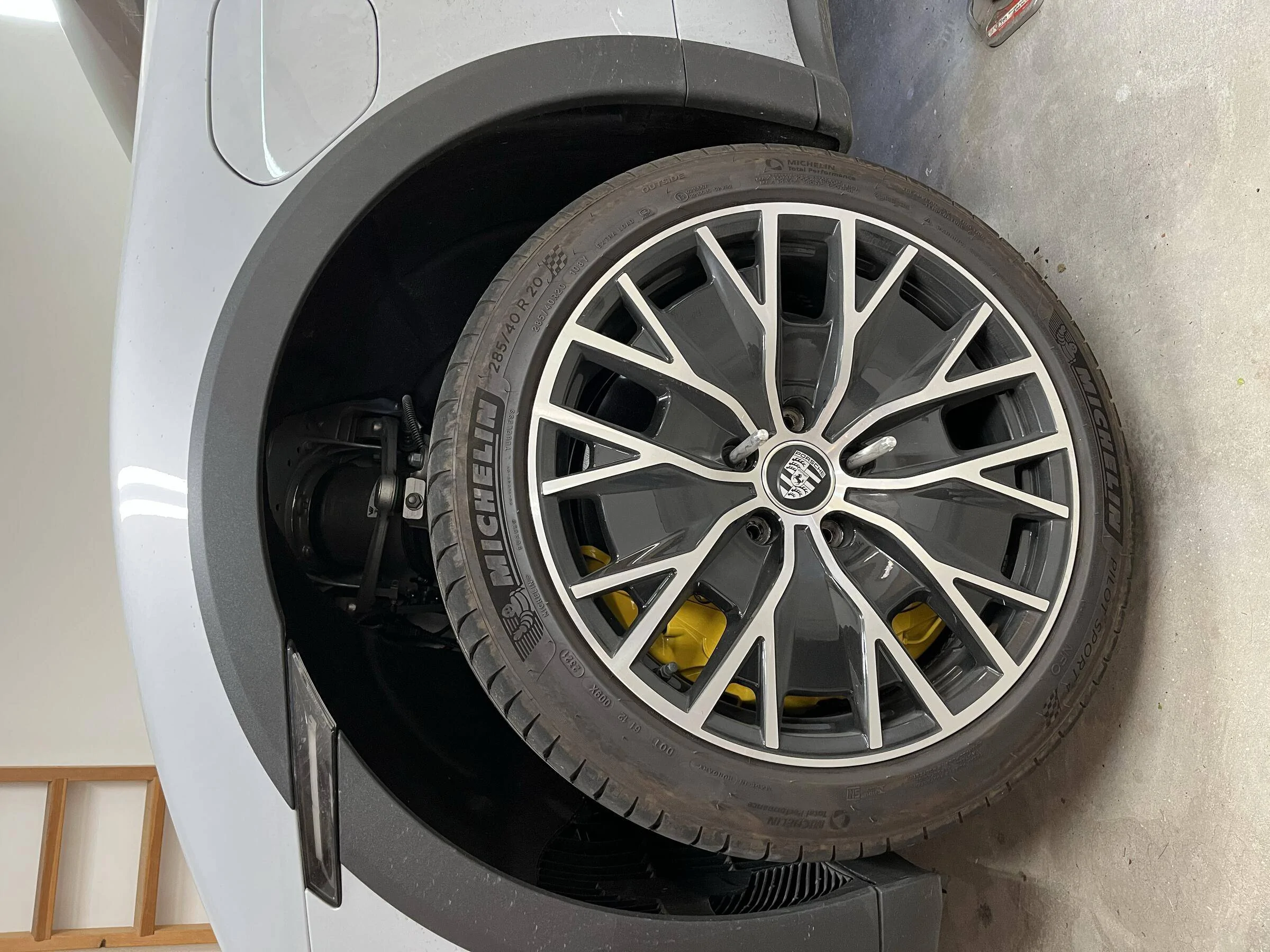

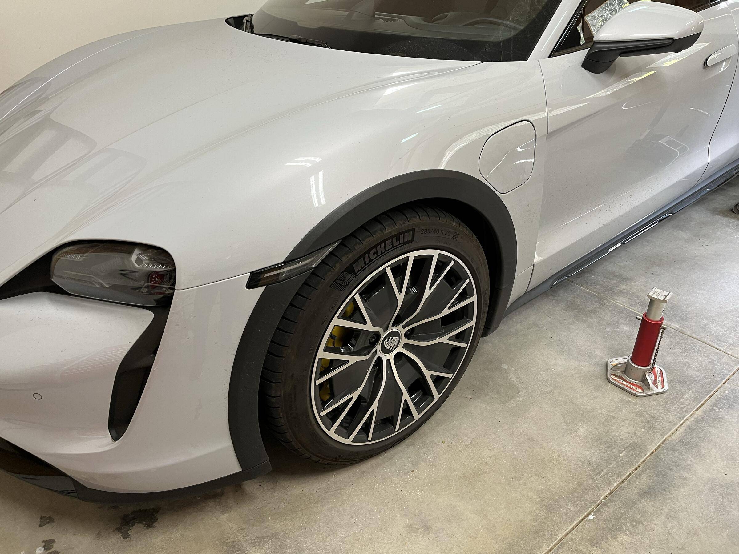

1. Can 20" rear wheels and tires be run on the front for a square setup?
2. How much travel is there in the rear until we hit the bump stops?
1. Like some of you may have noticed, this car tends to understeer when pushed. I prefer a bit more neutral of a car, and one way to do this while also squeezing a bit more cornering oomph out is to run a wider front tire. I'm on the 245/45/20 F - 285/40/20 R setup and was curious to see if a 275-285/40/20 tire would work up front. A little ballpark math guided me toward a ~10mm spacer up front to keep from impacting the strut.
So I tried the above setup - 10mm front spacer, 20" rear wheel mounted up front. Well I'll be damned, it fits and there's still clearance throughout the steering sweep. There is only about 3mm wheel/tire clearance to the strut and the tire pokes out a bit more than I'd like unfortunately, so it's unlikely that I'll run this setup, but dropping .5-1" inch off the wheel width and running a 275 would be a pretty good compromise up front. Steering sweep clearance was min ~5mm up front at full lock (the worst position) and ~15mm in back at full lock (again, the worst position). Some photos below:

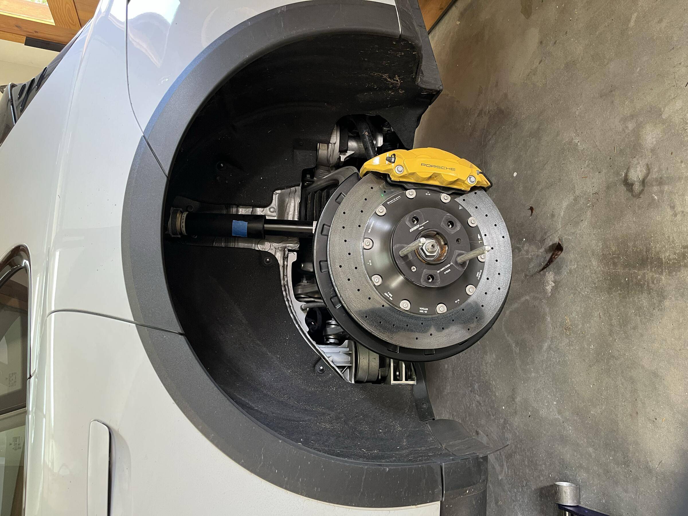

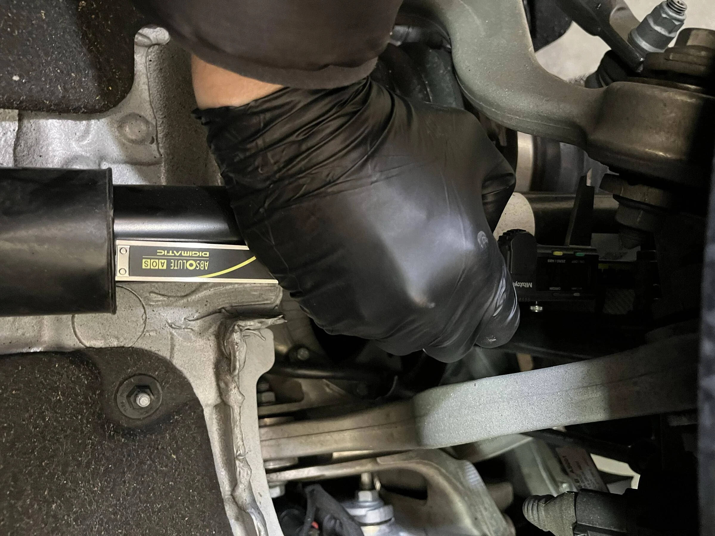

2. Several folks here have talked about lowering their CT with lowering links. I tried this and found that I didn't like the feeling of smashing into the bump stops so I reverted to stock. Several folks debated whether or not the car actually hits the bump stops, and I wanted to put some numbers behind what I had felt. Measuring the front is not trivial, but the back is pretty easy so I started there.
Porsche Taycan Today's suspension and tire experiments tempImages9waEP

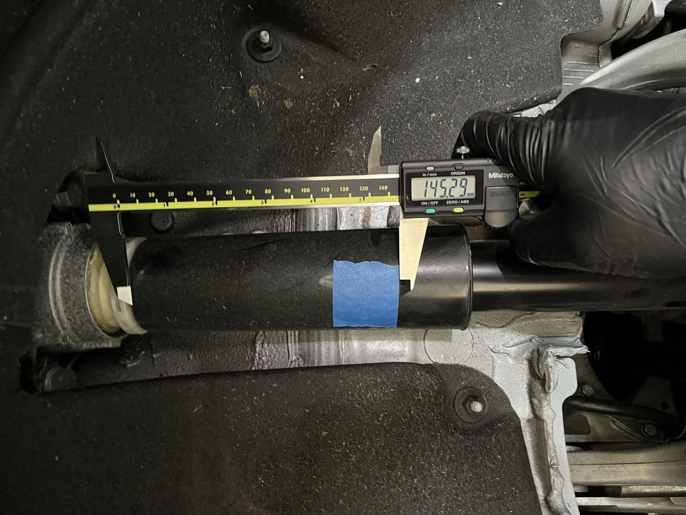

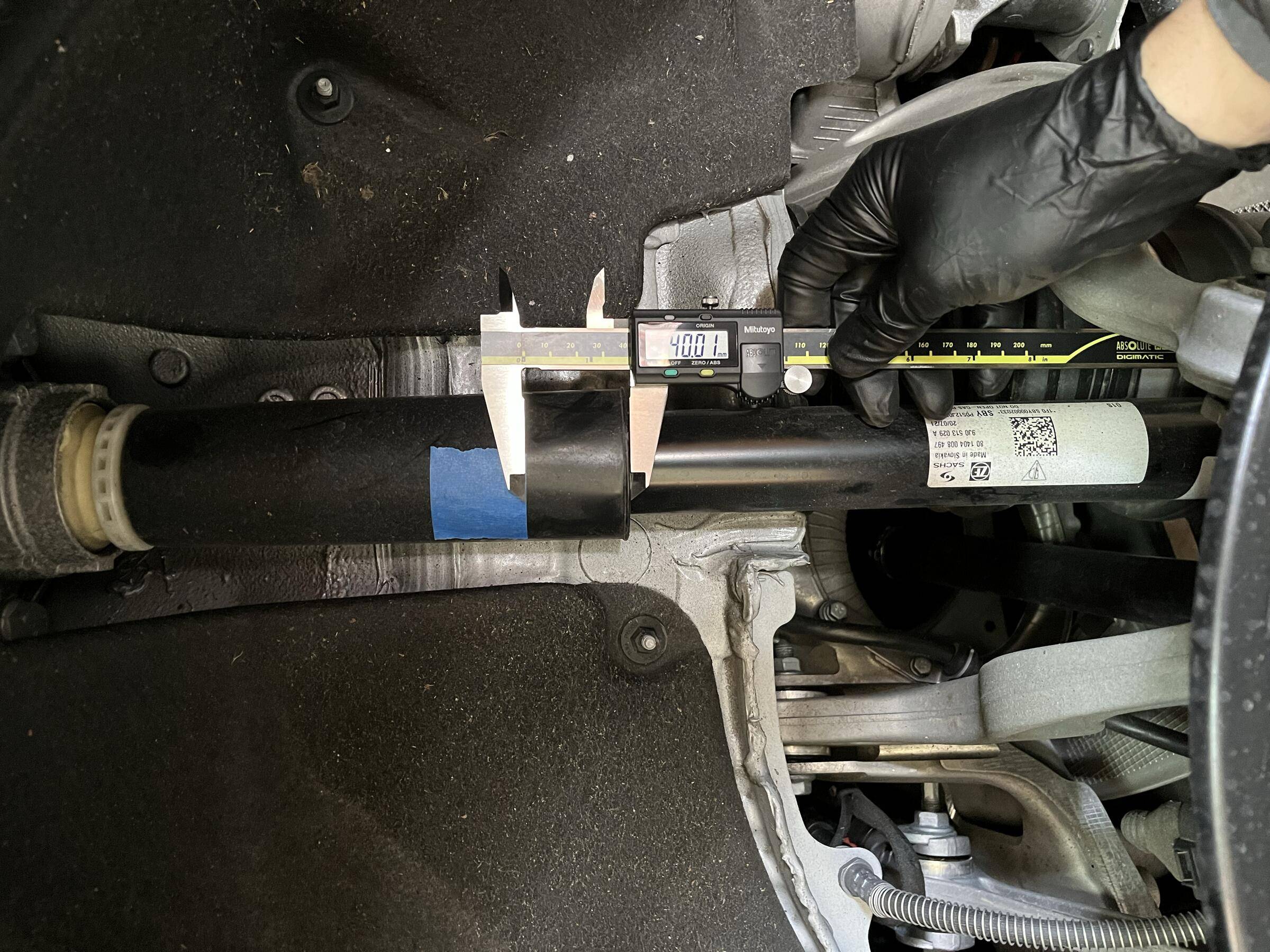

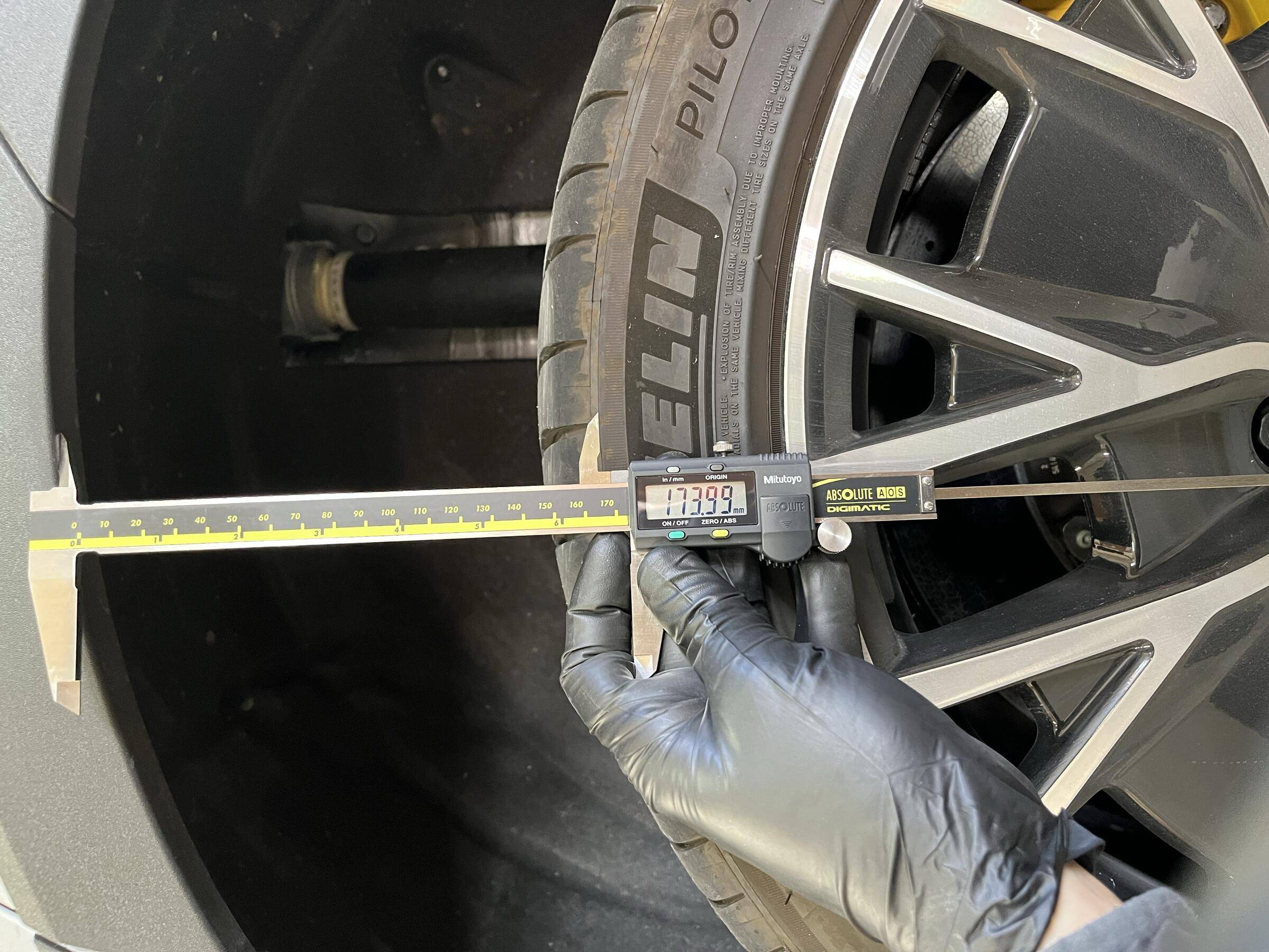

With the wheel drooped, I started by measuring under the dust boot until I hit the top lip of the strut body, then I added a conservative 2mm to this measurement and marked it on the outside with tape:
Porsche Taycan Today's suspension and tire experiments tempImagefickUW
Porsche Taycan Today's suspension and tire experiments tempImageHgv04x
This leaves you with ~145mm of strut travel from full droop until you hit the bump stop, seen in white/yellow at the top of the strut:
Porsche Taycan Today's suspension and tire experiments tempImageEwlyMj

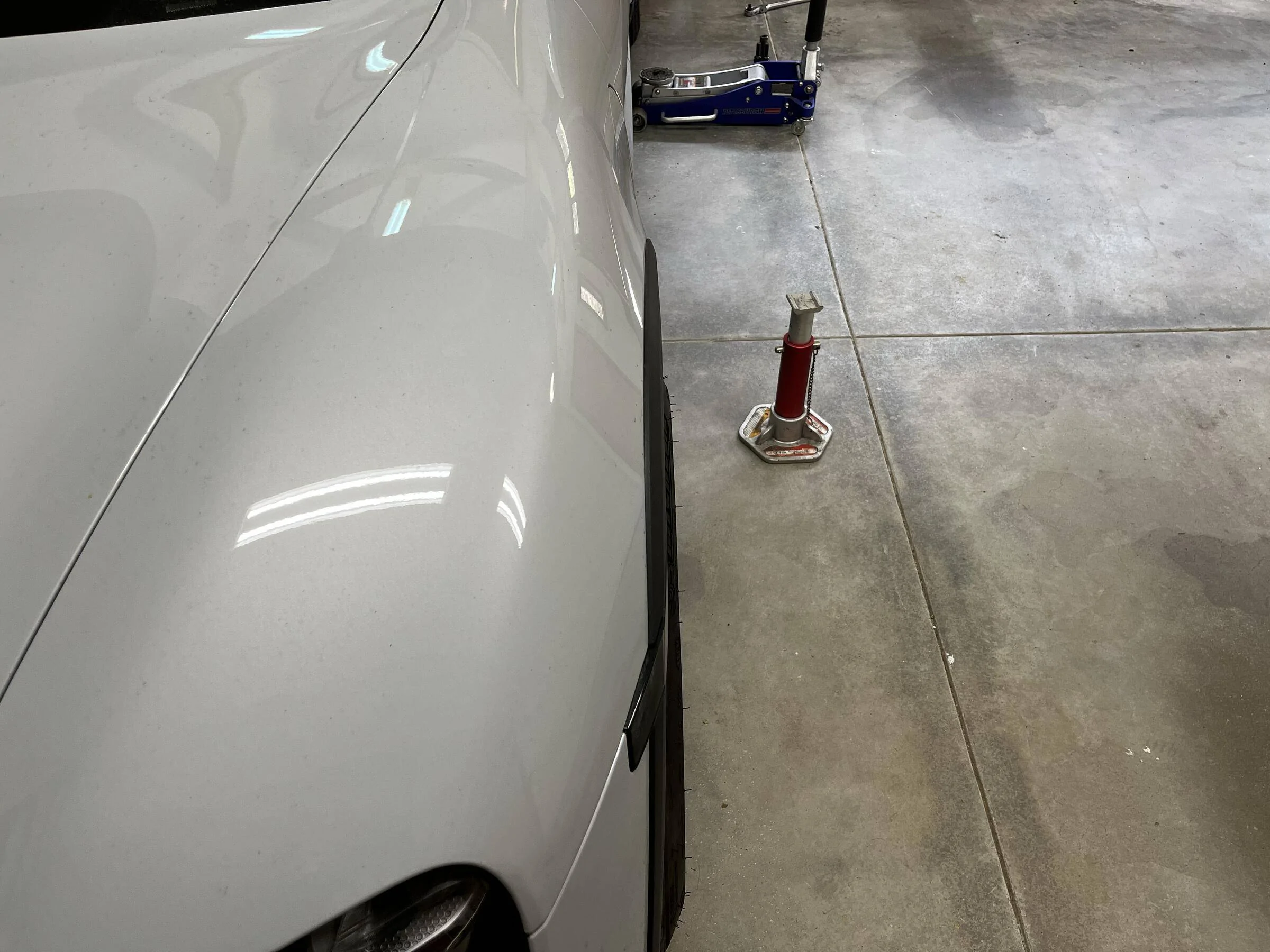

We then want to translate this distance to wheel travel. Since the strut picks up the lower control arm at about 15" and the wheel is about 18", we must multiply 145mm X 18/15 to get 174mm of wheel travel. Then by putting the wheel back on (droop remained unchanged when I did this, FWIW), we can measure from the top of the fender to see how much tire 'tuck' on the fender there is before bottoming out, to get an eyeball reference point:
Porsche Taycan Today's suspension and tire experiments tempImageoBOQKu
What this shows is that there is about 17mm of tire tuck (.67") on the CT before you bottom out the rear suspension.

The understeer is definitely noticeable and a square tire setup makes alot of sense for a 51% rear weight distribution. I can only imagine Porsche decided to downsize the front tires for efficiency and road manners, but who cares.
Was the 3mm clearance in your test to the tire or the wheel? The good thing is that for the laden wheel, that clearance should only get larger with camber compliance. You've got me rethinking my AM wheel spec.

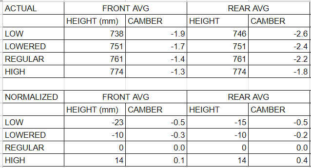

I've also seen many reports of premature rear tire inner edge wear. Have you considered a more balanced alignment to get rid of some of the understeer? I took some camber and ride height measurements and am surprised at how much camber is in the rear. I couldn't find Taycan specific alignment specs but it seems 911s and Panameras alike are similarly spec'd with more rear camber. I plan to take out 1-1.5degs in the rear to help with balance and wear.
Porsche Taycan Today's suspension and tire experiments 1647320820828
Note, measurements are with 20mm drop via lowering links. Height measured ground to fender edge.

Thanks for the data! Rear camber looks alright to me based on similar mass vehicles, I just wish I could dial a bit more in front.
The 3mm clearance is actually about the same to wheel and tire due to the built in rim protection of the PS4 tire and the shape of the suspension upright.
275/40/20 and 245/45/20 are almost the same diameter, so I think that 275/285 really is a prime pairing here.
