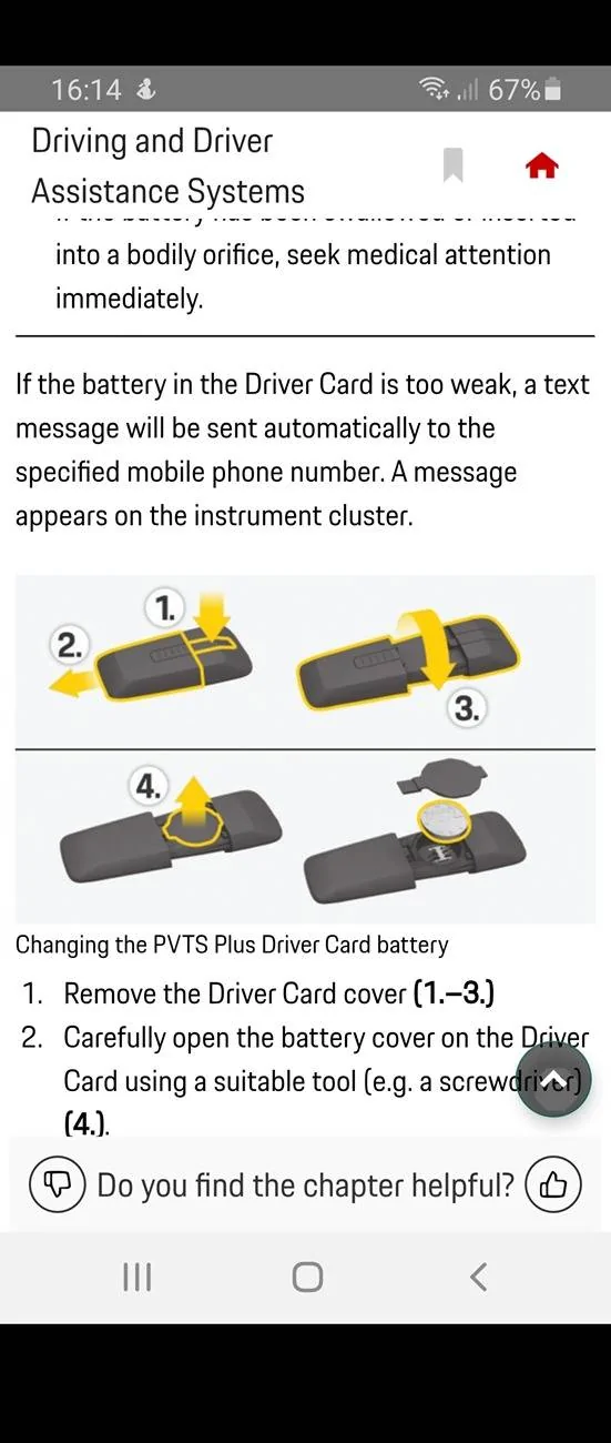

Message flashed up tonight, 'driver card battery low' (or words to that effect).
Presuming this is the battery inside the PVTS (Vodafone) fob, rather than the car key (which I replaced both sets of batteries around 6 months ago).
So any ideas how to crack open the rectangular wedge-shaped PVTS fob? It's not immediately obvious...

It just slides apart in two halves. Apply a little pressure top and bottom in the centre and then slide.
Thanks I was trying everything (except actually reading the manual ?) to get them opened. Now I have the knack.
Incidentally I tested the CR2032 button cell in a coin cell tester I've got and it reported 60% life (on each coin cell respectively) and both reported 2.46v loaded (can't just test them o/c with a DMM)
The dash message reported that as "empty". Oh well they almost got 2.5 years.
