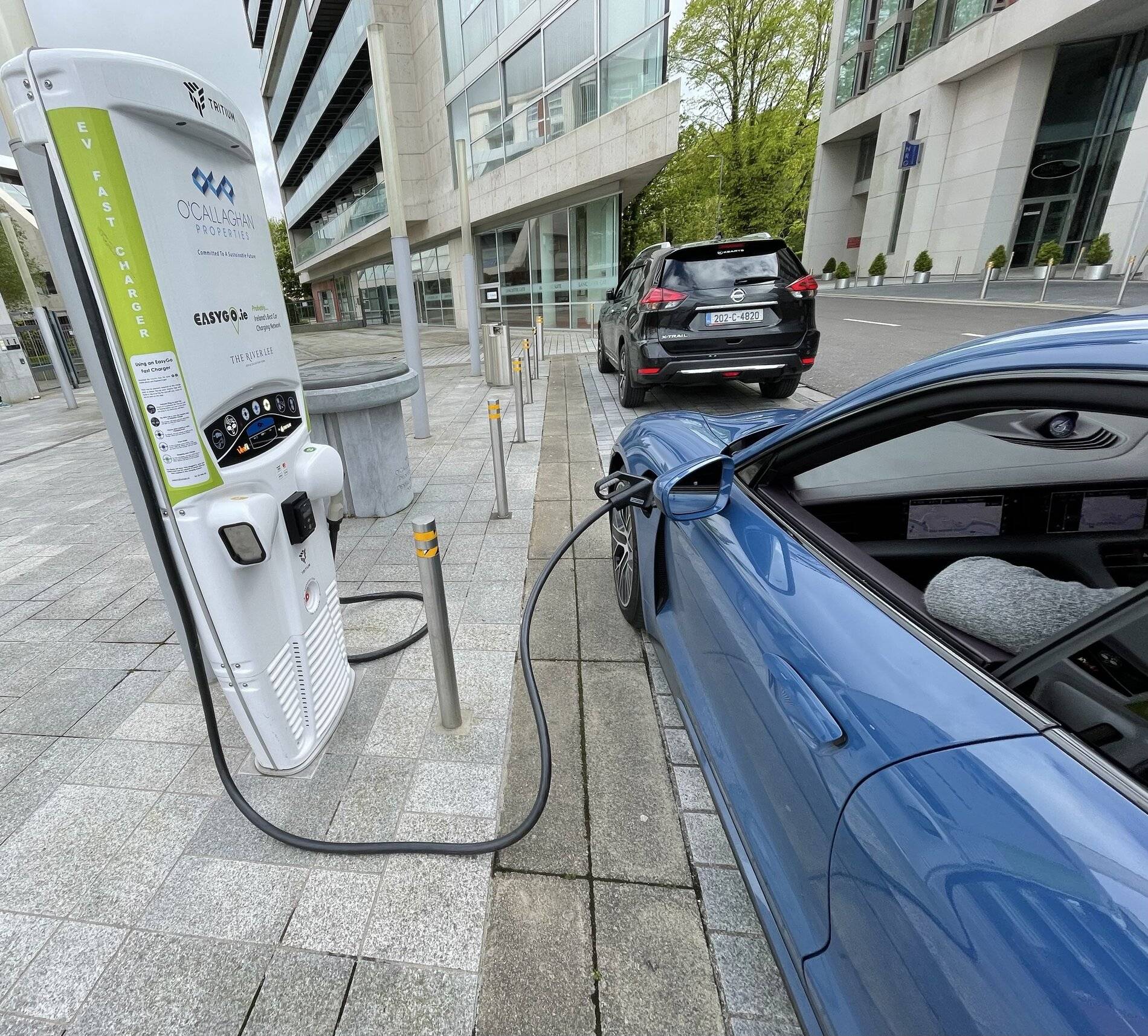

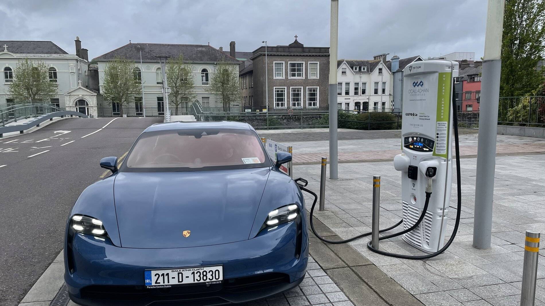

Many times here in Ireland. Never an issue.

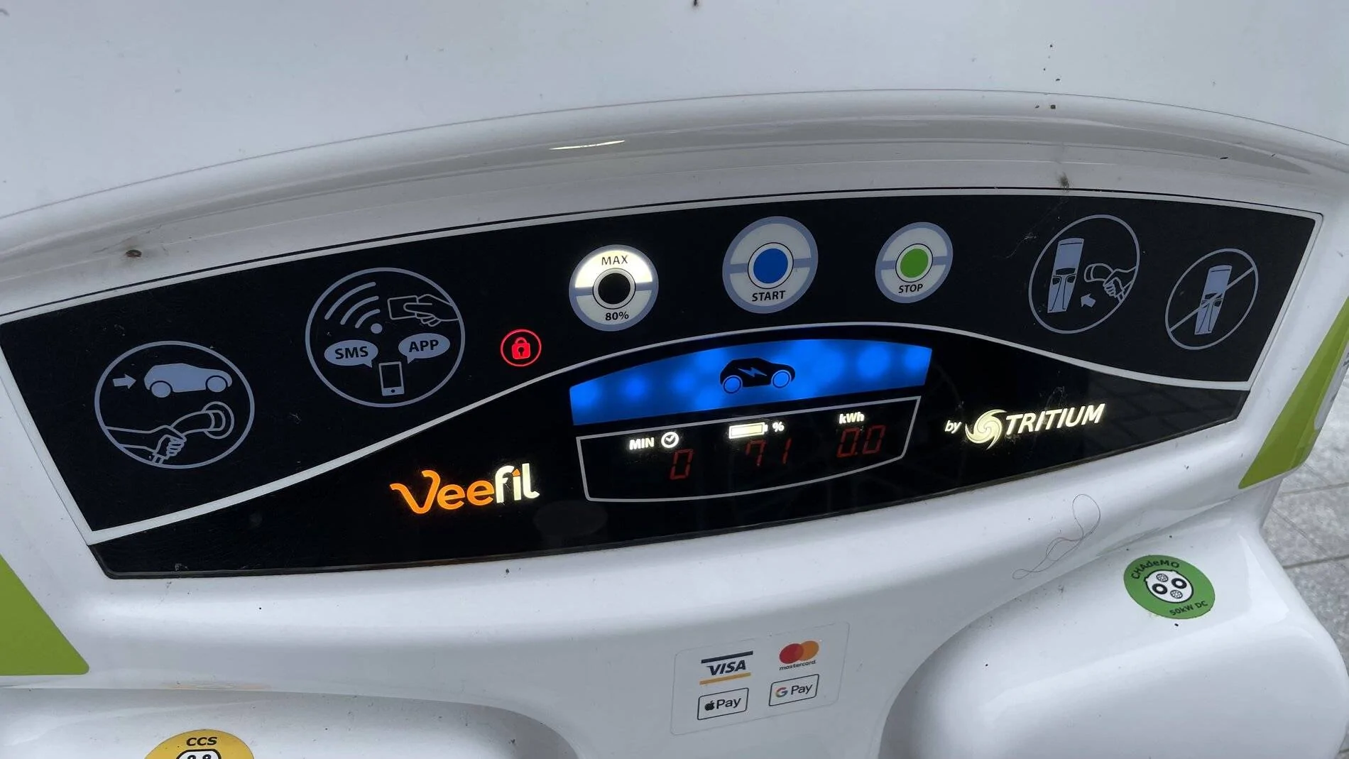

To start charge:
  1. Plug in car.
  2. Tap my fob against the second circle (I have one from this Irish charger company – EasyGo).
  3. Decide to fill to max or 80% by pressing the black button – 80% default.
  4. Press blue start button.
To end charge:
  1. Tap fob against the second circle to unlock access to the charger.
  2. Press the green stop button.
  3. Unplug from car and place into charger holder.

Thanks. The issue I am seeing is that the start button never lights up. I am thinking of making a dedicated trip to a charger nearby during the week when I might be able to get through to the support line. Perhaps then I can debug this process. On PlugShare I have seen others complaining about being able to get charging started.
