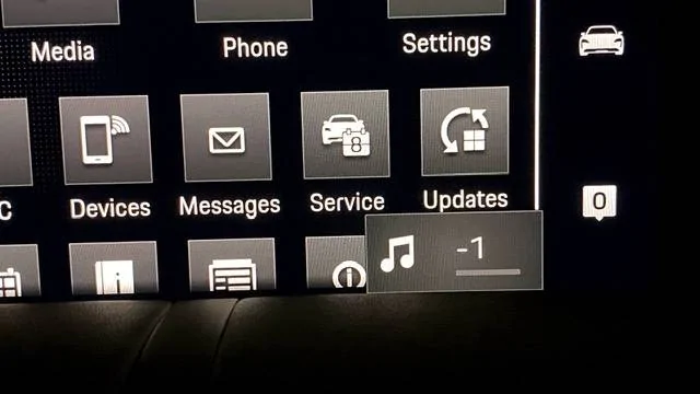

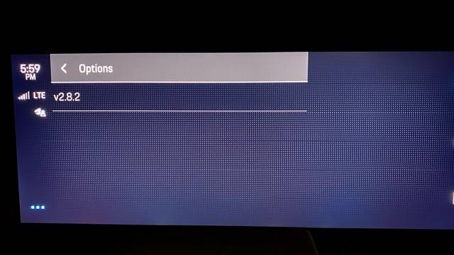

Anyone had any experience of their car volume control failing to work or indeed show -1.
Screenshot below and current PCM version
It seems to correct itself after a while but can’t figure out what’s causing it.

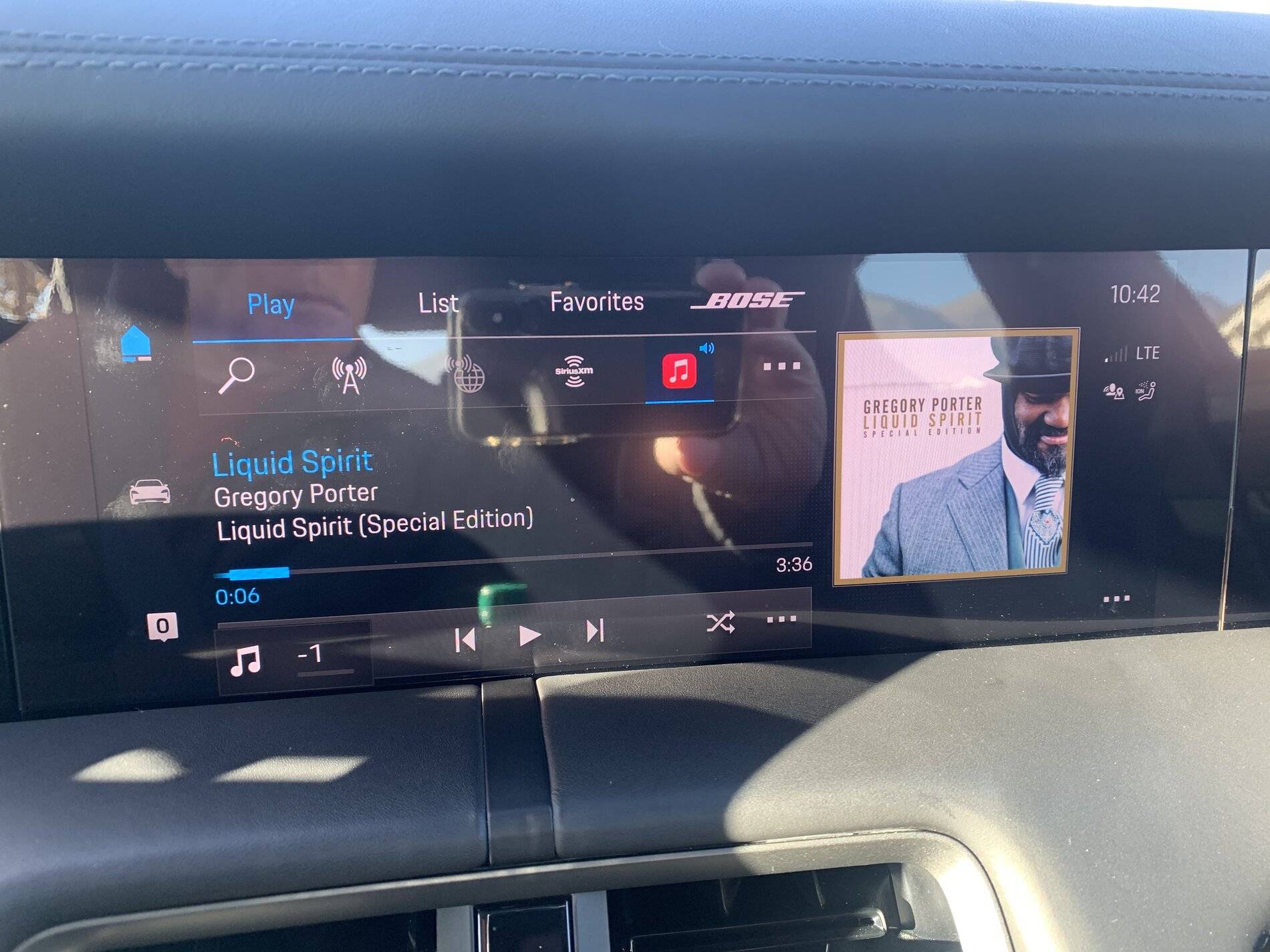

It happened to me last week. I turned the car off locked it manually with the key fob came back in 15 minutes it was resolved or reset.
I believe two other people had the same thing occur on the same day I did last week.
Has not occurred again.
Good taste in Music - Gregory Porter ?

Yes, I have had that happen too. Goes away after a restart. Interestingly though, the volume was fully controllable via the steering wheel knob.
I was not able to control volume with the volume wheel on the steering wheel or the center consul. Nothing would move it from -1.
Being a computer the reset seemed to work well. Learned it from other people on the forum. Thank you.

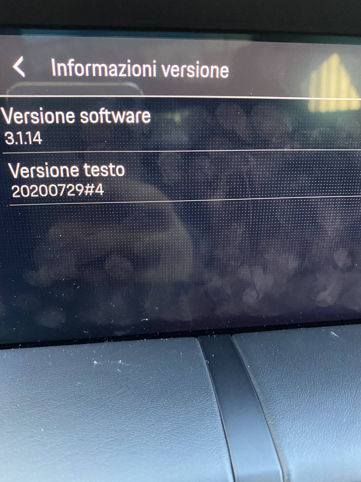

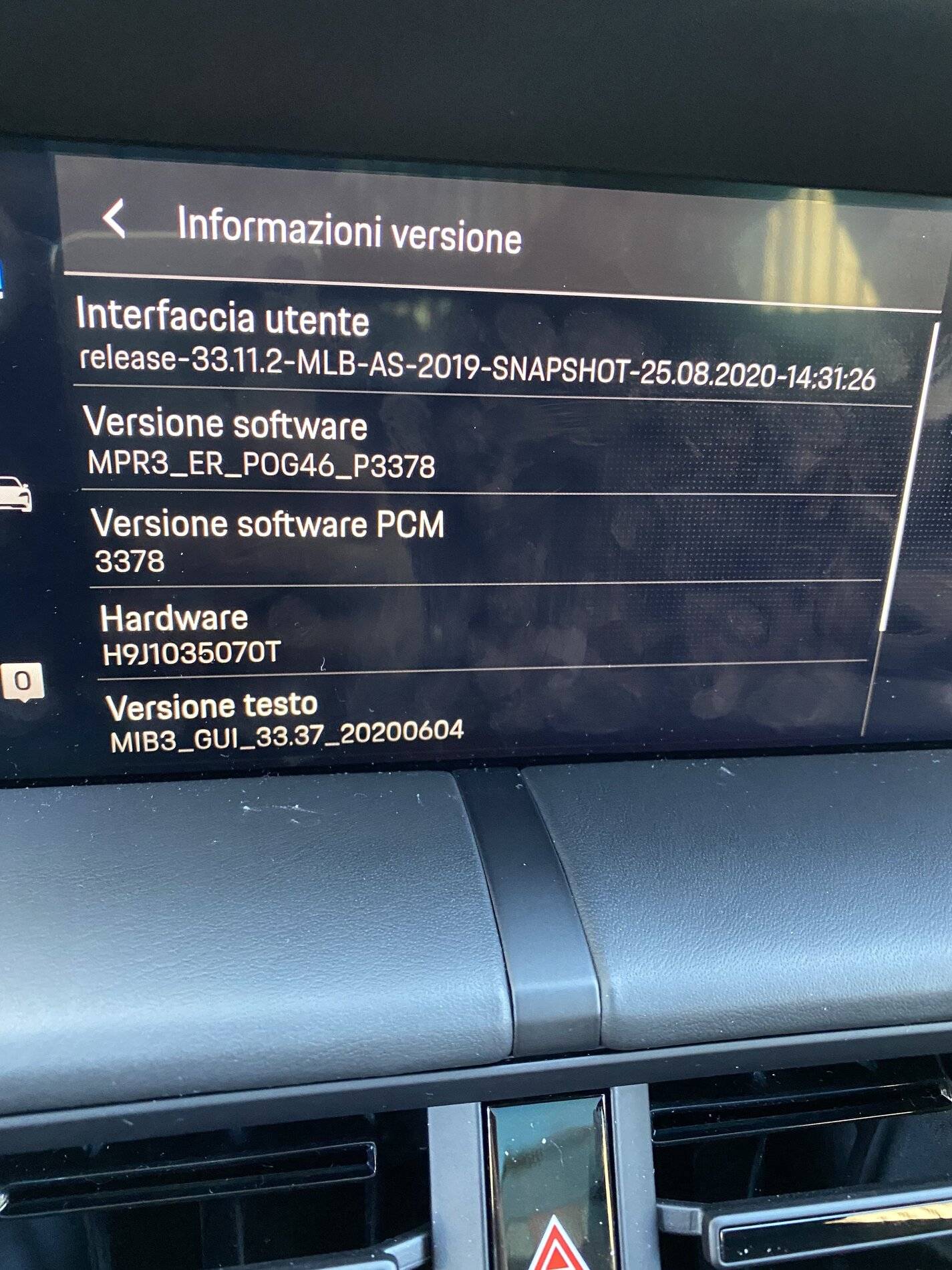

how did you get this software information?
i have this information about software and hardware versions

@MrJack , my screen shot was from the info screen and then hitting the .. in the lower corner.
where is your screenshot from?
Mine is from setup and after into system, tomorrow i will check if it’s true...
From ... into info i have other info but i don’t think this is pcm software version
