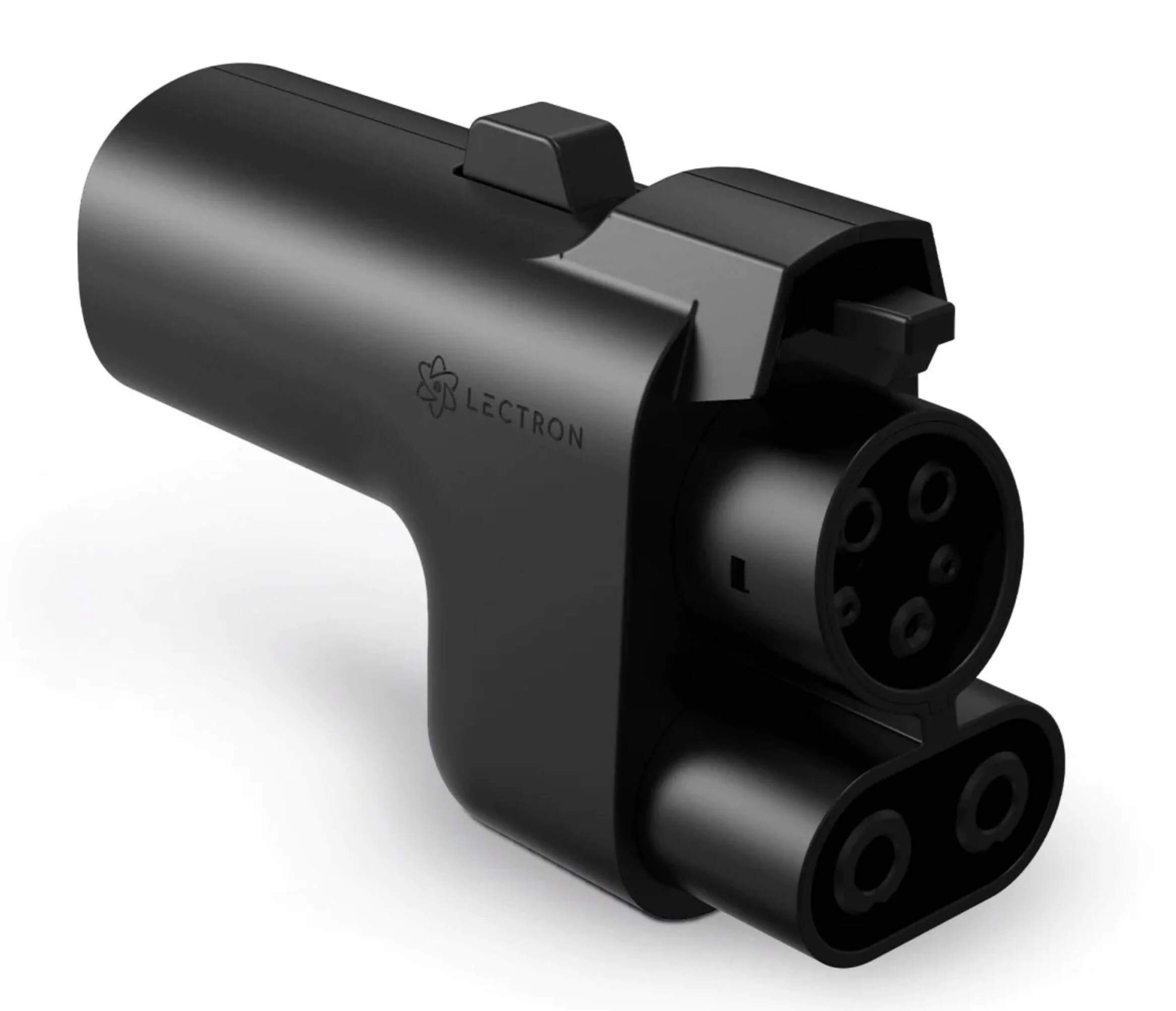

Has anyone seen the equipment that Porsche recommends we use to access these super chargers?
Not a single non-Tesla auto maker has released any hardware, nor any photos of hardware, that I'm aware of... as of yet. It seems likely that Ford (the first to announce the NACS adoption) will be first to market with any sort of adapter. Tesla employees even said so by accidentally leaking this data recently during a zoning meeting in Utah -- see here:
https://insideevs.com/news/701484/ford-gm-evs-tesla-supercharger-access-february-2024/
EDIT -- as noted by snstevens above -- any adapters will potentially look like that Lectron unit. But it is up to each auto maker to release hardware and such. And then Tesla also needs to figure out how he software works there -- so a lot to still come b4 we can use Tesla chargers (save for those few MagicDock locations, which can be used as of today)
as noted it will have to be similar in nature to if not exactly like this unit - the adapters will unlikely to be vendor specific with all the charging activation being handled by software - and the adatper just being a physical device with limited "active" electronics - there are only 5 "wires" (2 high voltage DC connectors, 2 low voltage communications connectors, 1 electrical ground - NACS and CCS1 both share a 5 wire design - with the 5 wires all having indentical purpose) that must be bridged from one side to the other - it will operate in a similar nature to the TeslaTap for AC charging.
https://ev-lectron.com/products/lec...MIgIb-7qqegwMVxkp_AB3HvAinEAQYASABEgKbhfD_BwE
Porsche Taycan VW Group (Porsche, Audi, Scout) Commits to NACS Screenshot 2024-01-08 at 11.14.56 AM

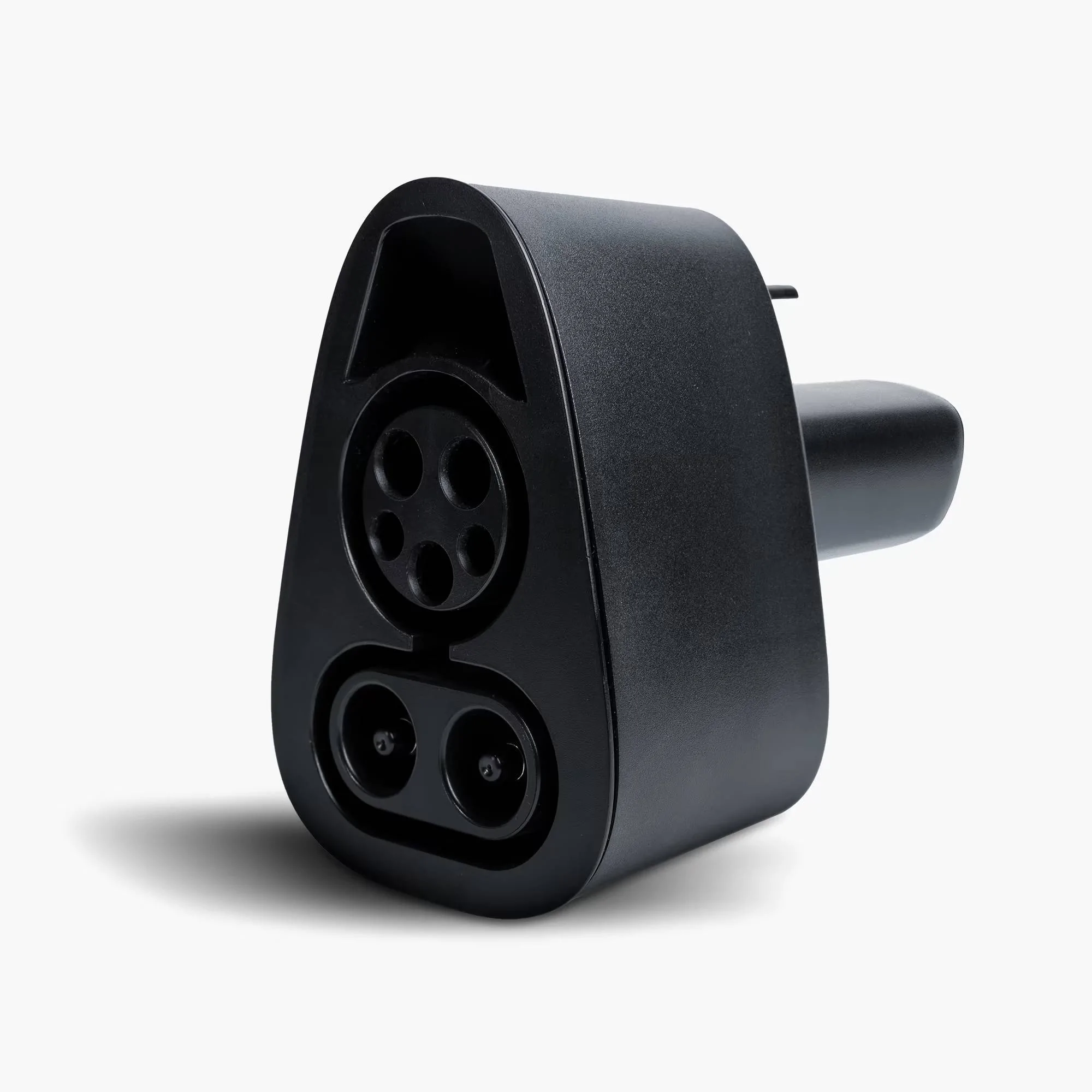

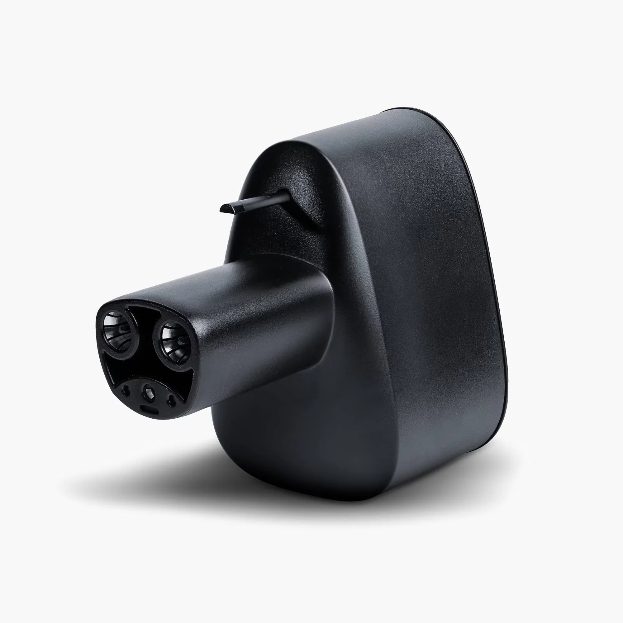

its the "reverse" of this adapter that Tesla Owner's use to access CCS1 chargers…see pics below from the TeslaSite…
Porsche Taycan VW Group (Porsche, Audi, Scout) Commits to NACS 1656565-00-A_5_2000
Porsche Taycan VW Group (Porsche, Audi, Scout) Commits to NACS 1656565-00-A_4_2000
