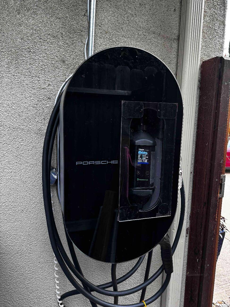

slothinker
Todd
Mar 31, 2022
472
246
San Luis Obispo, CA
Taycan RWD, Toyota MR2, Ioniq6
I have the Porsche Wall Charger Connect charging station mounted on the side of my house and so was looking for a replacement charger which would fit inside the box and, of course, plug into to the 240V outlet within. The only product I could find that looked viable and had a 40A rating was the PrimeCom 40AMP portable charger. It comes with cords up to 50'; I went with the minimum 30'. Bought directly from David at PrimeComTech in Costa Mesa, CA.
https://www.primecom.tech/collectio...s/40-48-amp-ev-charger-220-volt-30-40-50-feet
Good news is that the unit did easily fit inside the box. I mounted it using a couple of zip ties and then covered the oval port hole (which the recalled Porsche charger had filled) with a 14"x7" piece of plexiglass held in place by magnetic strips (see photo).
I'd like to report how the unit works at 40A but the Taycan has been at the dealer's for the last week getting the mandatory HVHeater replacement. If I have a problem or issues with the PrimeCom, I'll certainly report it. (Basically Amazon reviews are quite good; 12 month warranty is far from ideal but I used a credit card that gave me an additional 12 months.)
