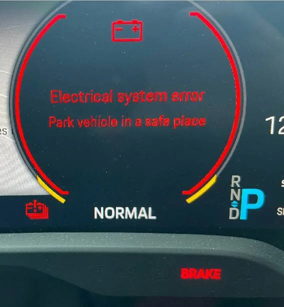

Week 2 : Electrical System Fault- park safely
Leverage
Sep 28, 2022
235
172
Taycan 4S Cross Turismo
whelp...mine just bricked with the same error. Its on its way to Porsche (which of course is 2 months out for a loaner).

The car was literally dead. Turns on...gives the red electrical fault note in the cluster and by definition 'bricked'...goes into neutral for towing and that's it. I called Porsche North America because its my daily and explained the dealership was 2 months out on loaners and they said a long drawn out 'sorry, there is nothing I can do'. I asked about loaner reimbursement and they said its case by case and not done until the expense is incurred which didn't give me a bunch of confidence.
I've had several new Porsches and actually have a GT3RS allocation deposit in place. Living in California puts a lot of power in the consumer for lemon law should this thing take weeks to solve. They are 'supposed' to be doing a diag tomorrow or Tuesday, but the dealership is loose on their promises for service timing.
I'm trying to remain optimistic, but the brand is really not acting how one would expect in response to a $200K car failing with just over 12K miles on it.
Hi Skilly I just got my car back after 2 weeks in the garage. Hurrah!! It bricked after only 2 weeks and 500 miles of ownership so I’m keeping my fingers crossed it’s all good now. Bizarrely it was much quicker than I expected (electric cars reliability is so bad that 2 weeks is good?!) It needed a new High Voltage Charger and 2 software updates to fix the other warnings and the excessive travel on the break pedal. The service engineer indicated that the reason it took 2 weeks is that the HV charger is failing on so many cars and they have no stock so had to get it from Germany. I hope yours is as straightforward.
It’s disappointing that Porsche have not apologised at any point for the car breaking down in the first 2 weeks, I can only assume it’s a sellers market and they don’t really care less.

I went through this in the 2nd week of December. They replaced the charge controller (were able to get the part in three days and needed 1 day to install it. Car was gone for exactly 1 week.
Been problem free since then. I have about 24.000 km on it.
I think the part delivery for my T was delayed by the Christmas holiday, and the repair took longer due to the other warnings on the dash that needed software update. I hope the new part is not the same type as the one it replaced…
