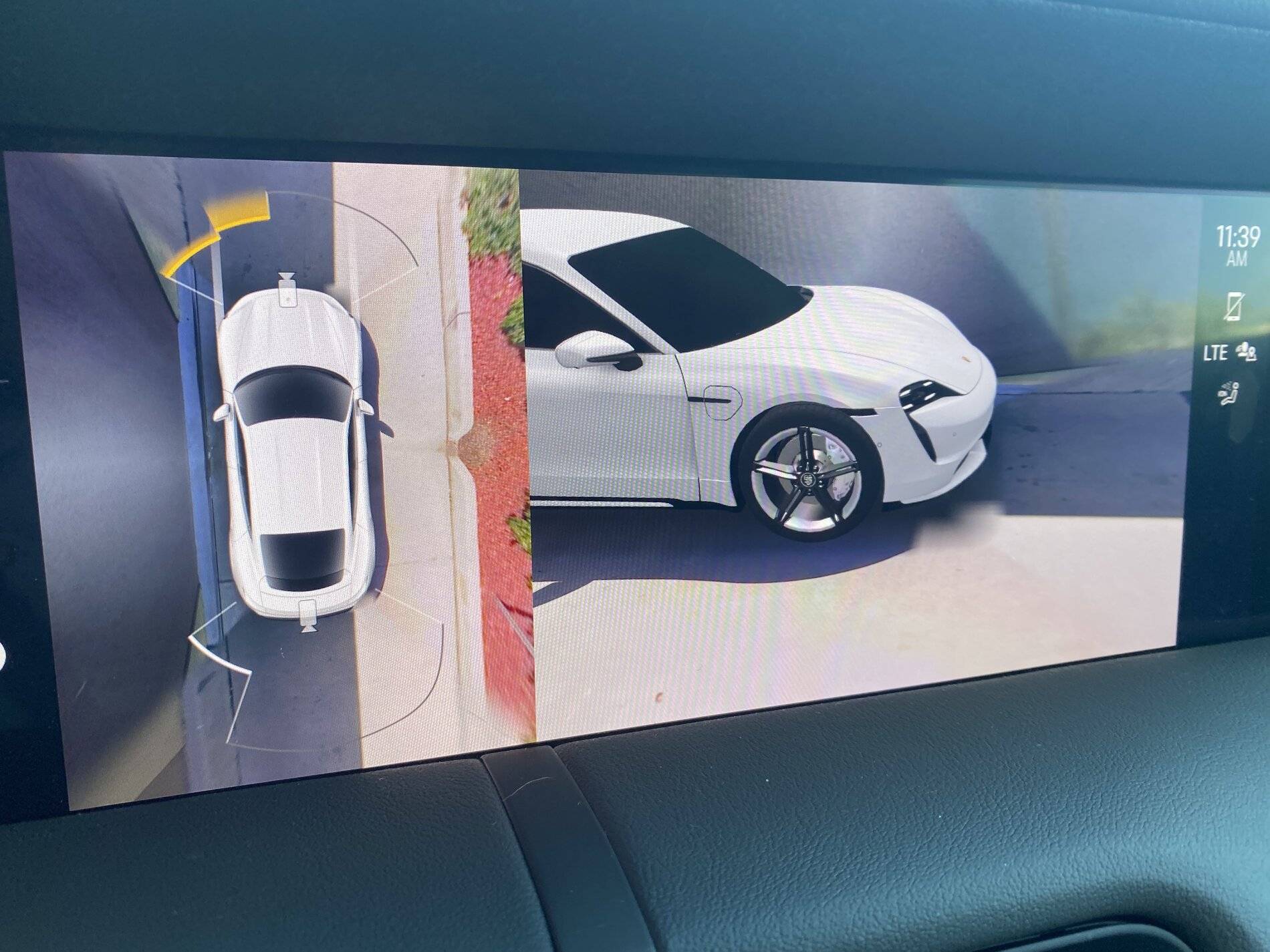

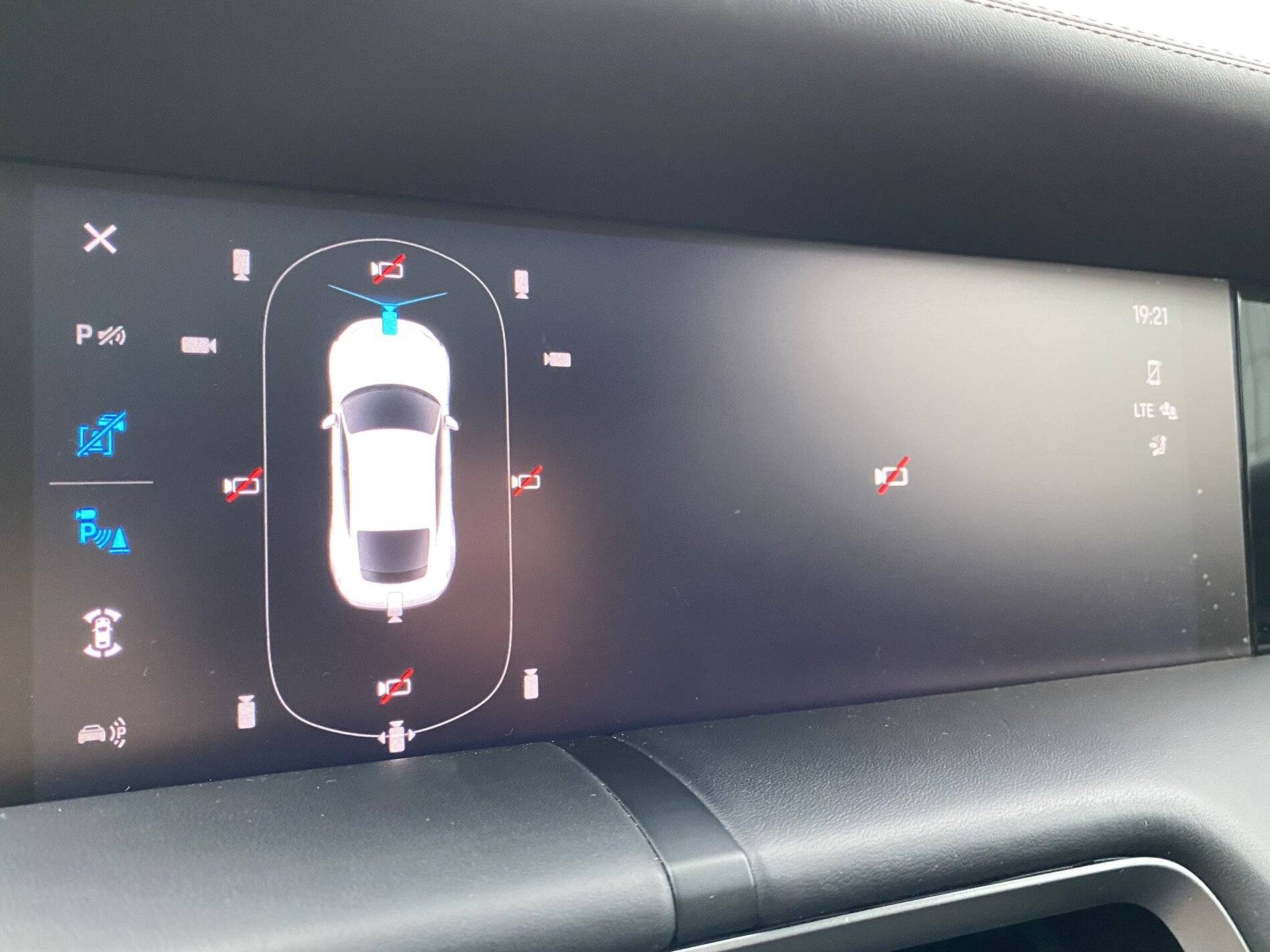

Ok, just played with. I was able to get consistently. Advice with picture showing the cameras is excellent.
1- Have park assist active and on that selection
2- Start at back or front where camera orange
3- swipe to viewpoint supposed to be
4- LISTEN for CLICK or vibration
5- press touch screen
view will change and can scroll through. Thought I had this option but really just surround so glad to have via hack but would gladly pay if they made FOD since hardware obviously there...

Keep going and you can get the full 3D 360 view which you can the spin around on the PCM screen.

Haven't been able to "spin" but can click from camera to camera....Must not be doing correctly on spin...

If you start with the bottom camera orange, swipe down, the click, it will go to the mode to allow you to spin.

Yes I have gotten good at it. Really only find it helpful when my wife runs into a store and I am playing around with it.
Also discovered how to simply swipe, I was trying to swipe on bottom screen and need to swipe left or right on top screen with 3d image of car.

I can tell you now that this works on my MY21 turbo. Go into parking mode. Click past the from or rear camera, then click on the touchpad in the centre and you can cycle through the views. Or swipe down on the touchpad and the main part of the PCM screen has an orange border around it then you can use that screen to pan round. I only have surround, not 3D but this gives you all the 3D you need.
