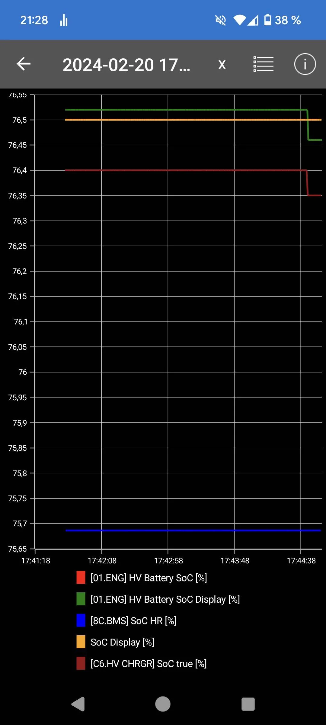

I took a snapshot earlier today: SoC true is almost identical to SoC Display 🧐
How is this possible ?

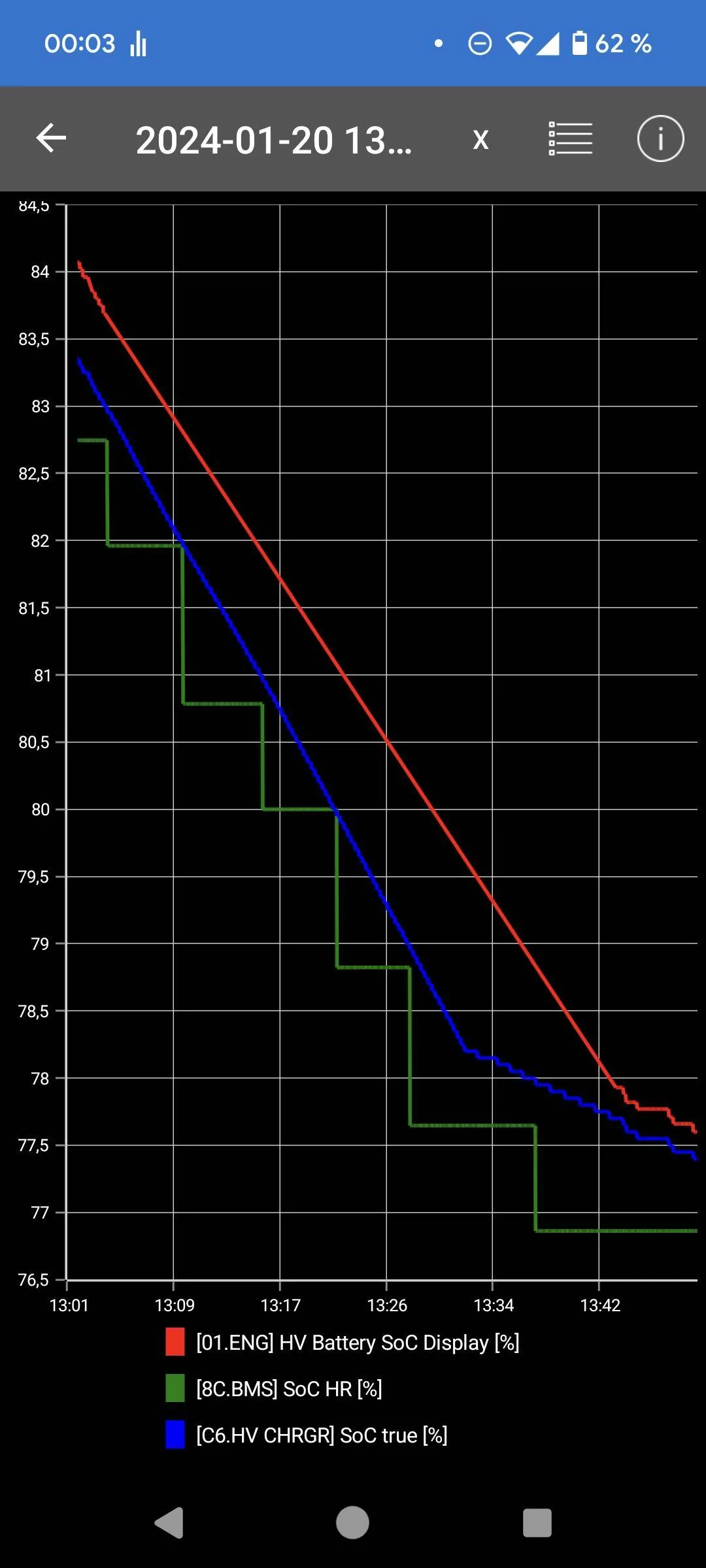

It’s a fundamental property of Euclidean geometry:
two non parallel lines always cross once :)
example crossing a bit earlier.
Porsche Taycan What are your highest charging amounts? (Hall of Energy) 1708463729869
discharge your battery and you will see the biggest deviation.

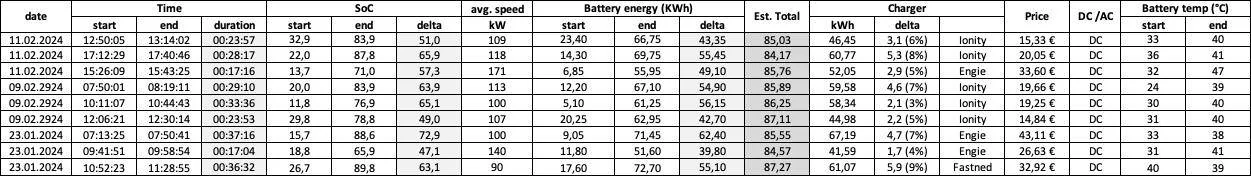

one more line, slow AC charging: more than 20% losses here
sadly true, slow charing reducing efficiency mostly because at least BMS and Charger ECUs cannot go to sleep for 9,5h (like 9,5h * 200W est. ~2kWh alone) and DC converting is less efficient if less than 16A per phase.
3,090
2,690
no need for the pictures, only SoC delta, time and DC energy charged. start and end temp would also be nice and make it more accurate.
For DC you only see (and pay) the energy without AC converting losses. Therefore it should be more precise.

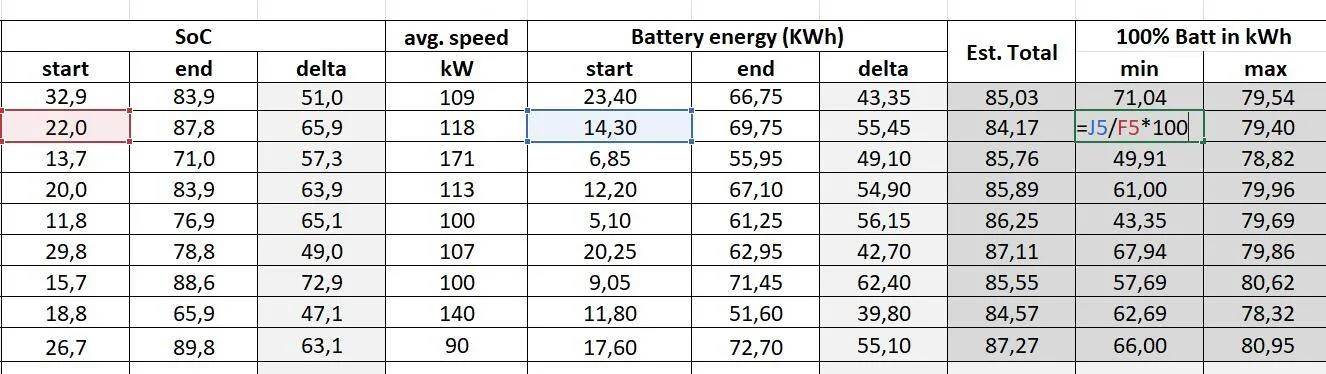

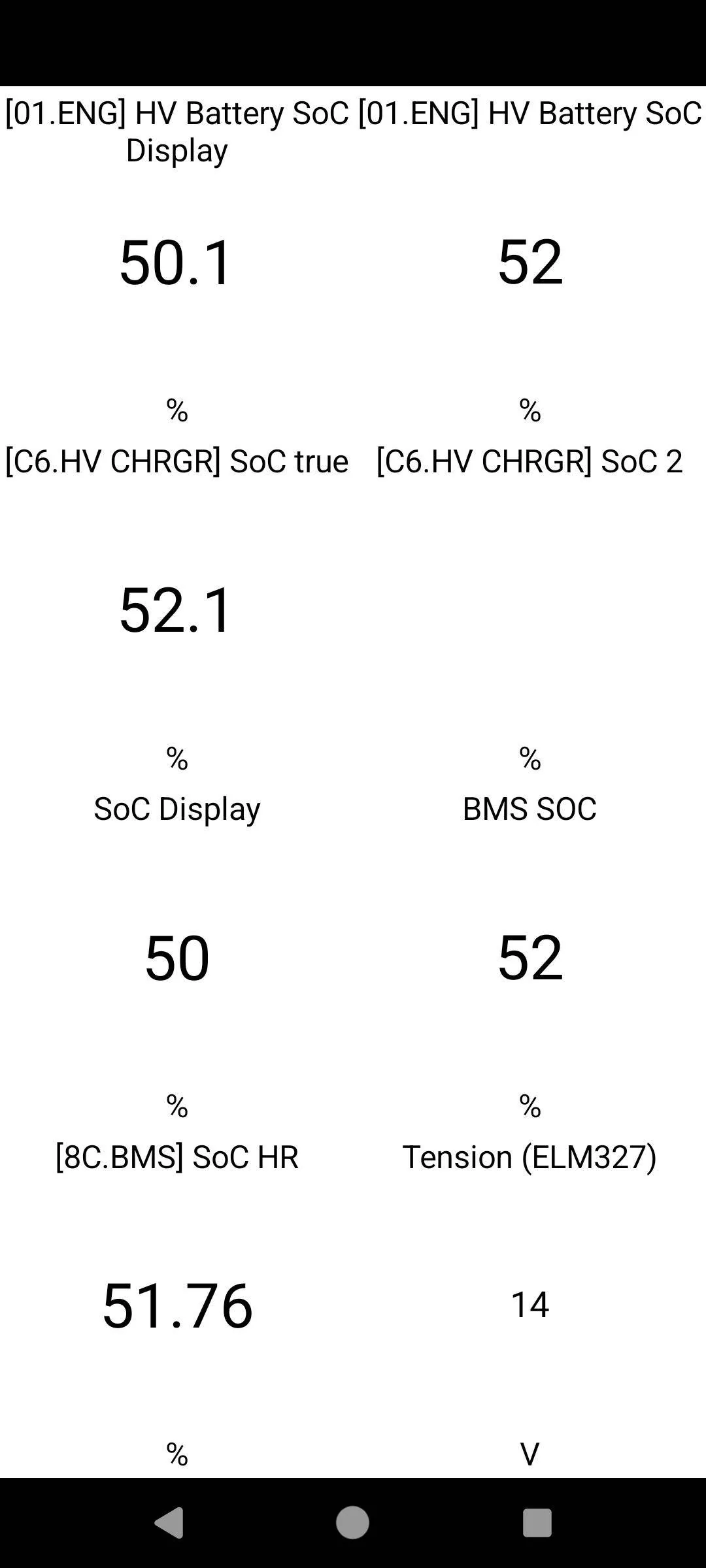

SoC true = gross (93,x kWh)
Soc Display = net (86,7 kWh real, 83 communicated)
only these 2 are of interest.
use net to compare against DC charging kWh
[01.ENG] HV Battery SoC Display is the right parameter to follow then for net: you get a value with 2 decimals.
Yep I calculated similar numbers before shared in the SoH thread (but suspect quite variable for other reasons) - will try to add data here too but TBH my charging totally dominated by AC - now have an excuse to get more DC :)!

one new line with a 22kW charger :
Porsche Taycan What are your highest charging amounts? (Hall of Energy) Screenshot 2024-02-29 at 20.28.48
