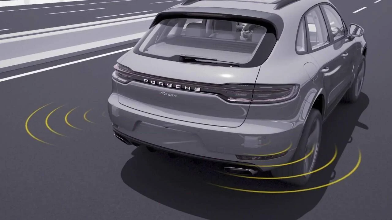

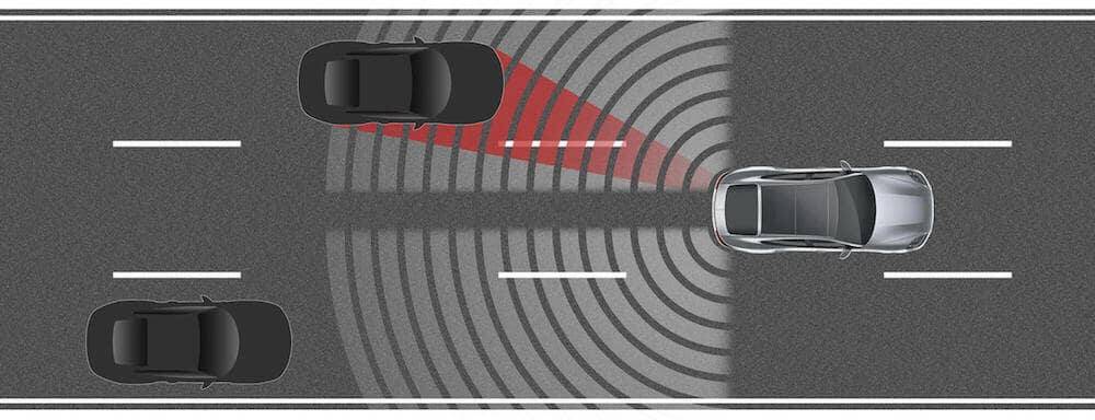

The sensors are the same as lane change assist uses – and are roughly on the rear quarters behind the body panels.
Porsche Taycan Which sensors may cause "Egress Warner not available" error? 1710133006702
Porsche Taycan Which sensors may cause "Egress Warner not available" error? 1710133037534
(can't find a Taycan specific image)
