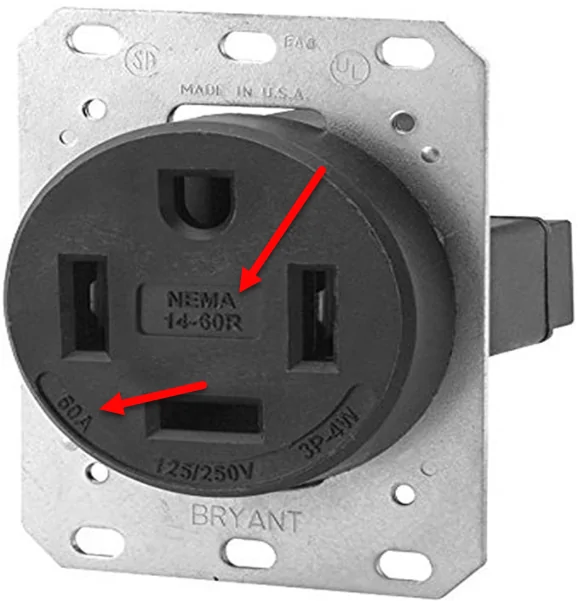

Fyi, there are NEMA 14-60 plugs too, from which you can draw 48A continuous.
Porsche Taycan Why does one need a wall charger vs just a cable. 1630402692804
https://www.amazon.com/Bryant-Electric-9460FR-Straight-Receptacle/dp/B003A19LPQ
I think that depends on where. In some places the GFCI is required only below a certain height.

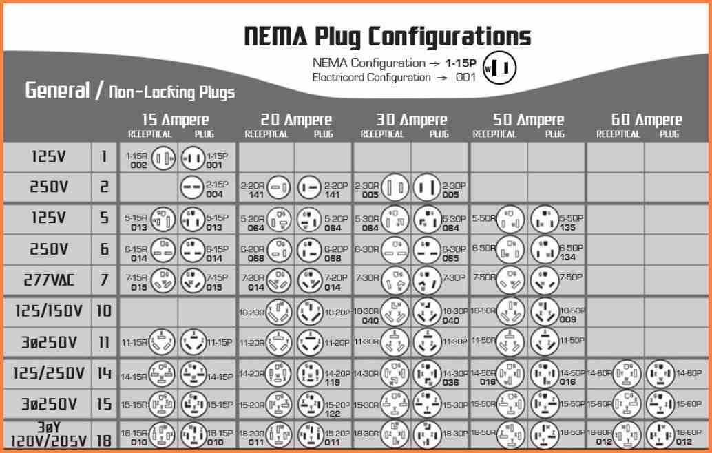

that’s for 3-phase AC power if you read the specification closely.
not saying you couldn’t run residential power through a plug like that - but when I was researching it they are industrial plugs meant for industrial 3-phase power equipment - to date no North American EVSE’s have adopted a NEMA 14-60 or NEMA 15-60 plug type- there has got to be a reason.
I have never used it myself, but from what I read 15-60 if for 3-phase, 14-60 is for single phase (or split phase). While no EV charger ships with one, I should be able to get a charger like the OpenEVSE one and fit it with a 60A cable with NEMA 14-60 plug, then install a NEMA 15-60 wall receptacle.
