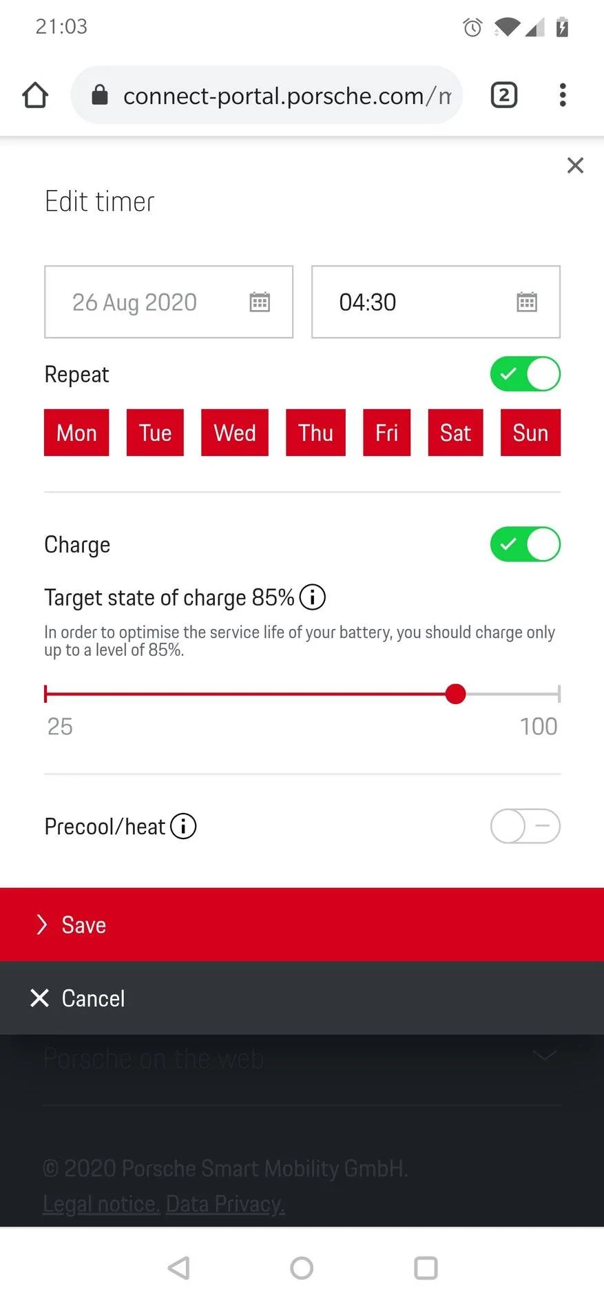

I tried to limit my charge last night to 85%. It went to 85% and paused. When I got in the car this morning it was at 100%. I thought I had used a profile that I had set up that called for a maximum charge of 85% and charging to take place between 10pm and 7am. It started charging at around 8:30pm. If anyone has a simple solution, I’d love to hear it. If not, I’ll call Porsche (they helped me yesterday when I couldn't connect to the Porsche server)...
Or are you maybe just using a profile setting charge. You cannot set a maximum with this. The % you set is the minimum target that you want it to charge to immediately and then it will resume charging again if you also set times.
In order to set a maximum charge you need to set a timer charge.
Sorry to be uninformed, but how do I set a timer charge? Do I do that on the phone, in the car or on the charger? Thanks in advance for helping the helpless!!!
Either in the car or on the phone. You set the time that you want the car to be ready and charged to the target state of charge.
