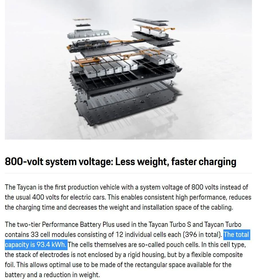

Straight from the horse's mouth.... But feel free to believe Porsche actually puts much larger battery packs without advertising to allow for the mythical large buffer at the top
There are actually fairly detailed specs floating around out there. In particular, see the Jalopnik piece here:
https://jalopnik.com/an-extremely-detailed-look-at-the-porsche-taycans-engin-1837802533
Where it mentions
The Taycan’s battery pack consists of 33 cell modules, each of which contains 12 individual 64.6 amp-hour LG pouch cells. They are arranged such that half of the cells, 198, are in parallel with the other half. The big number that’s been thrown around for years now is “800,” as it’s a rather high system voltage for an EV.
In the case of the Taycan, the actual voltage sits somewhere between 610 (depleted) and 835 volts (when full), with a nominal voltage of 723 volts. Maximum energy content is 93.4 kWh, which is a bit less than the Tesla Model S at 100 kWh.
This would seem to suggest that the gross capacity is pretty close to what they say if you do the math:
Since the pack is a 198S 2P configuration, simply take the following:
Multiply cell Amp-hour rating by 2 to get the total Amp-hour figure:
64.6 Ah * 2= 129.2 Ah
multiply by the 723V nominal pack voltage to get the Watt-hour figure:
129.2Ah * 723V = 93.4116 kWh
Sounds pretty close to me.
And that means that the cell voltage is a range of 3.08V (empty) to 4.16V (full), nominally 3.65V. Which sounds like a fairly good modern Lithium Ion cell, but nothing exotic.

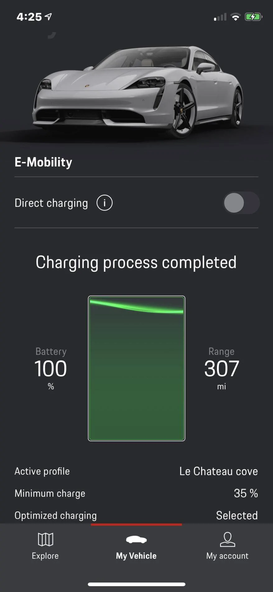

Totally agree. I'd prefer to charge to 100% as well. And I do plan on charging every day. I want to make it a habit after I park in my garage to plug in the charger, otherwise I'm afraid I might forget to plug it in when I should. Isn't there a buffer (as mentioned above) that keeps you from charging to such a high level that you'd harm the battery?
I am a bit confused. First leaving the car at full charge extended periods of time will cause more degradation than not, but how much depends on conditions.
Second it is easy enough to plug in always AND not go to 100%. Just set the general profile to a minimum charge of say 85%. Then just come home and plug in. The car will charge to 85% and stop. Unless you need the full range for some reason why charge to 100%? What is the advantage.
Batteries are primarily “aged” by full charge cycles (that is total charge from 0 to 100, whether it is done in the middle or from top to bottom), but also from staying at very high or very low charge states, temperature (which is regulated in the newer cars including the Taycan and always has been in Teslas).
But if you want to just charge to 100% all the time you will have less regen available initially. And you may pay a small price in long term longevity. As long as you are ok with that. Porsche does explicitly recommend 85% while some others (like Jaguar) do not. And maybe that has something to do with their particular battery architecture.

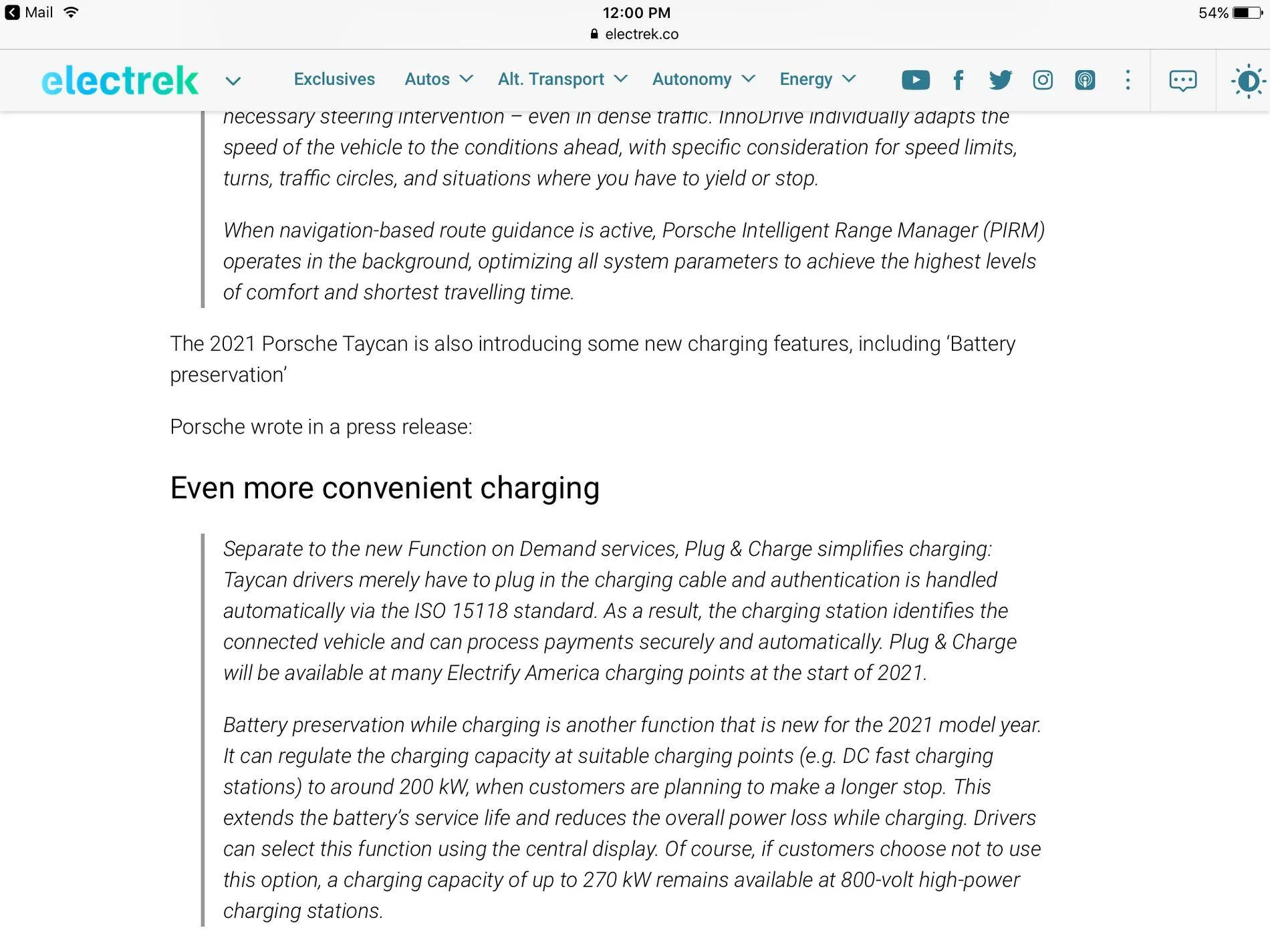

And with the 2021 changes, Porsche wants us to keep the battery fast charging to 200 kw, battery degradation, of course I have never seen rates close to that when fast charging.
