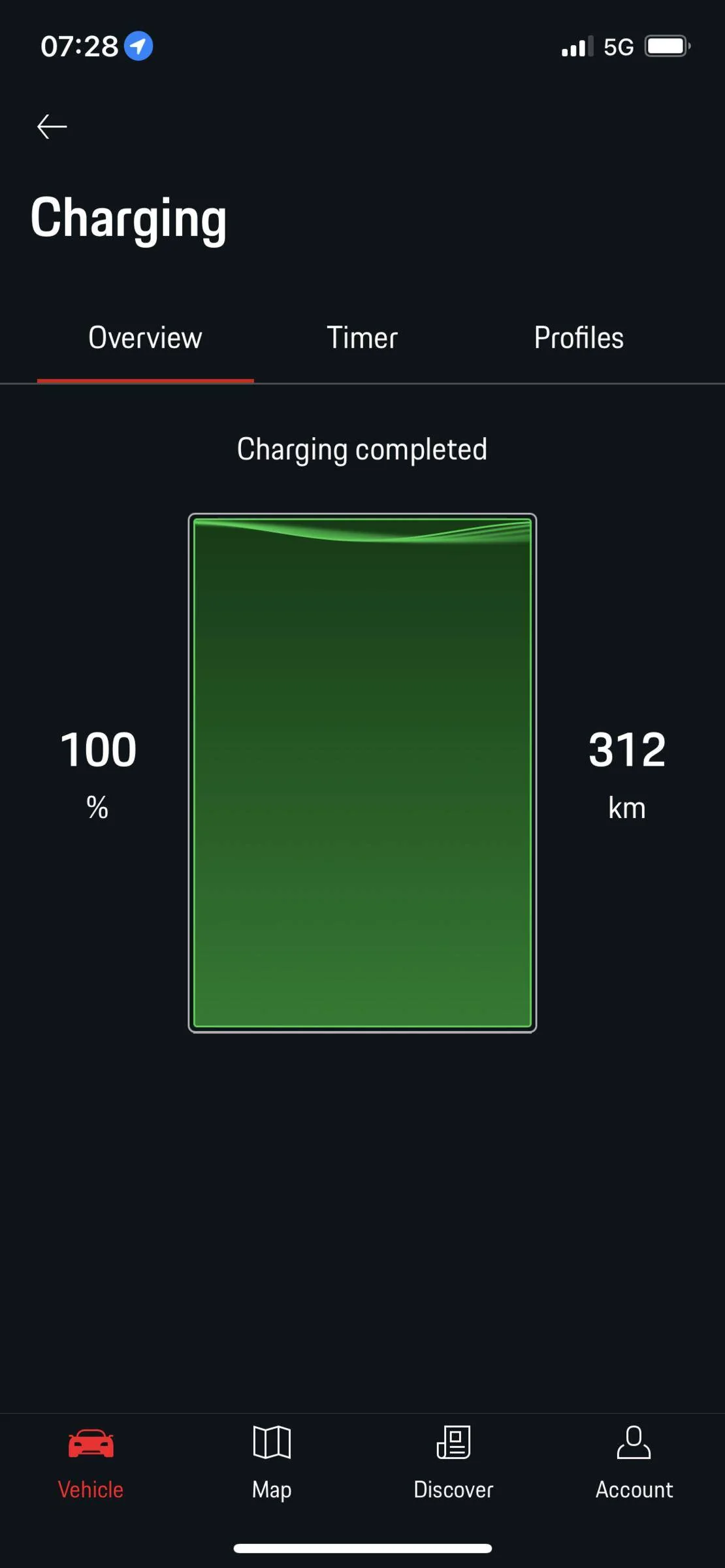

Hello guys. Yesterday I picked my car from the dealer and surprisingly fast I made battery to 60% :) mostly in sport mode.
the question appeared to me, why after full charge it shows me only 312 km ? I heard the new car needs some time to “adopt” battery. Is it true ?
Porsche Taycan Why my CT4 shows me only 312 km range? 573C4FEE-E29D-446E-B5FA-497B6522618B

Yes, that's true. When I picked up my 4S it showed 362km@100%. Currently, after 7500km, it shows 420km at a full charge. So give it some time and you will see improved range.

Recuperation will start working after 400-600km, when brakes will be "adjusted".
Than, your range estimation will raise ... but real consumption depends on your driving style, outside temperature, AC, size of tires, etc...
