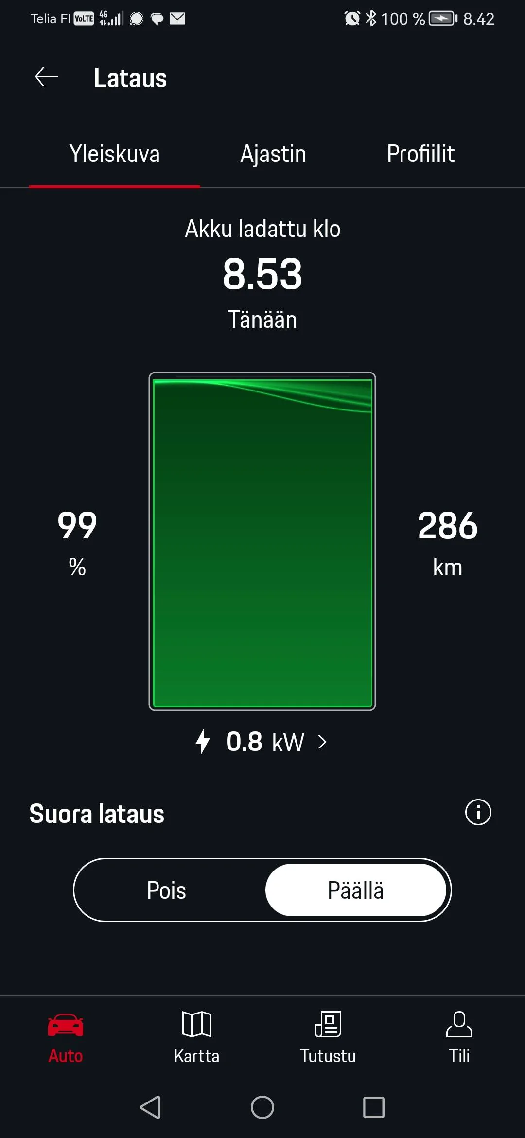

This is from this morning - 12 C.
.. with the small battery.
Porsche Taycan 177 KM Range Screenshot_20231211_084232_de.porsche.on

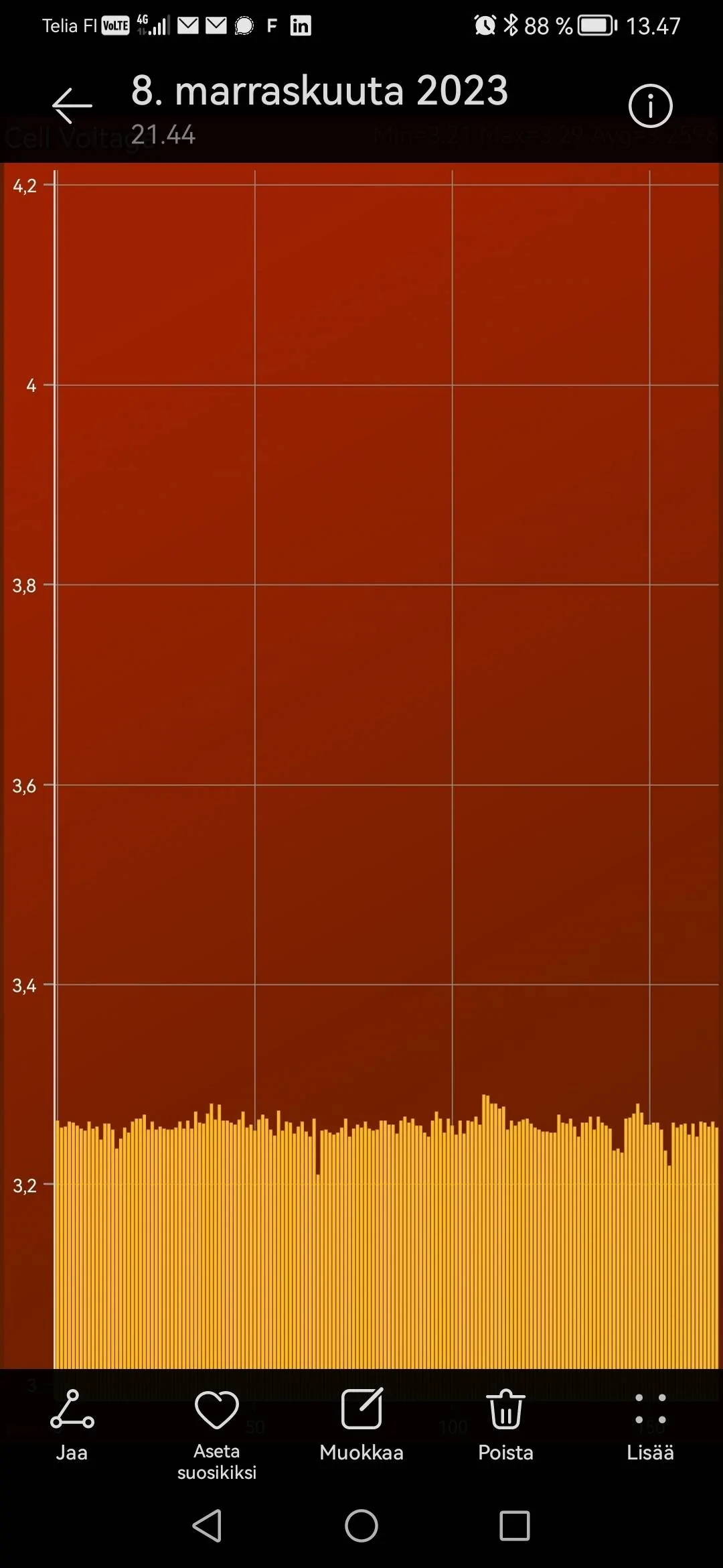

Would be intresting to see the cell voltages.
At Porsche they will see it in PIWIS but not report to customer.. so we have to send some money to Rostov-on-Don and support Putins attack war to Ukraine to find this out with 'Car Scanner'.
With empty battery it may look like this - and I'm not sure if this is very good:
Porsche Taycan 177 KM Range Screenshot_20231207_134701_com.android.gallery3d
3,907
3,553

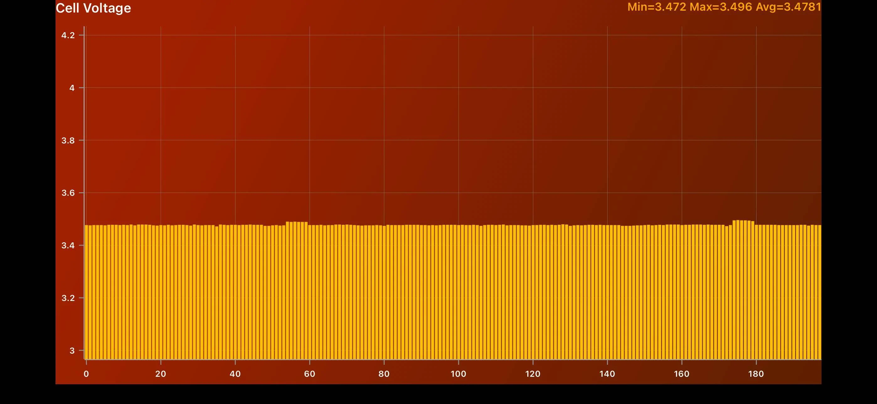

What was the SoC at that stage?? And had you just driven the car when you took that screen shot??
Would be interesting to see your results when you charge that up to 90+%. I think it should be much more even Across the cells.
Here is my car at about 30%Soc. you can however clearly see the two new modules that have put in. Once I charge the car to 85 -90% it equals out and is quite even.
