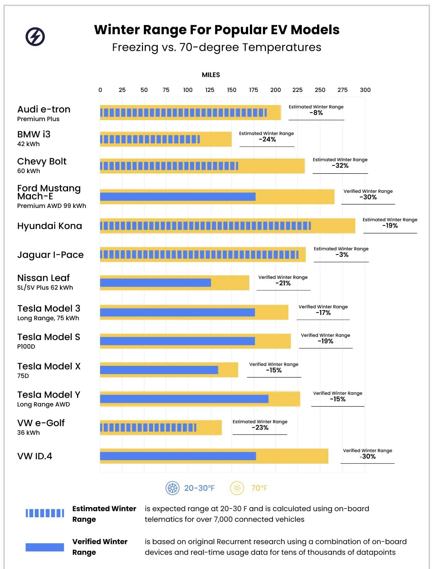

it would be interesting to see this chart split between two groups; those with heat pump, and those without. Am sure those without HP have a much higher loss of range in winter

and Taycan has a heat pump? I’m new here.
ClubIsolation
Dec 8, 2022
Cars
Wouldn’t we just assume the Audi E-Tron is pretty close to Taycan expectations?

This is from two years ago on some test runs on my MY2020 4S on 20 inch tires with the covid lockdown when there wasn't much highway traffic. With the uPdate I would expect 3% further range increase but the per cent ages should remain the same. Battery was from 100% SOC to as near as 0% SOC(<5%) as I willing to risk. Highway speed was a constant 115 kph/71.5 mph on cruise control. Pretty flat roads and no head or tail winds. The maximum range was achieved at or around 68F / 20 C. The colder the temps the bigger the hit.
Temperature C/F​
Distance Traveled Km/Miles​
% Reduction in Range​
22.4 C / 71.5 F484 km / 300.8 miles0
11.7 C / 53.1 F419 km / 260.4 miles13.4%
1.2 C / 34.7 F383.2 km / 237.5 miles20.8%
-8.7 C / 16.3 F338 km / 210.1 miles30.2%

These numbers are very similar to what we see on our 22' 4S

I get the same numbers for loss of range in cold temperatures, but I have a question. Why can't the Taycan pre-heat the battery while connected to the utility/charger? Would that make a difference? I believe Tesla's can pre-heat the battery.
