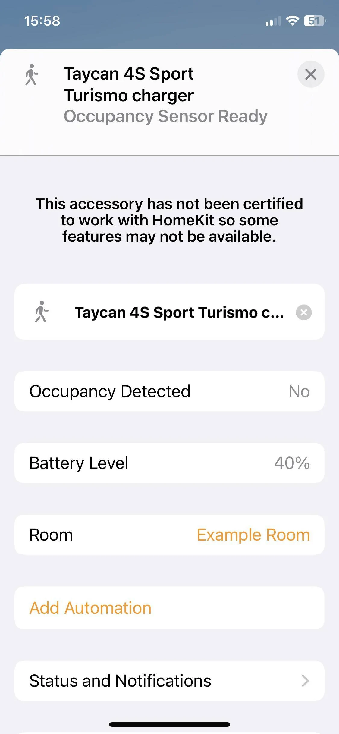

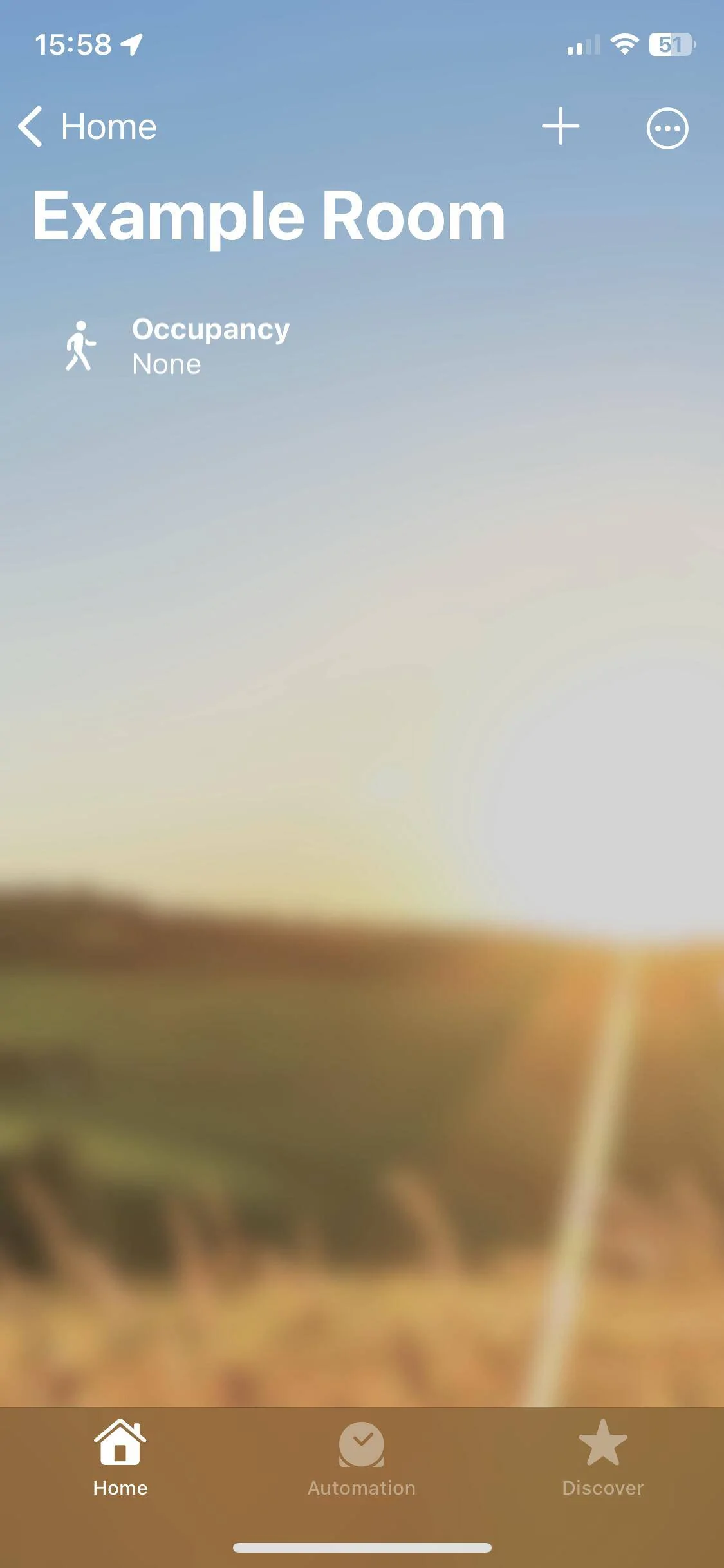

Since 2 weeks I'm proud owner of a beautiful gentian blue Taycan 4s Sport Turismo. I bought it because it was a Porsche (duh) but also because it is a tech car with all the beautiful displays and options. Last week I was playing around with the Porsche Connect API (I am a software developer), to see what options were available to play with. As a hobby project I made a Homekit plugin to see the Charge state and battery level in my Apple Home app. The API is pretty cool, so more will come in the future.
So this is the result;
Porsche Taycan Unofficial Homekit support for your Taycan! [Plugin available for download] IMG_9943
Porsche Taycan Unofficial Homekit support for your Taycan! [Plugin available for download] IMG_9944

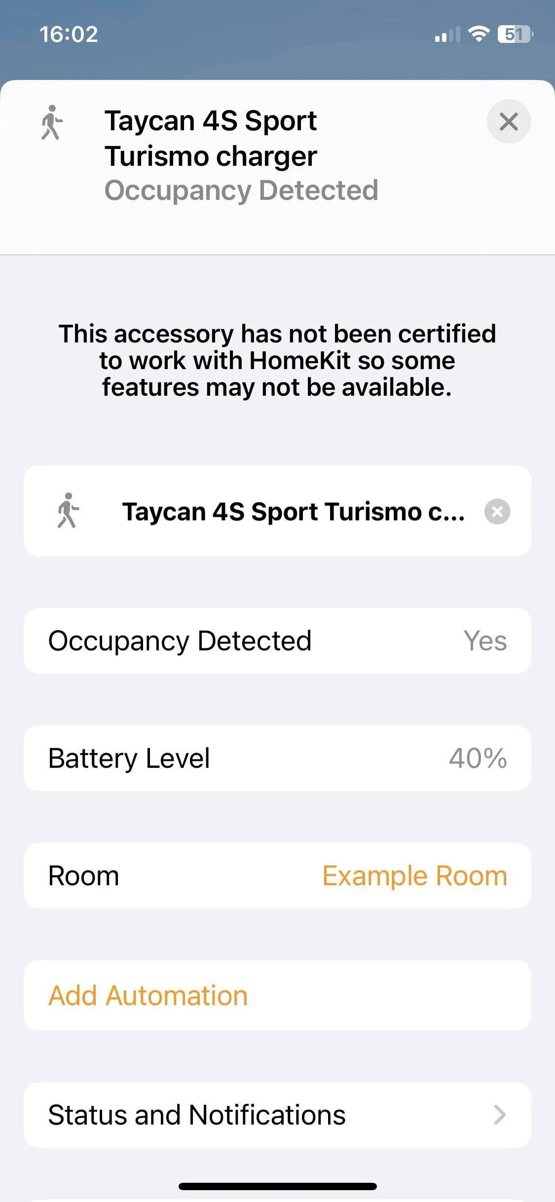

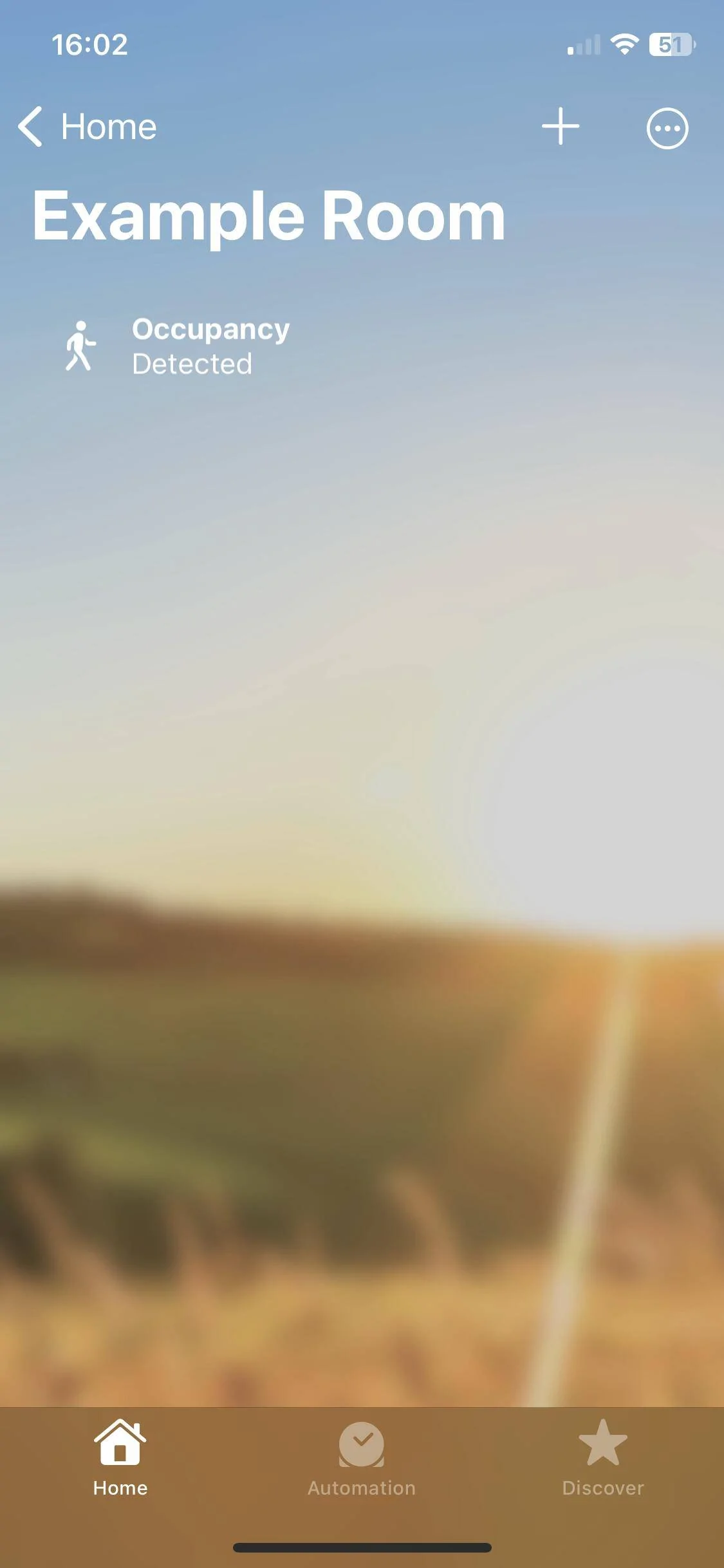

The plugin exposes 2 sensors; one to show you if your car is charging (occupancy sensor, occupancy detected = charging, no occupancy detected = not charging) and one to show you the battery level. Above examples are screenshots taken when the car was not charging. Below an example when it is;
Porsche Taycan Unofficial Homekit support for your Taycan! [Plugin available for download] IMG_9945
Porsche Taycan Unofficial Homekit support for your Taycan! [Plugin available for download] IMG_9946

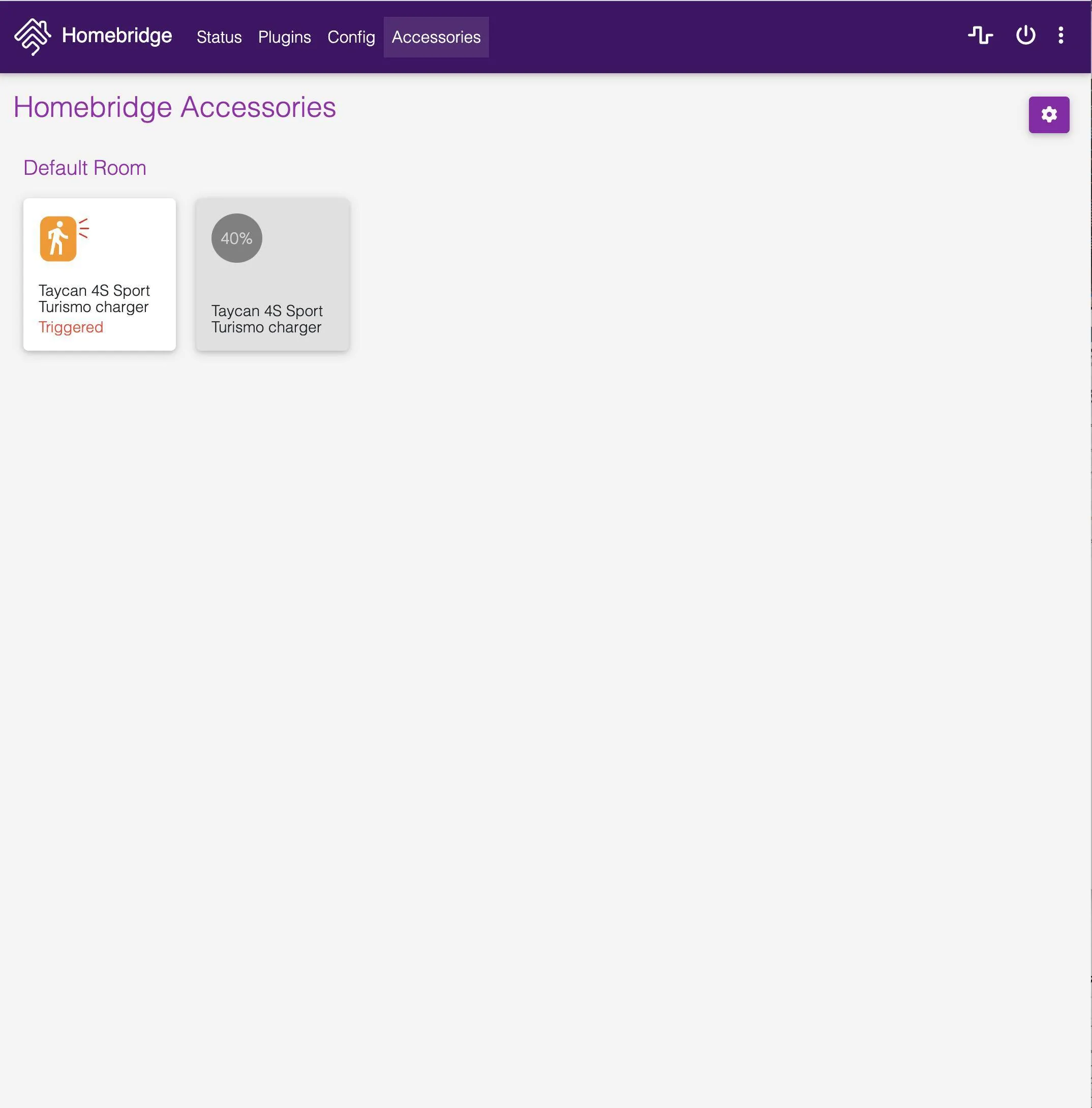

This plugin is made for Homebridge, A NodeJS solution to add unsupported devices to HomeKit. An example how this plugin looks like in Homebridge;
Porsche Taycan Unofficial Homekit support for your Taycan! [Plugin available for download] Screenshot 2023-03-03 at 16.08.51
