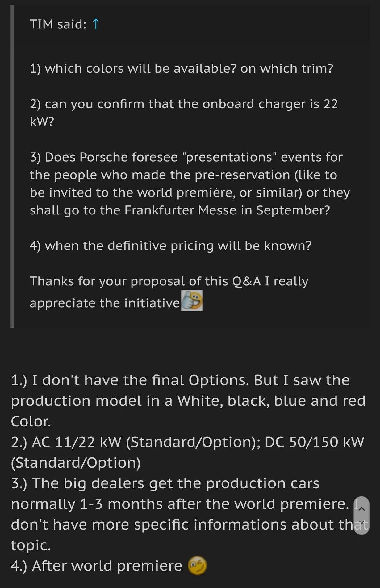

However, there was no option to be filled in for 22KW AC charging unless of course it is part of the 150KW DC charging package...… time will tell. :)

The 22 KW will be available as an option end of Q2 or Q3 2020 according to my dealer here in Europe
