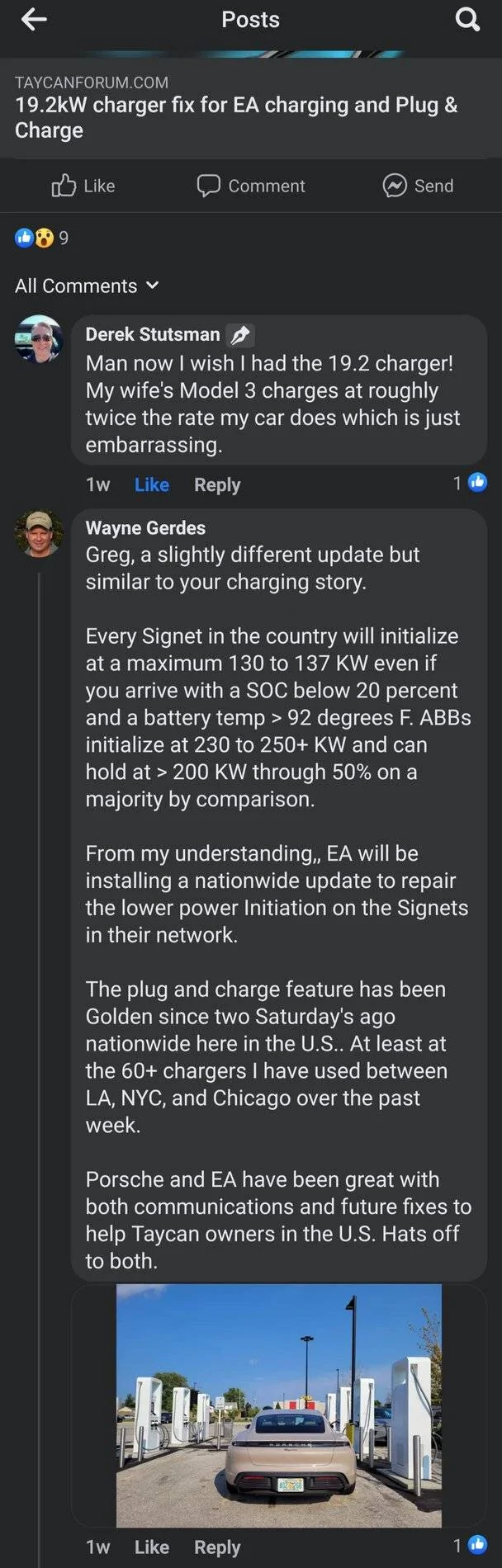

On the Porsche Taycan Facebook group it was mentioned that there is a known and completely separate issue right now with EA Signet chargers that limits their max rate (see attached). I experienced the same low rate (130kW max) with 350s in Walterboro and Charleston after the fix. I got 265kW at the same Walterboro charger earlier this year.
Porsche Taycan 19.2kW charger fix for EA charging and Plug & Charge EASignetLowRateIssue
as long as the car charges I am less concerned about the difference between a 120kw charge and a 240kw charge. yes I grasp that slower isn't better but up until now it was a crapshoot if I was going to get a charge at all. waltersboro was one of my worst charging experiences because of the lack of alternatives in that area.
Thank you for this. However, it's a bit confusing to me as the EA chargers I've used claim they are supplying what the vehicle is requesting (at least I have not noticed a difference in values). Even the times I was only getting 30kW at ~60% SoC and 7kW (yes, seven) at ~20% SoC. All of the EA chargers I use regularly are Signet.
