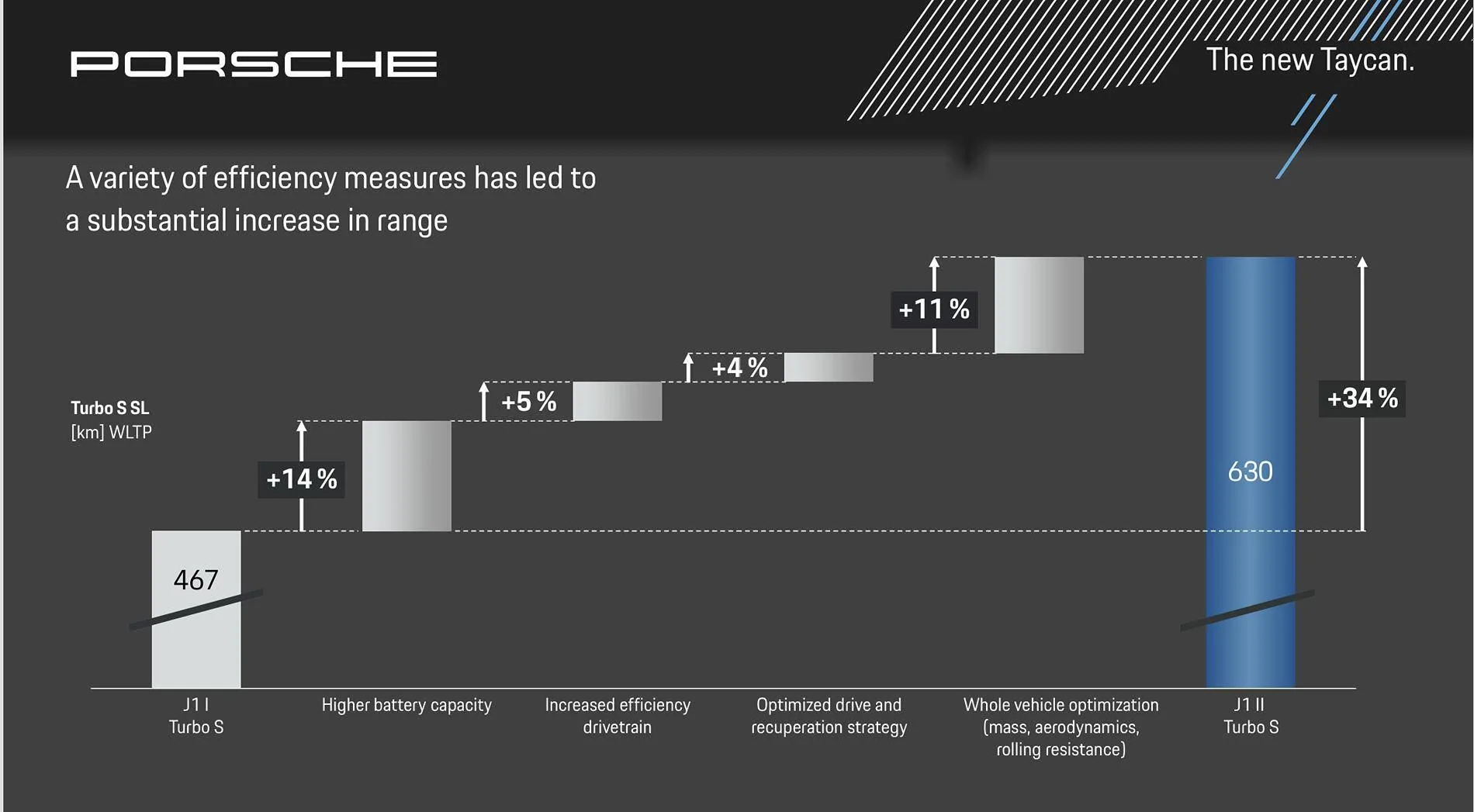

There's a chart on here showing where they got the extra range from.
Most of it is a 10%+ bigger battery.
Work on that basis and you'll be fine :)

This is the official chart showing range improvements for the refresh. However, reliability is still not proven given how new the model with revised components is unless some owners of the refresh models can share if they run into anything major. Range/Efficiency seem to be the most welcome improvement.

I have a new J1.2, went from J1 4s to J1.2 turbo so not a direct comparison with the turbo being more powerful but I get c. 30% more range, half from the bigger battery, half from efficiency improvements. Makes a big difference for me as a daily driver covering over +20k miles per year. The faster DC charging is also a nice improvement for long trips.

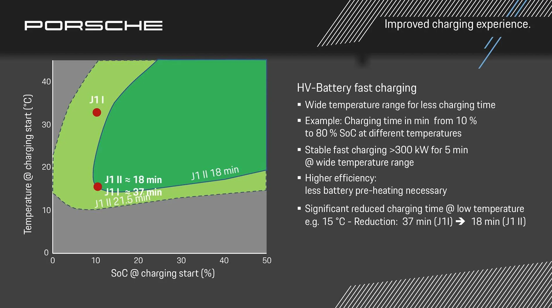

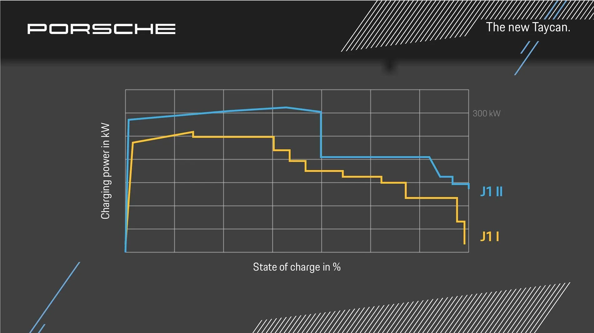

I have charts for that too. The main improvement is charging at higher rates in lower temps.
