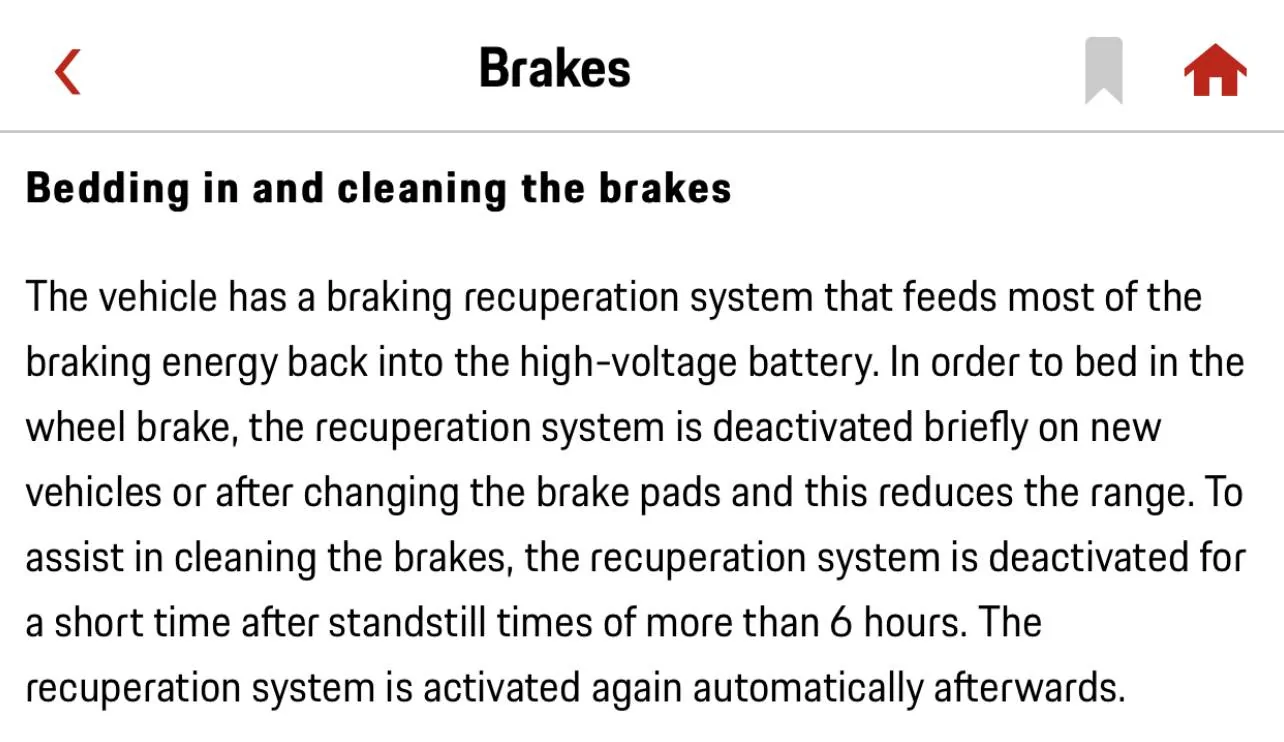

I got my 22 RWD on Friday abs after a full charge finally I see a charge of 181 miles when fully charged , does that seem correct? Am I doing something wrong as I thought the range would be around 200 or more when fully charged
There are quite a few prior threads on this topic ("Why does my new Taycan have such low estimated range?"), and a key point is that regenerative braking is disabled for (some say) 300 miles from new and after replacing the brake pads. From the Good To Know app:
