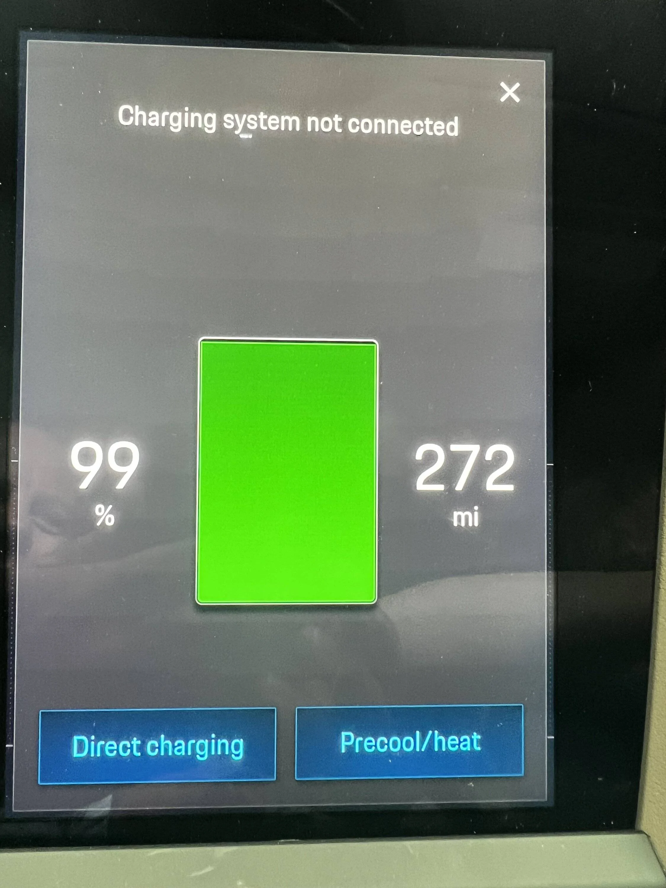

Is 100% full charge of 188 miles the best I can expect on my Taycan now or can I somehow improve this?
I have the 79.2 kWh battery. This is the range I usually have 6 to 9 months. In this case, snapshot was taken in September. Don't remember outside temps, maybe 70 F / 20 C. It's more than sufficient for my road trips.

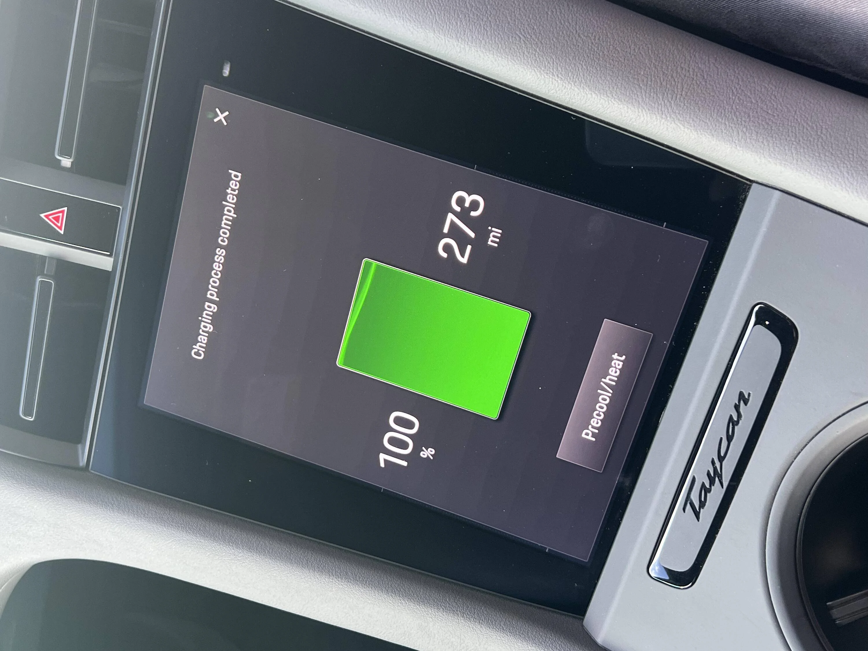

I think it all depends on the weather and the temperature of the battery .. here is the best I've had
While it’s certainly possible in the right spec and conditions, that’s your guesstimator, not your actual range…

😮 do you have the bigger battery or is that from the standard one?
I only have the standard one . this is it set to Range once it was fully charged
Aah yeah you're right .. this was me just before setting off on a long journey it was a nice sight to see just before we set off
