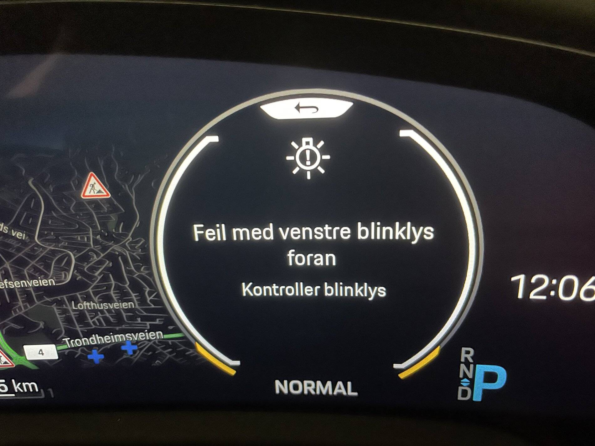

My CT4 has both the interior alarm being triggered at random times and I have been getting a "Front right indicator faulty" error despite it appearing to function normally. I have an appointment to address the alarm and I just put in clear side markers today so I'll see if the indicator error continues.
I also have a weird issue where the charging screen on the main display sometimes changes the tabs at the top to German, but then goes back to English when I navigate the menu.
Porsche Taycan 4s Cross Turismo Problems B79D378F-BBF1-4DEC-B435-B3306F19EEC7
I also got the front left indicator faulty a couple of times even if it works fine. Did not think it has any relation to the alarm problem though, but it showed after entering the car after alarm went off so it could be related for all I know.

Hi again,
I have an update. Today, it said ”Front left indicator faulty”. I took a video showing the proboem and contacted the seller and he sayd it needed reparation because one of the blinkers is faulty. The seller also stated that an ultrasound sensor may be broken and also needs reparation, and that’s why the interior survelliance keeps going off.
Really disappointed.
I will post more updates soon, when I know more.
@Cyberdriver888 : I've been sitting outside of the restaurant, when alarm started without any reason.
When I came back to the car, I got this " Front left blinker faulty"... but it works normal.
Just a glitch? :whew:

I also got the same "front left indicator error" once when the alarm went off. I think this indicator error is related to the alarm issue without a doubt. But for now though I just treat it as a glitch since my indicators work just fine and I haven't encountered the error during normal driving. I have no feedback from Porsche apart from that they are working on the issue.
