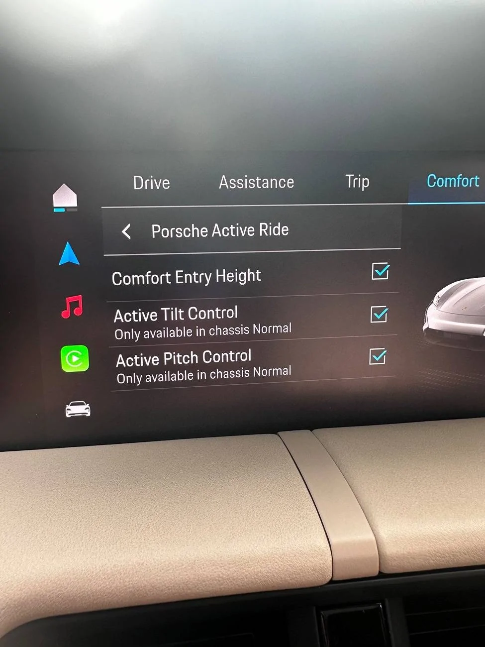

I guess I'm just unclear why the manual says
Not so.
Active always controls pitch and roll whatever mode, it is the degree of control which changes with mode, like with PDCC but more degrees of freedom controlled.
The comfort mode gimmick of leaning into corners and reverse pitch, which can be selected or not in normal mode, are just not available in the sport modes.
Maybe I am being provocative calling those "gimmicks" I haven't tried them but would probably disable them in normal mode myself. For me I just expect a good ride in normal mode.
So, I'm unclear what unchecking these options actually does or doesn't do, and why the manual says they are unavailable in Sport and Sport Plus?
F1eng's message is exactly right. It's the amount of pitch/roll. With those options selected, the car very slightly leans forward when accelerating, back when decelerating, and it leans into turns. What this means is the car is unnaturally leaned into those directions during those actions. IMO It's subtle, I like it, and it feels great.
With the options off, it acts as a normal suspension would during those actions.
All it means is that those gimmicks are only available in normal mode.
The suspension itself is active all the time, it has to be, all that varies in the different modes will be the response and simulated spring and damper rates chosen by the engineers as best for each mode.
These gimmicks are additionally available but only in normal mode, which personally I would leave off but may well be the only thing most owners notice about active ride.
A bit like most people noticing and mentioning the increased manouverability with rear wheel steer despite the fact that its raison d'etre is actually better cornering response and the smaller turning circle a convenient byproduct.
