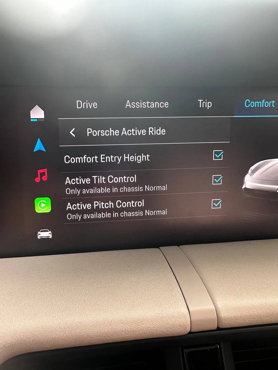

Not sure. But the manual says active ride can only be activated in Notmal mode. Perhaps this just refers to the Active Pitch and Roll, which can be unchecked in the comfort setting:
Porsche Taycan Active Ride - Less sporty? - Take or avoid? Active Rid

I have active ride and 16k miles in, 100% get it if you can stomach the cost, all drive modes from comfort to more aggressive / sport are enhanced. It is most noticeable at higher speeds when driving for either comfort or gunning it. Active Ride is the best part of may J1-2 Taycan.
To clarify on the on/off discussion, Active Ride is "on" ALL THE TIME in ALL MODES, it cannot be "turned off". In 'normal' mode you can choose to have an additional features of 'active lean' and/or 'active pitch' control turned on, with these options active, Active Ride will additionally overcompensate for comfort reasons but it is not to everyone's taste hence it is configurable (I personally quite like it when wafting around or have the dogs (or people?!) in the back).

ActiveRide is active even in Sport and Sport+ mode, though not as a roll stabilization feature in those settings.

Suspect they are referring to the optional 'active lean' and 'active pitch' control functions that do the overcompensation by 'leaning' the car for comfort reasons (the article references the 'counteracting' aspect of Active Ride "The Taycan will counteract natural lateral and longitudinal acceleration forces until about 93 mph") I could see this logic and sense to deactivate these optional modes at higher speeds.
