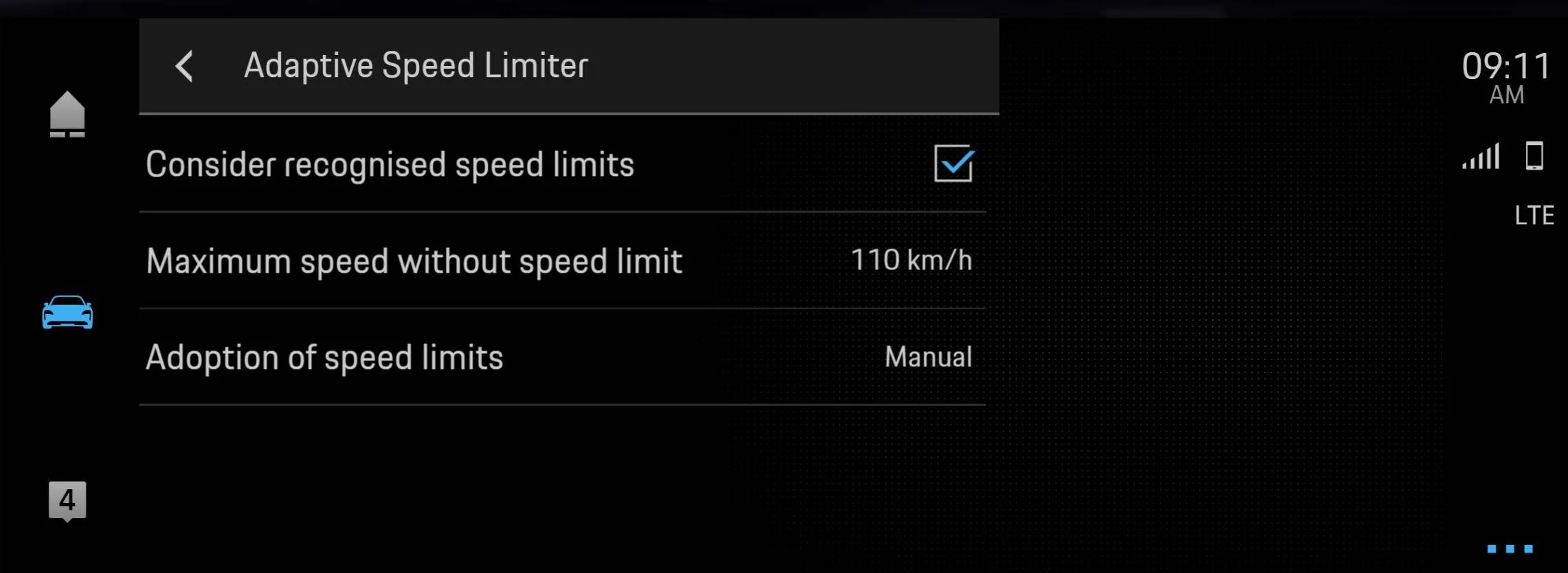

You can adjust it.
When the limiter is active then simply push the control stalk forward briefly for 1 km/h increments or press and hold for 6 km/h increments. To reduce pull the stalk backward. You should see a +/- indicator next to the maximum speed.
Max speed is set:

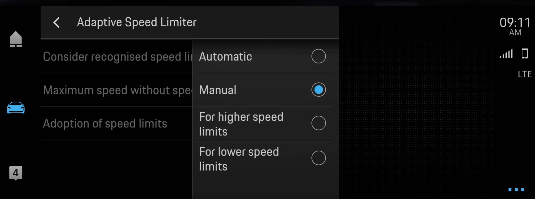

Further refinement also possible for 'Adoption of speed limits':

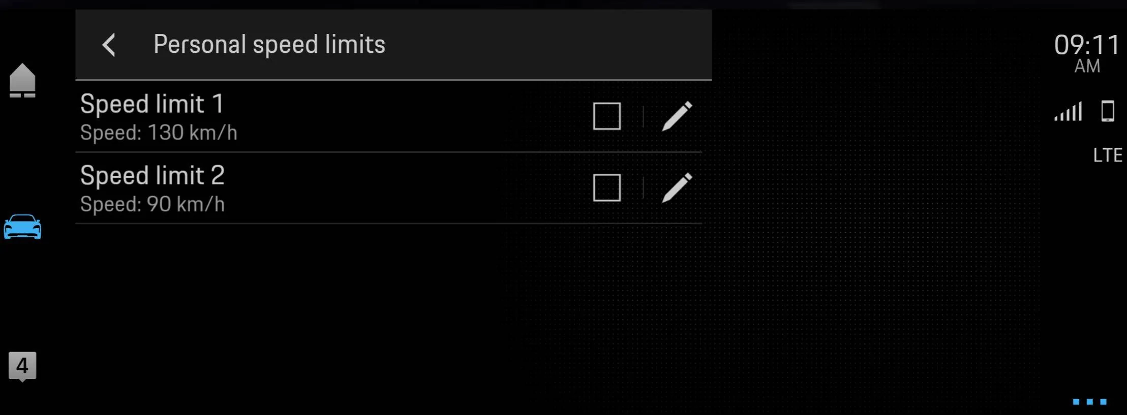

In addition to this you can set up to 2 personal speed limits

Thanks for this. I know about the manual adjustments with the stalk to adjust the cruise control, I am wondering however if this can be automatically done. So that for example it always automatically goes to 84km/h when reading a 80km/h sign, and without need for me to adjust manually each time.
I always set the cruise control a few km/h above the speed limit as there is a tolerance with the speed traps (and I don't mind getting caught every now and then for being just above that tolerance – but it's only happened once when driving 130km/h on 120km/h speed limit. )
Thanks
8,807
5,272
GTS ST, Macan T
Thanks
Sorry, I don't think there is an automatic path (no option to set one) and manual only.
