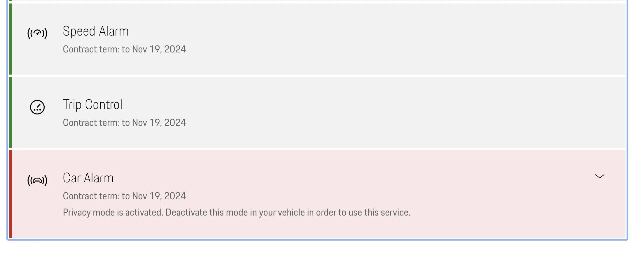

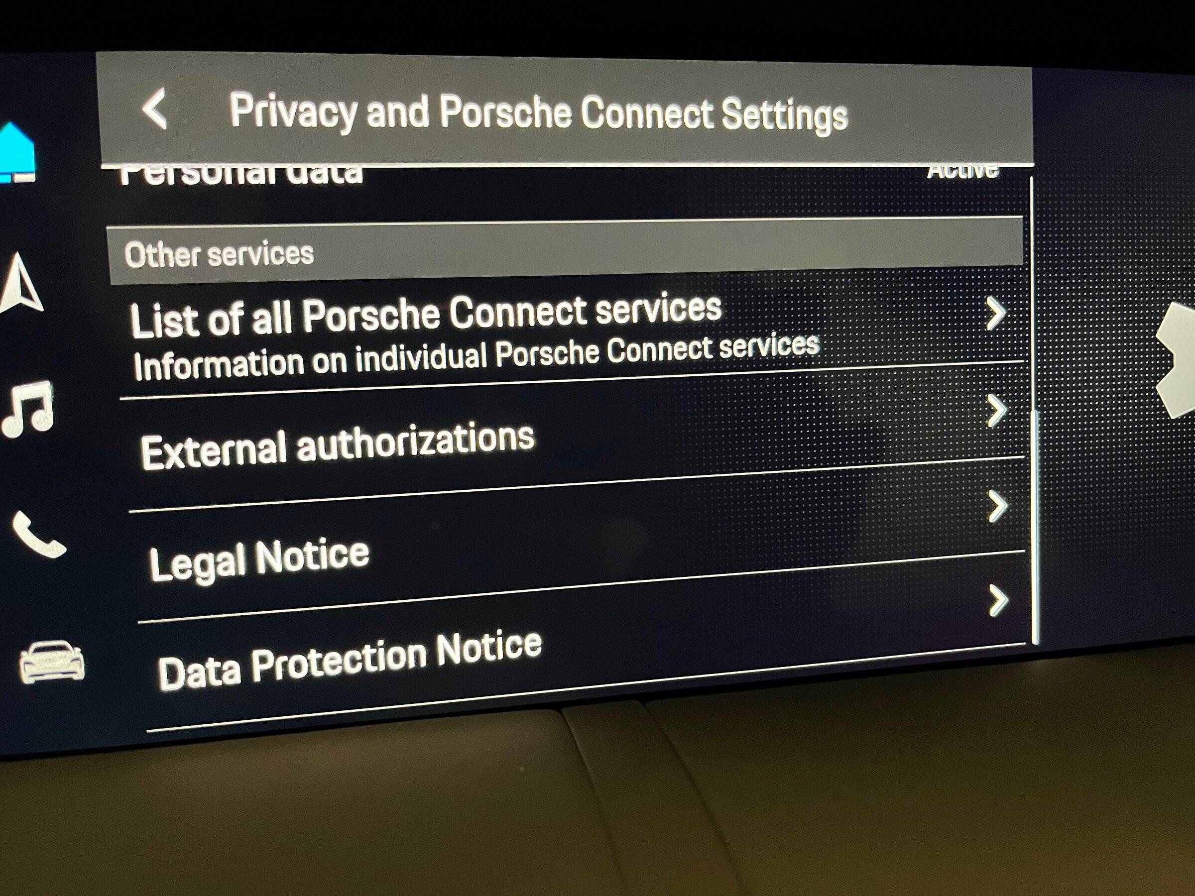

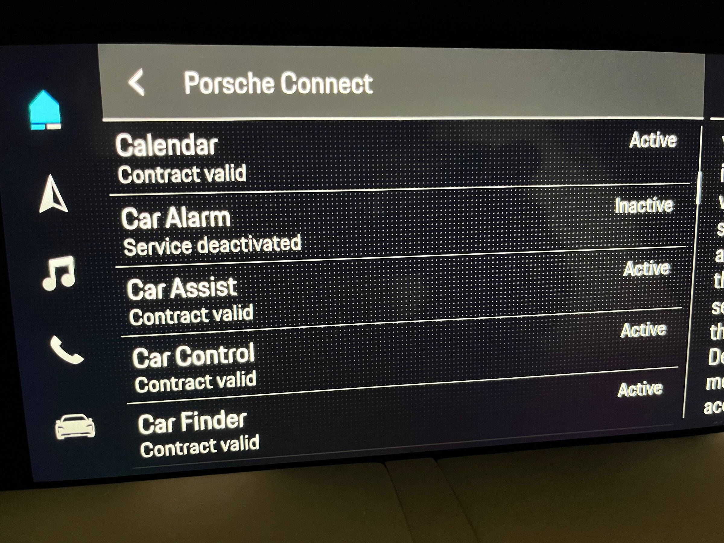

My Alarm went off two times this weekend for no reason. This was the first time it happened for me. Once the car was plugged in and parked outside, and the other time at 1:30am in my garage, not plugged in. I had a theory and it hasn't gone off for two days now.
My car was delivered and still in the "Transport" mode so I could not login with my Porsche ID. I was logging in as guest for three weeks and did not have the alarm issue during this "Unregistered" time. Last Thursday I brought the car in to my Porsche Dealership and they took it out of "Transport" mode and registered the car to my porsche ID. My App started working correctly and I can see information about the car and get notifications, including when the car alarm goes off. A day after getting the car registered to my Porsche ID, the alarm went off randomly as described above.
My theory was that I didn't experience the issue because the car was not registered to my porsche ID. Now that it is registered to my Porsche ID, I tried dissabling the "Connect Service" for the "Car Alarm" in my car configuration and maybe my alarm won't keep going off. Turns out I could disable the "Car Alarm" connected service and now the website shows the "Car Alarm" as having "Privacy Mode" active and I haven't had an alarm for two days. If my alarm goes off again I'll update this post. It must be disabled from the Car.
In the car PCM,
Settings -> Privacy and Porsche Connect Services -> List of all Porsche Connect services -> Car Alarm : Inactive
Website will then show Car Alarm as in "Privacy Mode" and in red.

Hi yes I started this thread an mentioned that as mine and my dealers work around to put in private mode..it has stopped the false alarms since setting it up that way. I still don't have the Porsche connect app on my phone and life goes on without...all good.

Thanks Peter P100, you cracjked the code. That’s why th3ey go off when you bring the car home because until whcih time. You login the car is in Transport mode. My car was at dealer for 3 + weeks and that was the conclusion they put it in privacy mode. Still my ID is active just doesn’t connect to my phone app. I would suggest your solution and deleting what is a pretty shitty app. When in Privacy mode the app doesn’t talk to your car.. which is the cause of the false alarms. Peter thank you for your post. You cracked the code much more eloquently than I could…
In the car PCM,

Excellent post! I'm currently trying this (temporary) solution and so far... no alarms :clap:
Disconnecting the connect service for the alarm through the PCM did the trick. Drawback being of course that if the alarm goes off, you won't get notified in the app.
