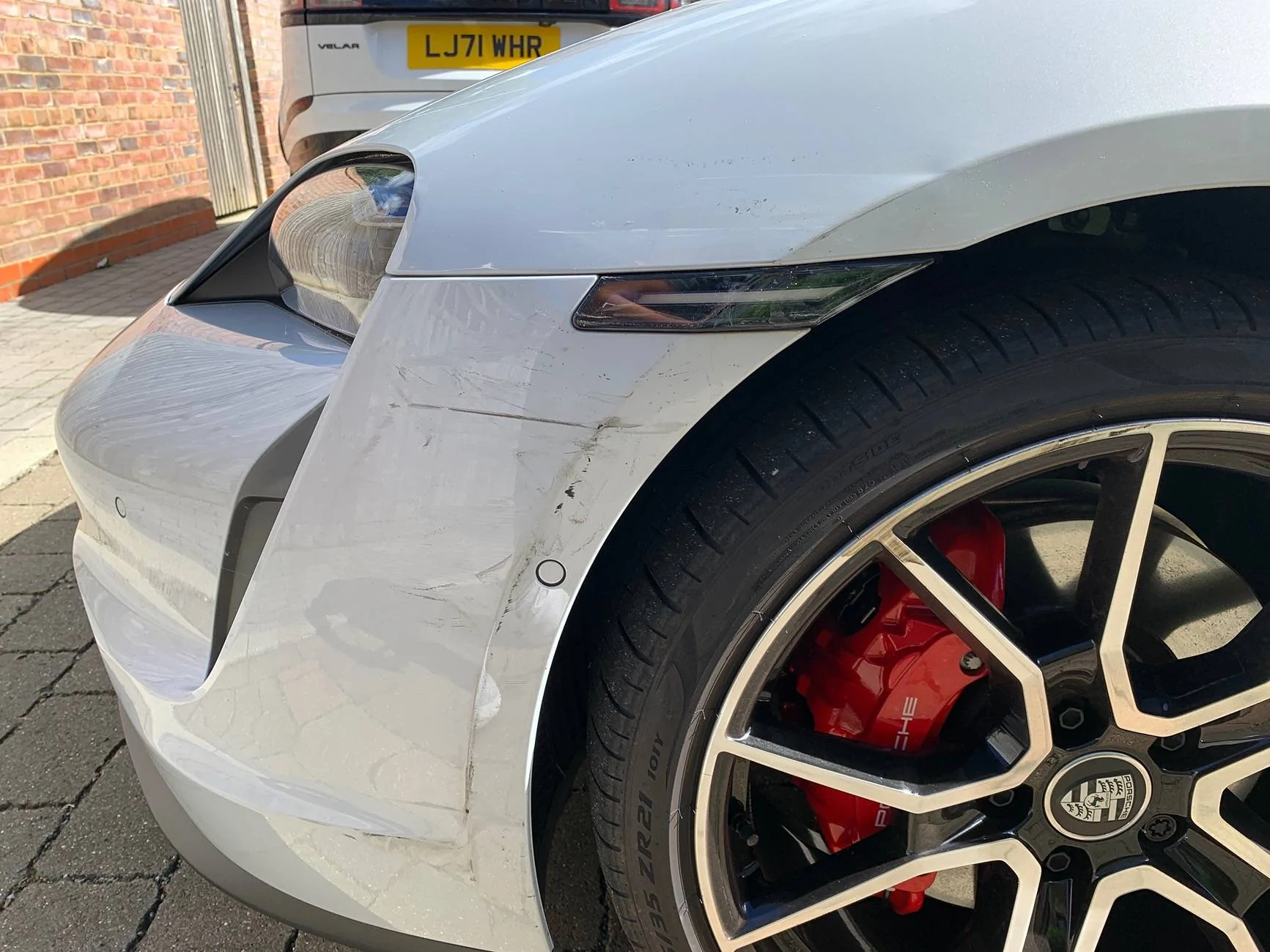

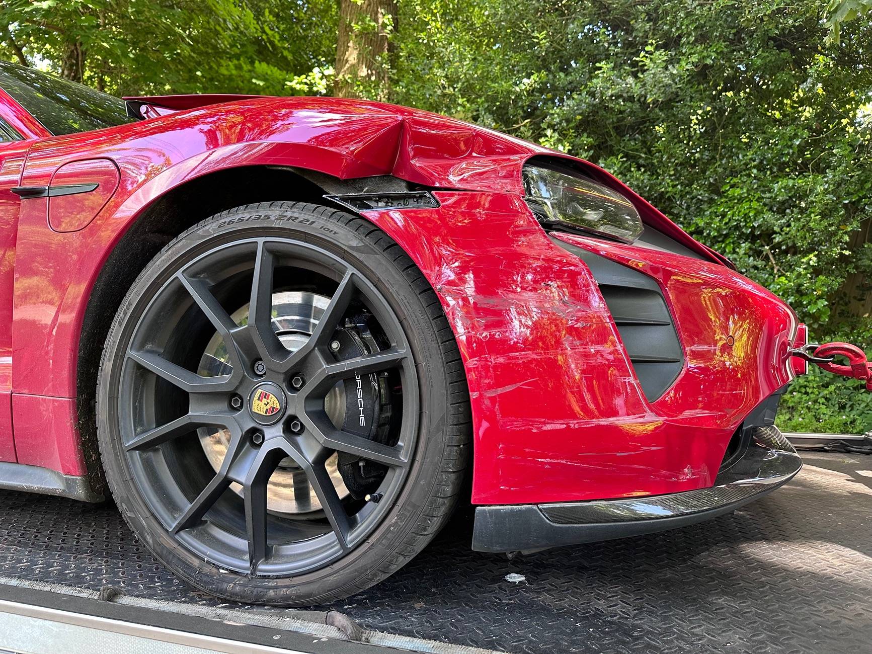

Work being done by M & A coachworks.. seem to be Porsche approved!
both bump and PCM issues happened around the same time?!
M & A coach works do work to such high quality. Only just got my car back after it was t-boned at a junction where driver didn’t stop

Got an ‘after’ picture?
Not taken one yet but will try and do IT tomorrow though car is a little dirty
M&A coach works was superb the whole way and had my pod and ceramic coating put back on as well

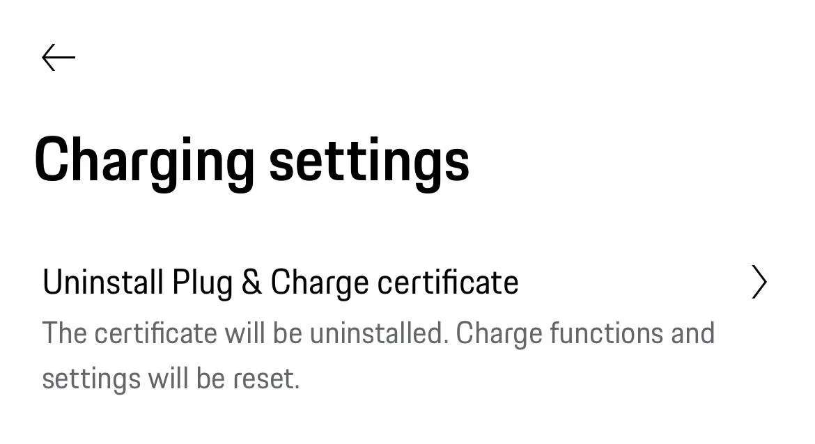

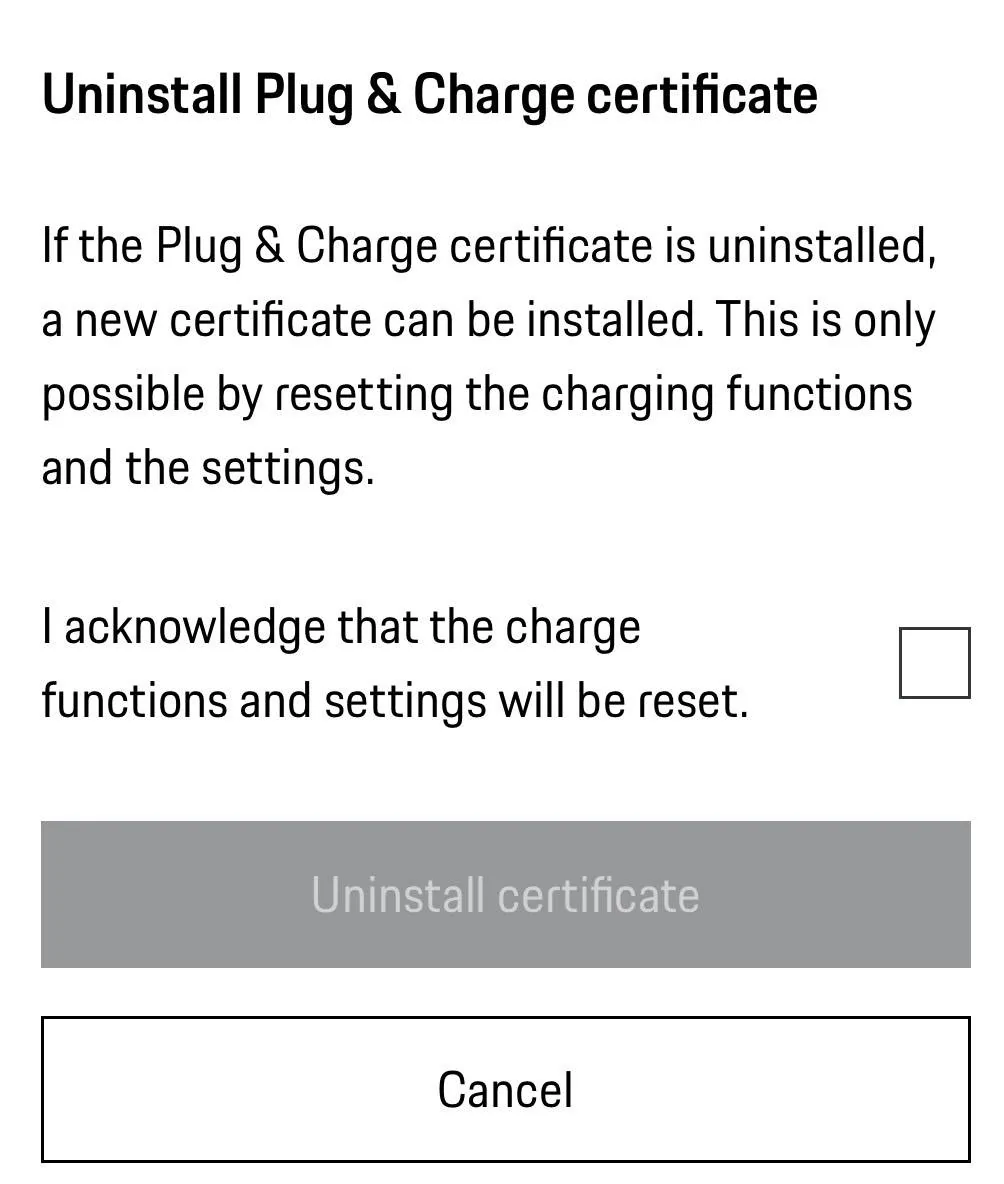

Apologies in advance if this is thread drift, but ...
... what is up with this notification in the app?
Seems like I should just ignore it permanently, but seems to be such an odd prompting.

a more annoying matter... a delivery van clipped the front corner of my parked car and didn't stop. Luckily the car behind snapped a pic of the van so is with the insurers. Work being done by M & A coachworks.. seem to be Porsche approved!
Hi Jin, so sorry to see that happened to your car. It seems to be the way these days that people just drive off after something like that. Pleased for you that someone got a pic of it. Hopefully you will get it sorted soon. Had mine in at M&A in the summer for a new wheel (kerbed it and Porsche insisted it was replaced). I would highly recommend M&A. Their staff are great, and they deal with a lot of high end supercars. They had at least 3 Taycans there when I went in. Also, Ferrari Roma, other Ferraris, Bentley conti GT, many other Porsches. Think you will be in safe hands.
