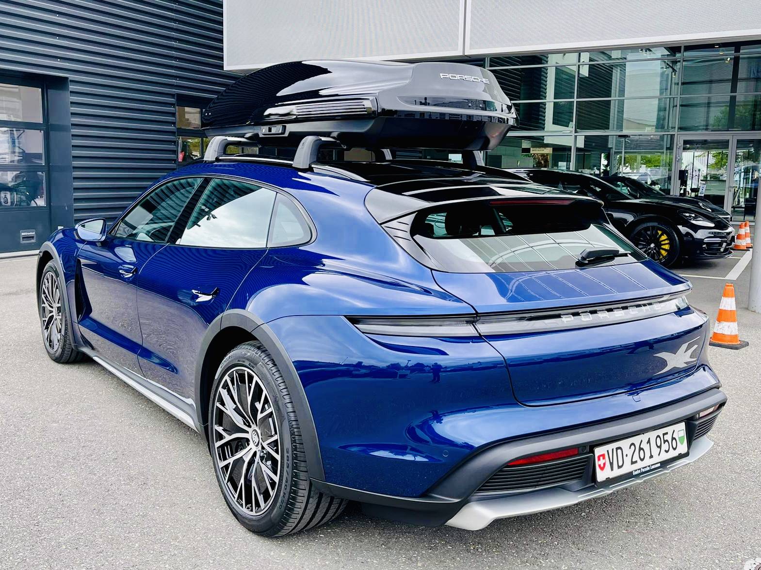

Thanks. The roof box is great by the way! Was able to fit 4 decent sized bags in there plus a load of stuff around them. The dog had the boot to himself!

Did you get the “speed box” version?

A real beauty… 6-7 more weeks to wait for me, and I am not really known for patience ??

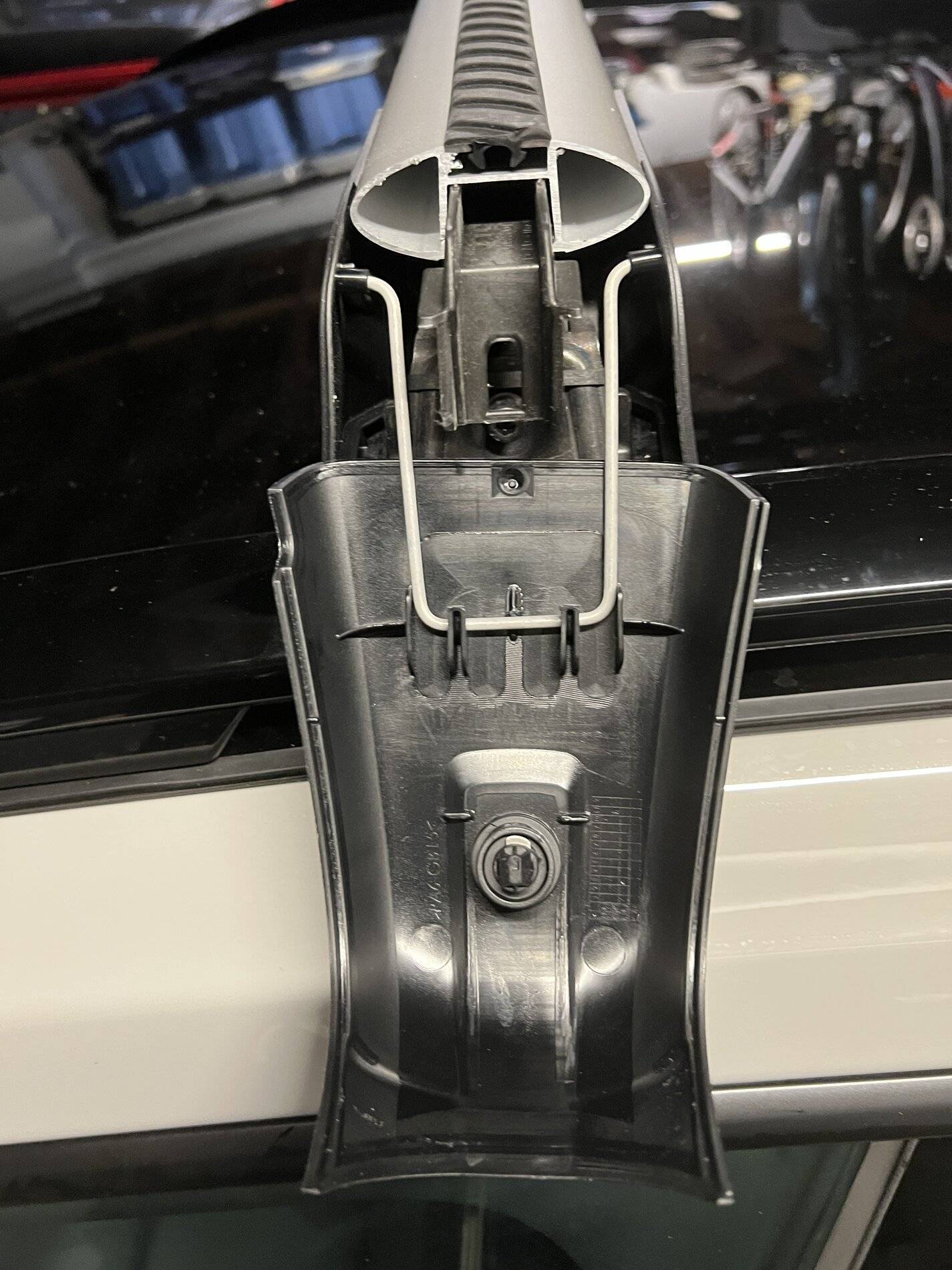

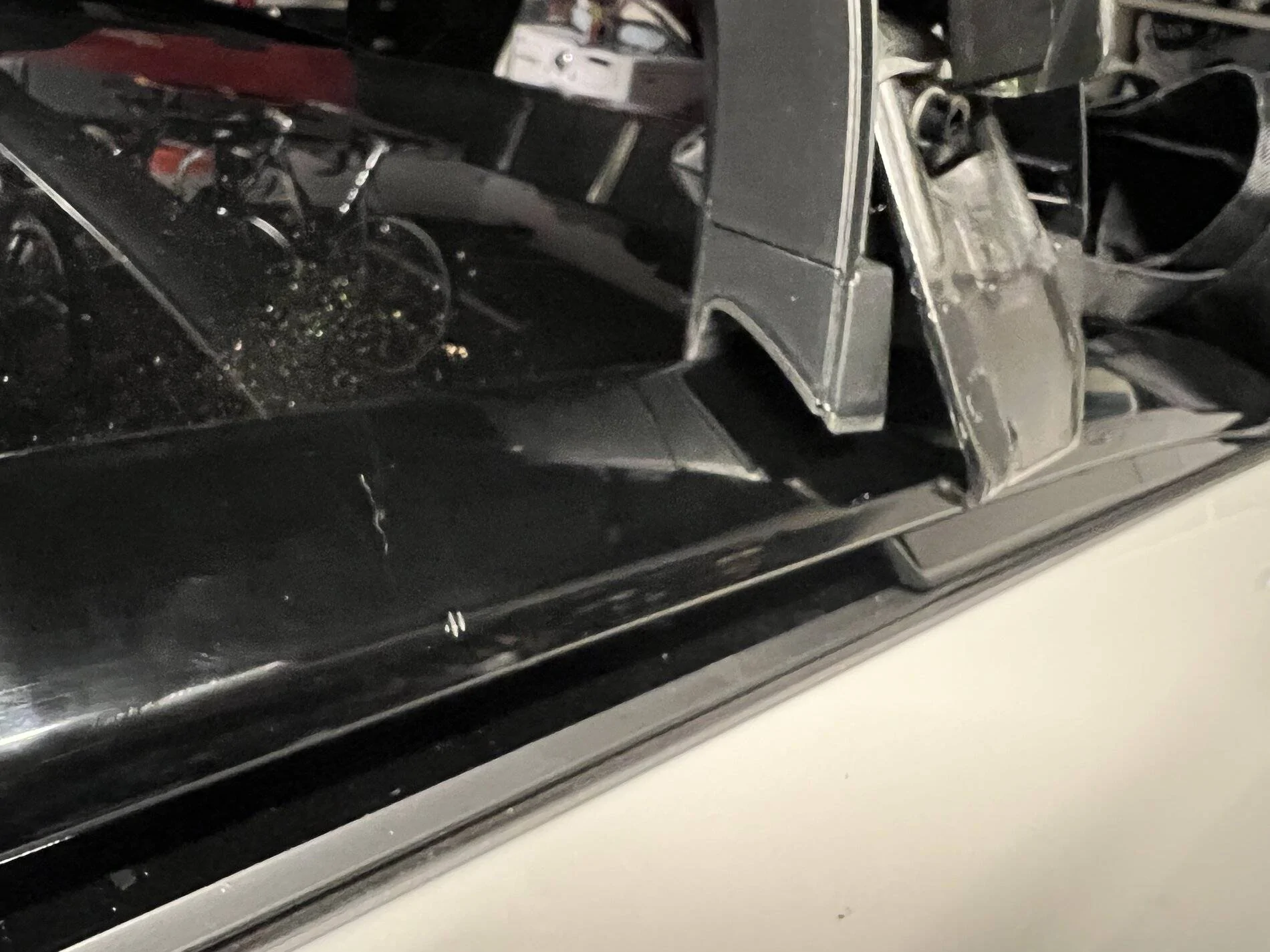

I installed mine following the directions and damaged rails on both sides as well. I was surprised how cheaply made these were. The covers are pretty flimsy and are barely attached to a bent metal hook. Two of mine kept popping off during installation. The factory rails for my Golf Alltrack are much better quality.
Porsche Taycan Anyone got the Porsche roof bars and box? 60CCF846-CB98-4B39-80BA-1316946E0B04
Porsche Taycan Anyone got the Porsche roof bars and box? 3681E9AC-7C5D-4E27-AB6D-EA353F0A43D5

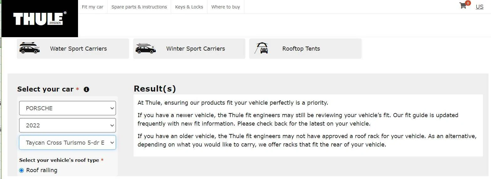

The Thule website in the USA (www.thule.com/en-us) does not include roof bars for the Taycan CT. I just took delivery of my car on 13-Nov and I noticed that the roof rails have two sets of locating holes on the inner side of the rails. The holes are about 6mm in diameter and about 40mm apart. The front and rear sets are about 800mm apart (about 32"). The photos posted by Swissbob do not appear to include these locating holes. If the rail design has been changed to include these holes I can imagine a new type of chassis specific cross bar that does not clamp around the rail and can simply be expanded between the rails on either side of the roof.
Don't be confused by the reflection of the rail and the ceiling of my garage on the glass roof of the car.

Looks like Thule are updating their US site at the moment. Both CT and sedan are now listed within the roof rack section but no products displayed yet. I guess its a case of 'sit tight' to see what they publish.
Porsche Taycan Anyone got the Porsche roof bars and box? 1637073862576

The holes are there on the macan also, I think they’re just a visual indicator for where to mount the cross bars. We have a rack on our macan and that’s what I used them for

The holes are there on my Taycans rails - the roof bars locate into them before clamping down on the otside edge of the roof rails.

The holes apparently do not precisely locate the roof bars, since Swissbob reports damage on the rails a few mm apart after installing the bars multiple times. I am hoping that Swissbob chimes in to confirm whether or not his rails have the holes.

yep I also have the holes so not quite sure how the marks were not in exactly the same place ?‍♂
