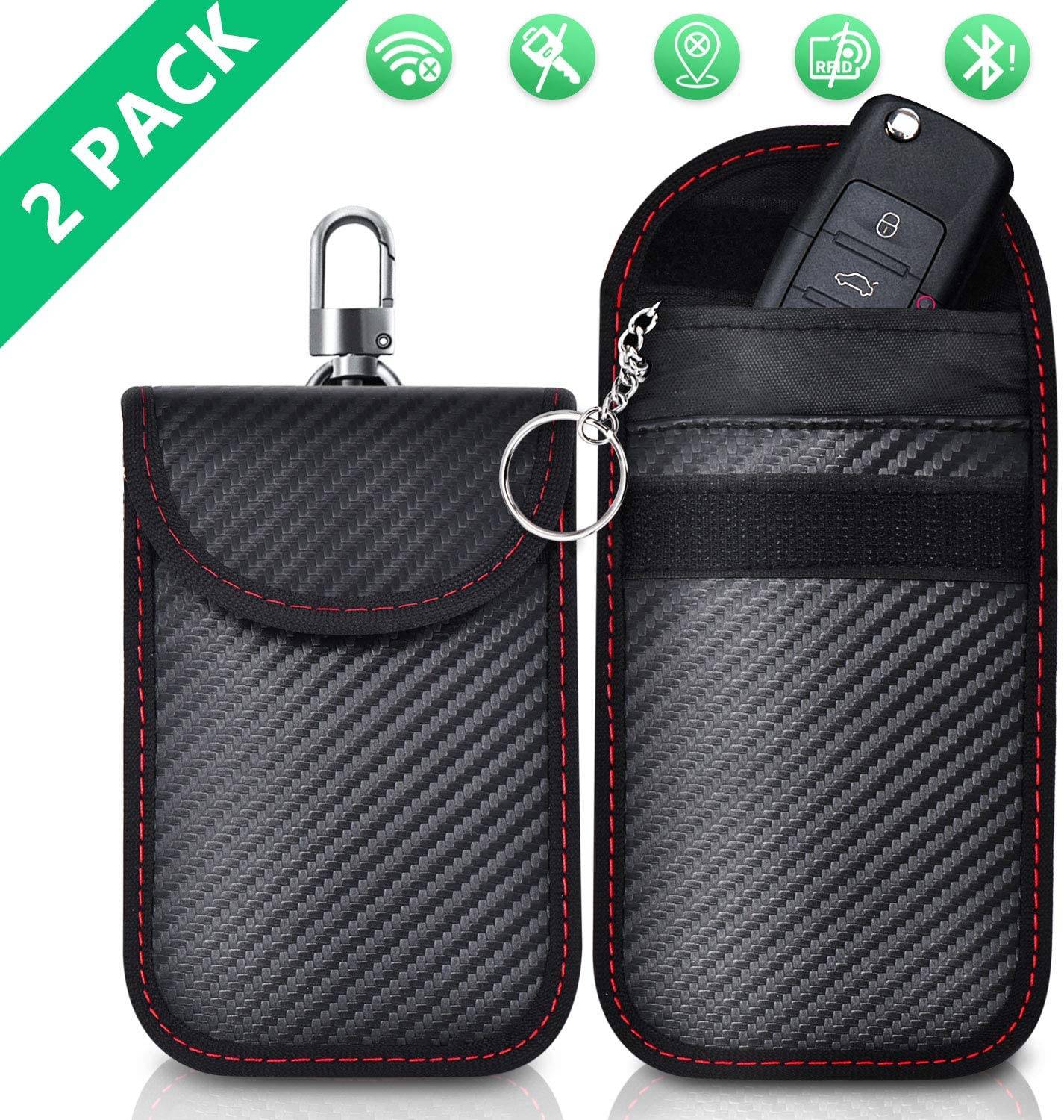

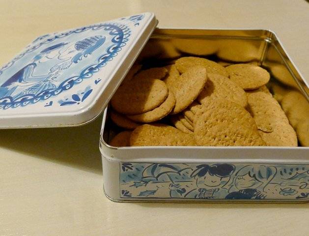

The cookies have been processed, at home I always keep my keys in...
Porsche Taycan Are the keys safe from relay theft? koekjestrommel
When on the road and not driving, I have my keys in...
Porsche Taycan Are the keys safe from relay theft? 818c89zwL4L._AC_SL1500_
