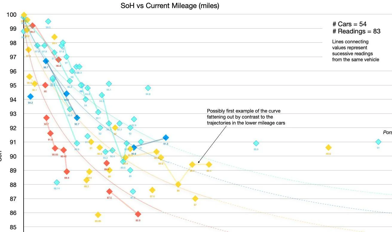

Excellent thx - chart updated and added a comment to your specific trend as you might be the first example we are seeing of a flattening out of your SoH trend :) - speculative at this stage of course!

Curious to know what your usage and charging patterns are like.
@lcarron
My car is following the exact trend he is on so suspect his not that dramatically different in respect use - I def need to go through some 100% down to sub-20% charge cycles along with preferably some more decent road trips lengths to see if mine recovers/stablizes in any way from its current trend!
The upper connected red curve my car (after only 7250 miles and 1.5 years of use!) and Icarron's car the line with two control pts and 20,000 miles, also in red for Hot climate.
Despite all the skepticism re SoH measurement (not going there again :)), these albeit potentially slightly negative OBDII data are holding their (climate zone) trends very well (54 cars and 83 readings to date).
We currently have data from 11 US States (covering all 4 zones and only country to date with Hot climate data but only 5 cars) and globally data from 12 additional countries from Turkey to Finland (mostly EU).
Your car holds highest values for the Hot trend so you might be the luckier anomaly :)
