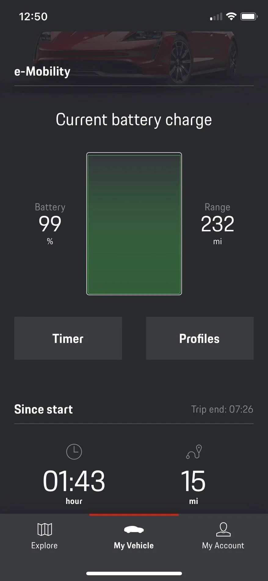

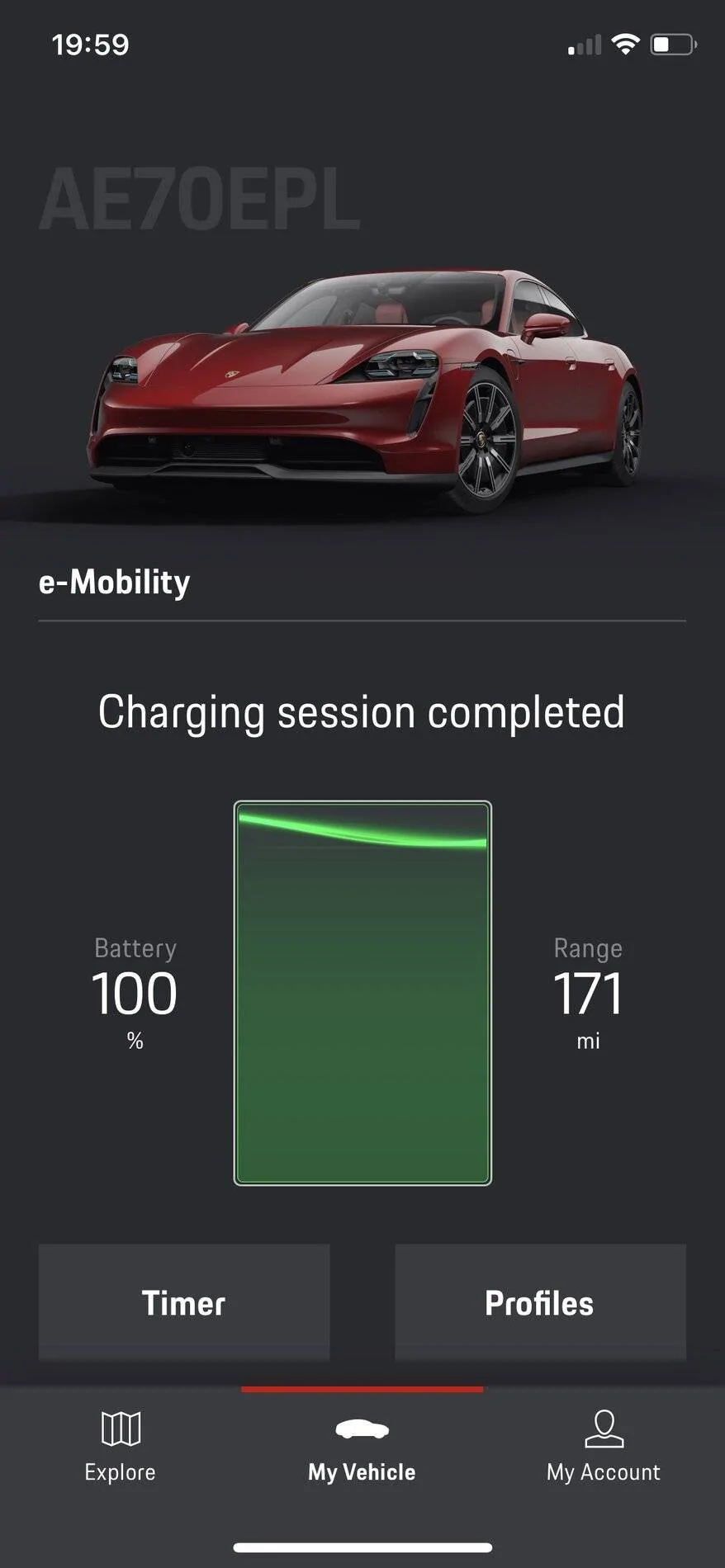

New update:
As the car is in now for the 5th week:eek:, it looks like that yesterday they found something.
During the time it was in the garage I could see that they raised the range slowly from 150-170 miles to now 232 miles! On Friday the range was still 171miles at 100% but yesterday the range went to 232 miles. They did a total of 395 miles during test drives. I assume that they will do a range test now before they give the car back. I hope that after some long range tests the range will go back up again to over 250 miles to what I had before. Can’t wait to get the car back:clap: (the 171 miles pic is from Friday night and the 232 miles pic is from Saturday).

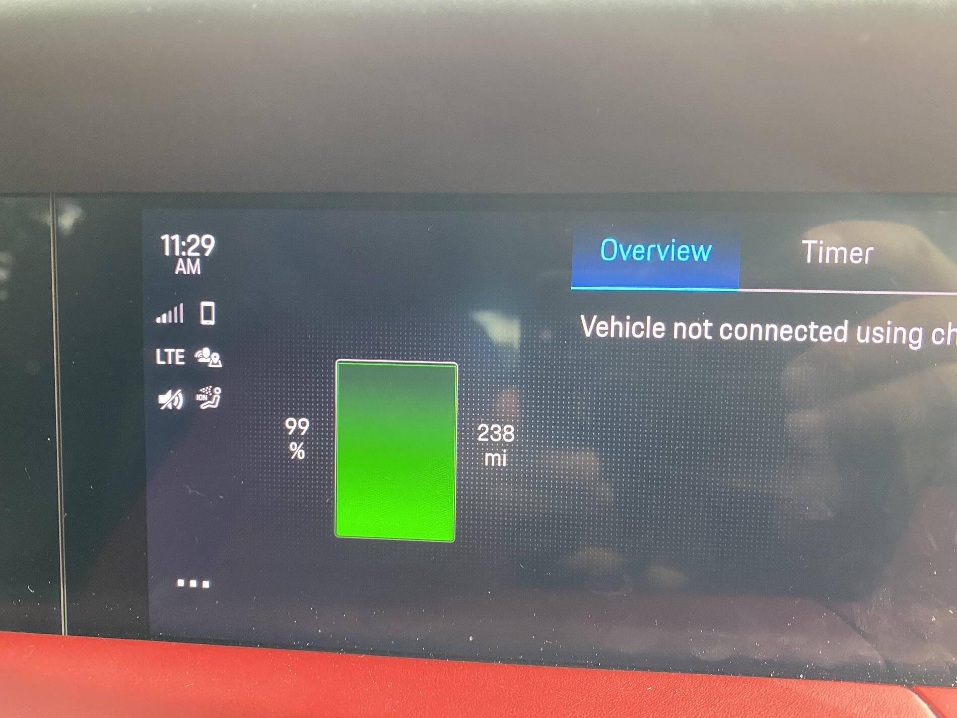

Hopefully last update:
Today I got y car back after 5 weeks.
I am happy to report that I habe now 238miles at 100%.
Why would anybody accept 140-160 miles at 100%?
I would give the car back with 150 miles as this would not be acceptable for me.
And as we can see now, there must have been a problem with the software. I hope this will stay now like this and that the capacity will actually improve now over time.
So far the update works well and already noticed some good changes.
So happy to have it back now:like::clap:
