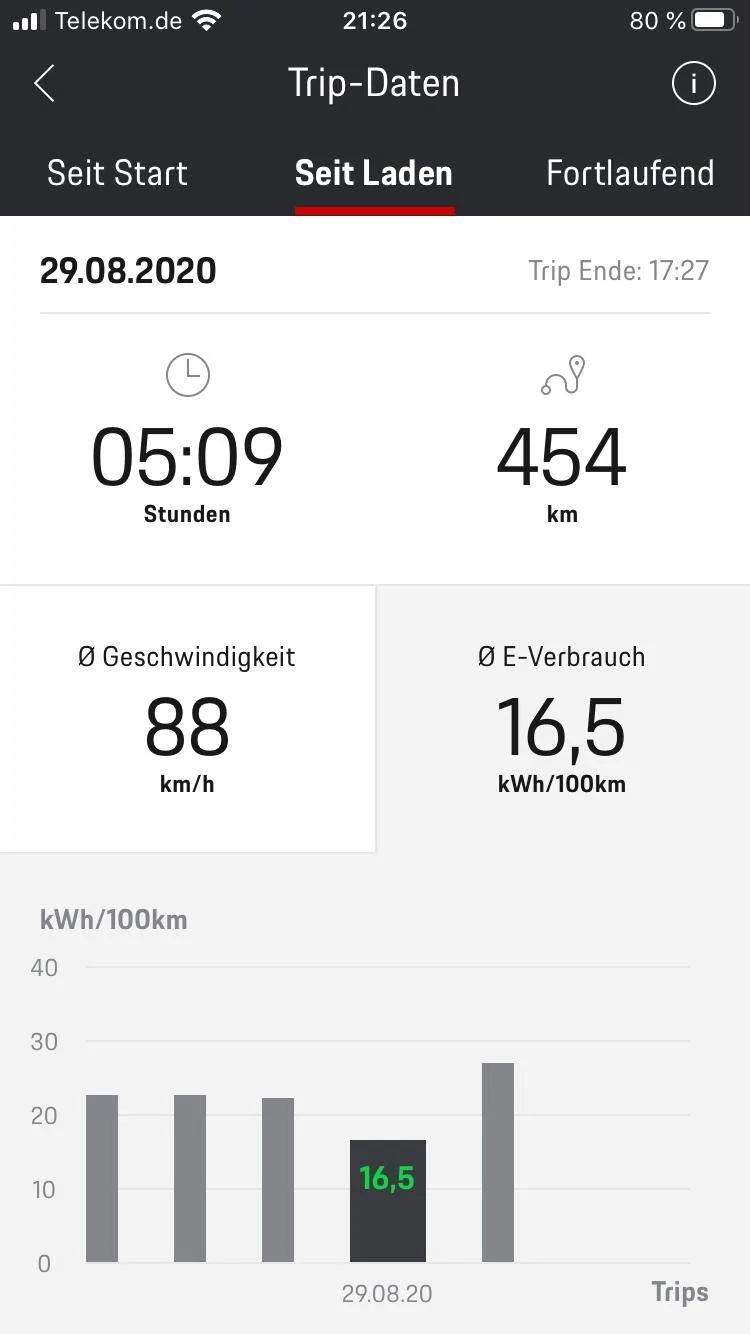

The picture is from my friend in Germany with a 4S and P+ battery. It’s a 282mile range! yes it was summer, I had 250 miles in December.
Can you post a similar picture of your data? That way we can see the consumption figure and usual distances you are travelling. If they are normal then you probably do have a battery problem.

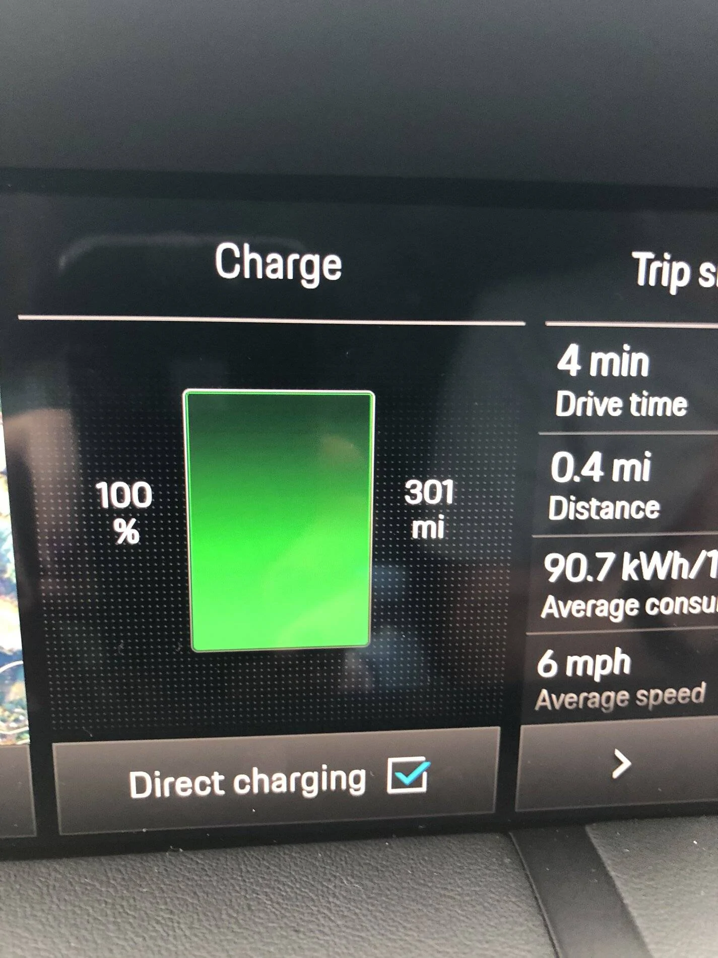

I have had a false positive of 300 miles (once) and never re-appeared - self rectifying software glitch in my case.

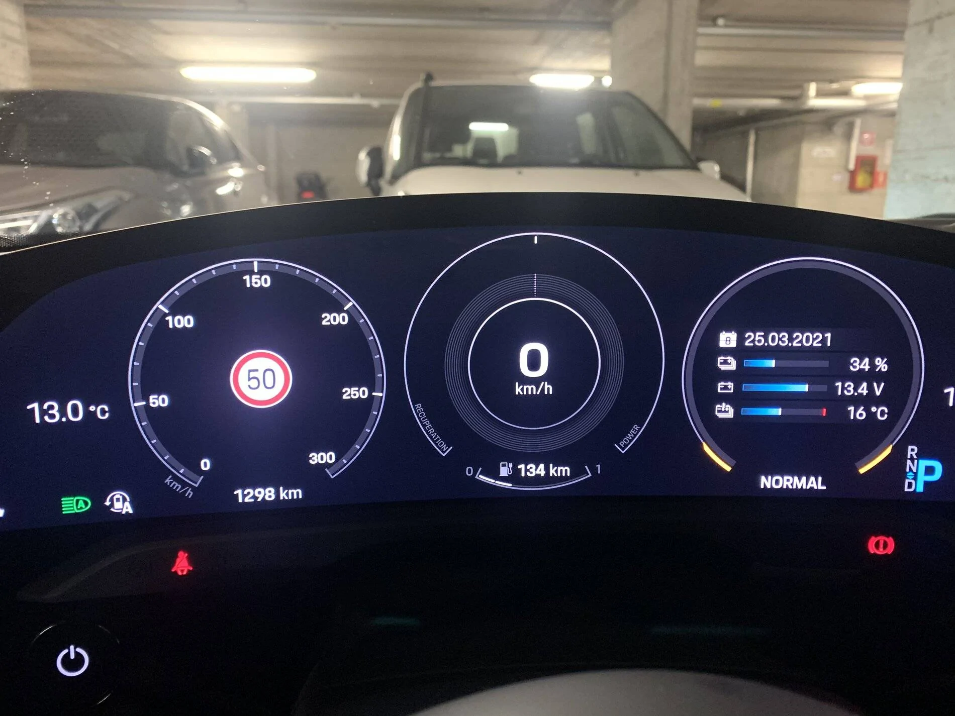

Just my “2 cents” for discussion....today, driving to my office, turned the a/c to eco only...and magically appears many kilometers...a flash from garage before turning off...it’s about 83 miles with 34% Soc...
