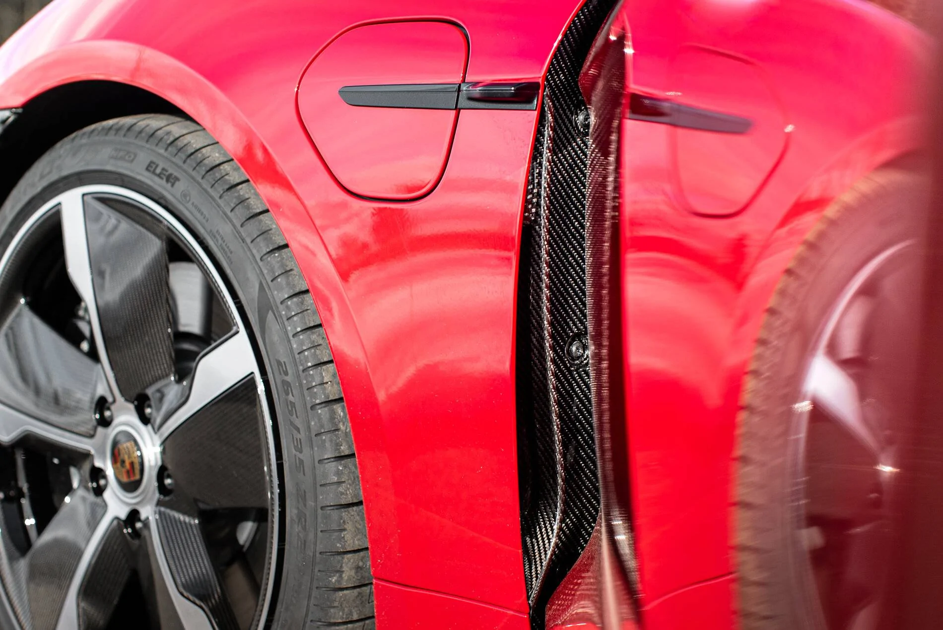

Blocking front wheel arch vents

I read somewhere that these open vents have a measurable impact on the drag. Which translates to increased range. The 19 inch base wheels are also more aerodynamic than the 20 or 21 inch wheels. Cheers!
As stated in another thread, the closed vents improve the drag.
I get that someone posted in another thread that closing the vents improved drag. However, clearly the bodywork is styled to make a vent behind the front wheels possible. Why would Porsche design for a vent opening that would INCREASE drag? OTOH, if the opening behind the wheel is intended as just some sort of design flair, and having it closed off improves aerodynamics, why wouldn't they block the vent on all Taycans and not just the ones where the powered flap hardware gets in the way?
Doesn't make sense to me, unless the vent has a positive effect on aero.

It makes sense that the openings in the front valence would improve aerodynamics when closed; the e-Tron has a similar powered system as do other vehicles.
Since this thread was about the wheel arch vents, though, that's what my comment was about and I'll stand by my assertion that having those vents closed probably wouldn't improve aero and would more likely have the opposite effect.

The vents are there to reduce high pressure in the wheel wells and to help the air curtain. This is common practice on many modern cars nowadays, and generally not considered up for debate.
The result is lower drag and less lift (ie: more downforce) at high speeds. You can read that as a range improvement in higher speed driving.

Closed doesn't make sense due to aero

I also have read the wheel vents are for break cooling. Probably not needed unless you are breaking a lot on a track and because regen breaking reduces mechanical breaking.
Vents behind the wheels in the fender, post brakes, will do nothing for brake cooling. The fender vents are strictly for aero improvement.
