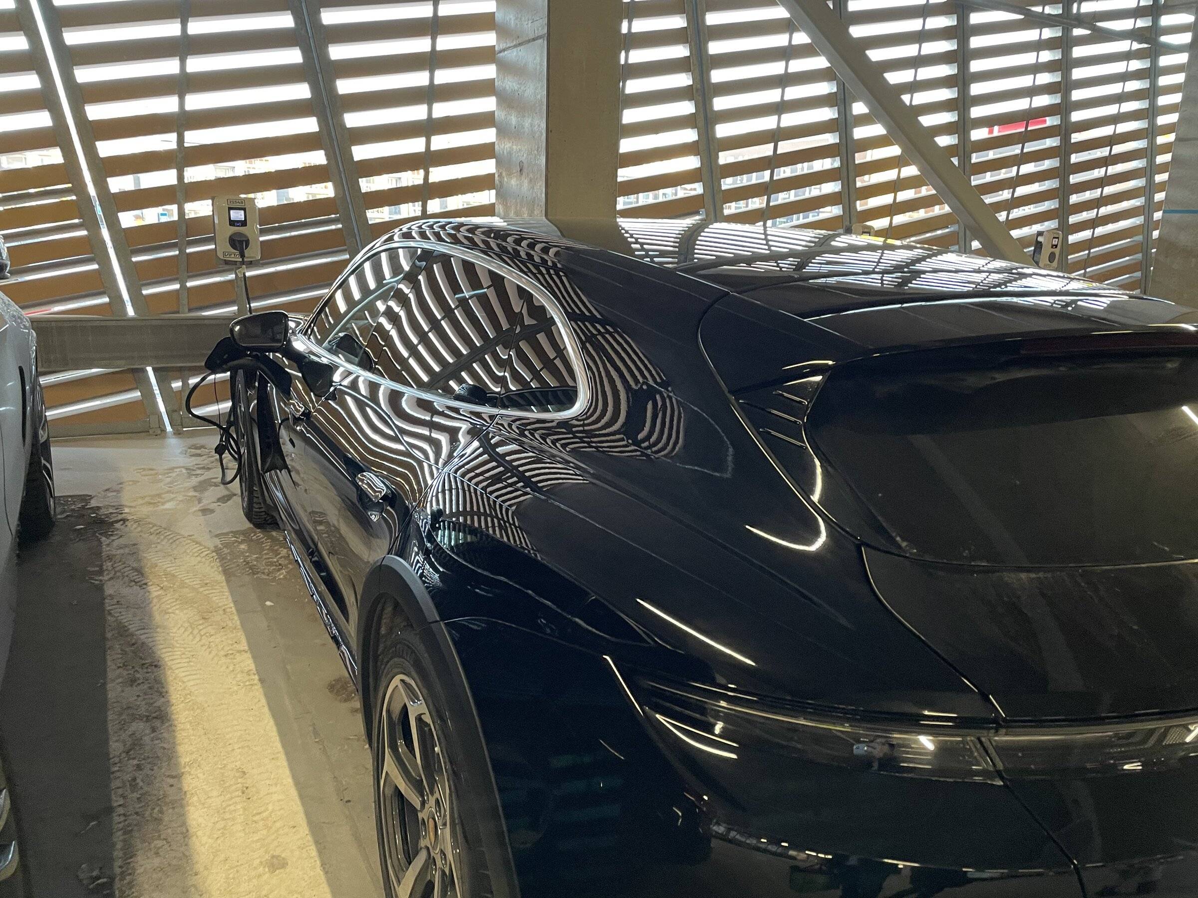

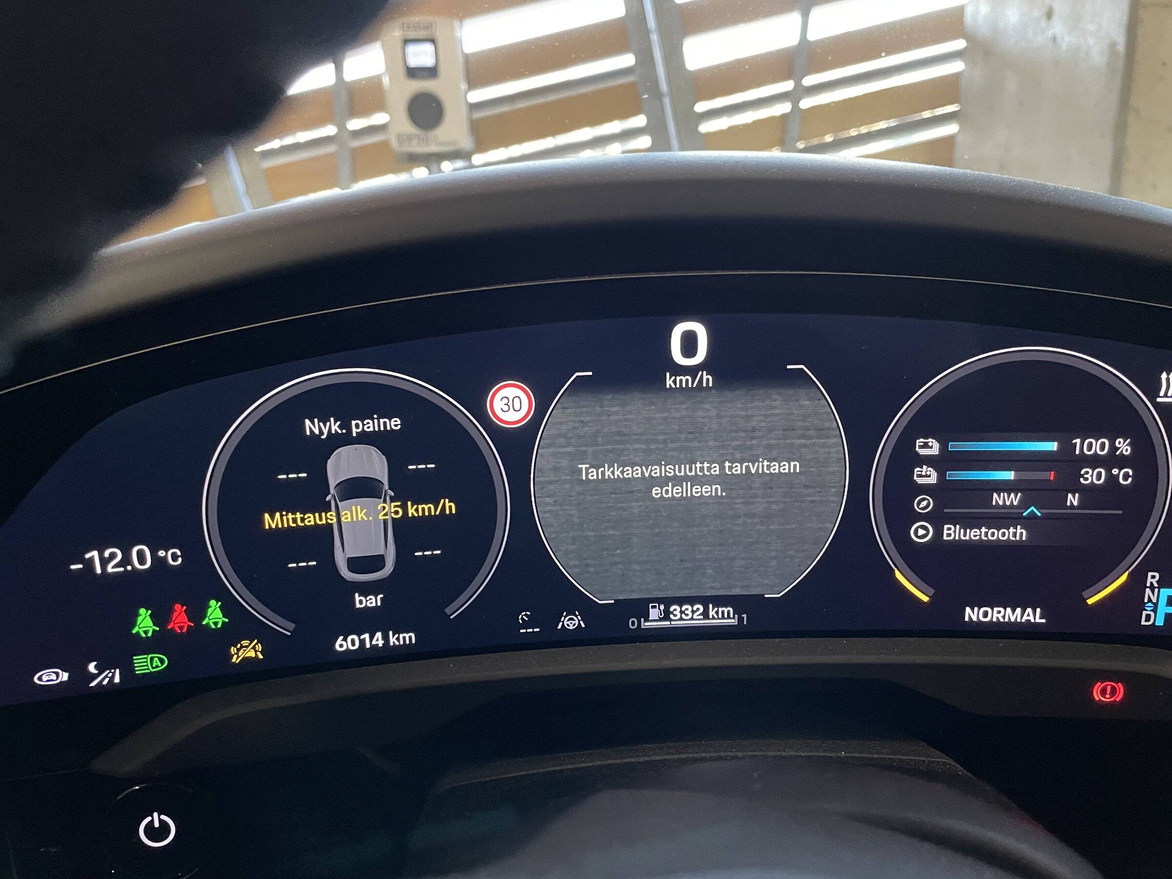

Tested my ”sauna edition” CT4 and set a timer to charge from 91% SOC to 100% (outside temp -12C, cold garage carpark with a public charger). At departure the battery temp was again +30C, it seems to precondition the battery in this setting. No idea what sets it off, would be interesting to see if same happens on a home installed 11kW charger.

Tested today to charge only to 80% with preheating and the battery temp was 17C (outside temp -12C ?) at departure.
I have noticed the same as Doc B mentioned, that the Taycan uses energy first to warm up the battery before charging.

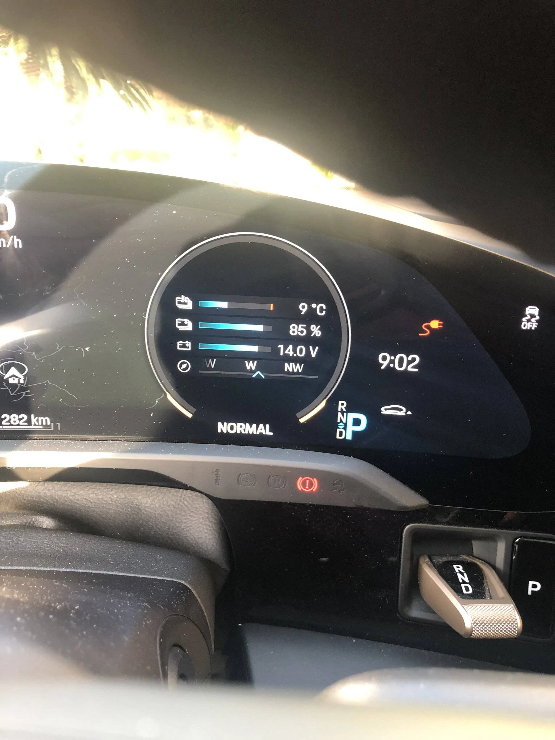

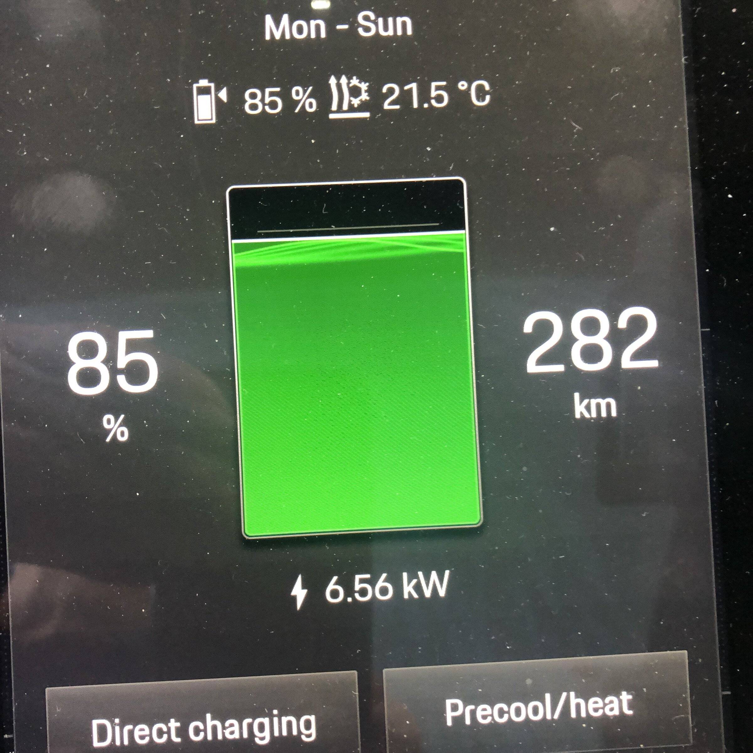

So yesterday I tried out the pre heating feature. During the night the air temp out side was around 7 to 8 degrees. Battery temp at start 9 C. That car had been charged a few days earlier to 85% so no charge was needed. Only preheating set to 21.5 C. I only did this about an hour prior to leaving. I have a 3 phase connection that can deliver the cars full 11 kW.
Porsche Taycan Can you preheat the battery? 7F13758F-14D5-4572-BE31-79BD912DEBC5
Porsche Taycan Can you preheat the battery? C73CBA56-BFA4-4D0C-B2C4-DF0FCEB14D0F
The car was showing 6.56 kW input power from the grid, not the full 11 kW which the car can take. The PMCC showed just over 7 kW so the difference is the loss in the cars charger.

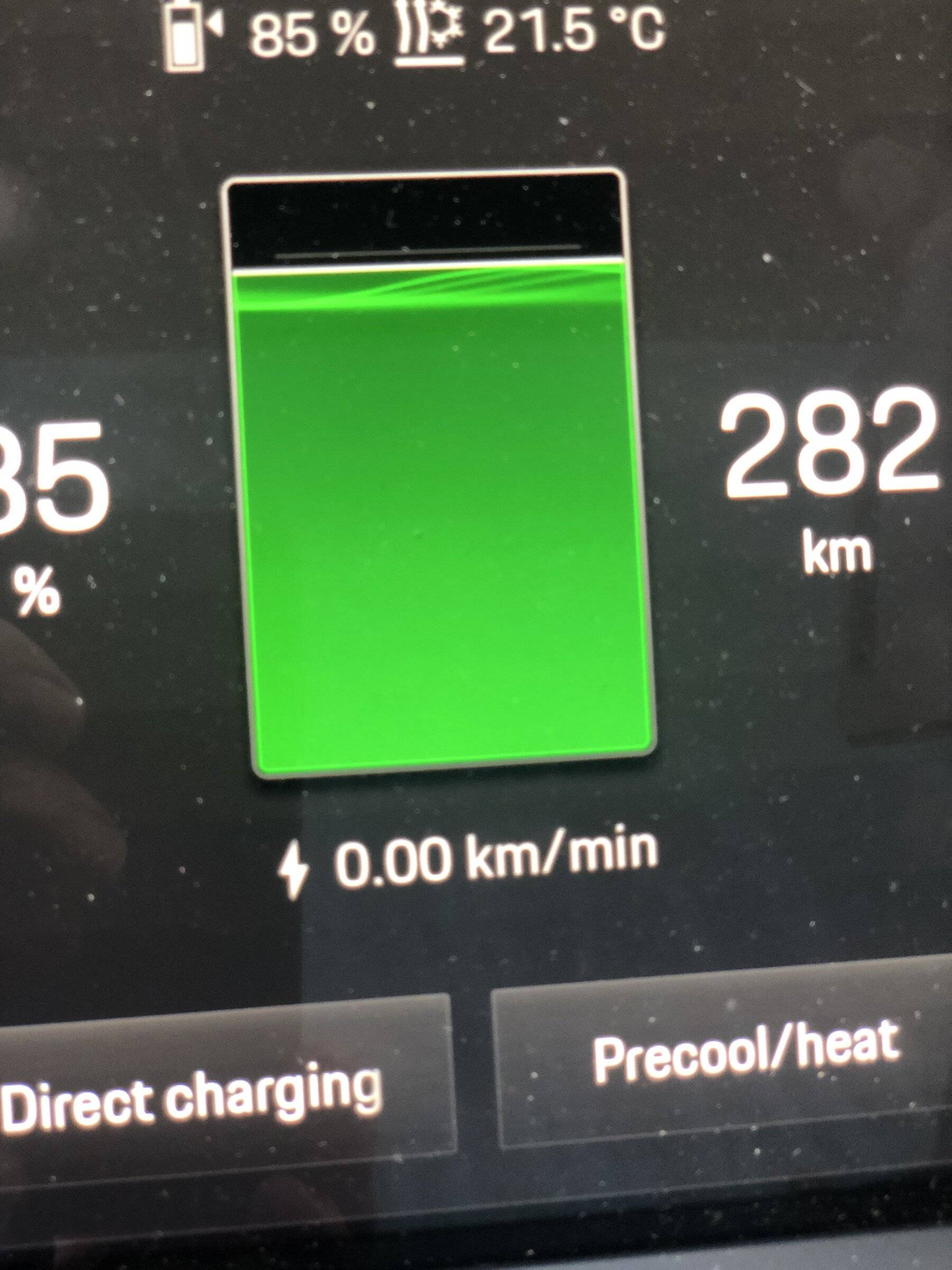

When looking at the the rate that was put in to the battery it showed 0 km/min, which means all the 6.56 kW was used to heat the cabin as well as the battery!
Porsche Taycan Can you preheat the battery? A77192DB-CDD9-47E2-A429-16A7E1423279

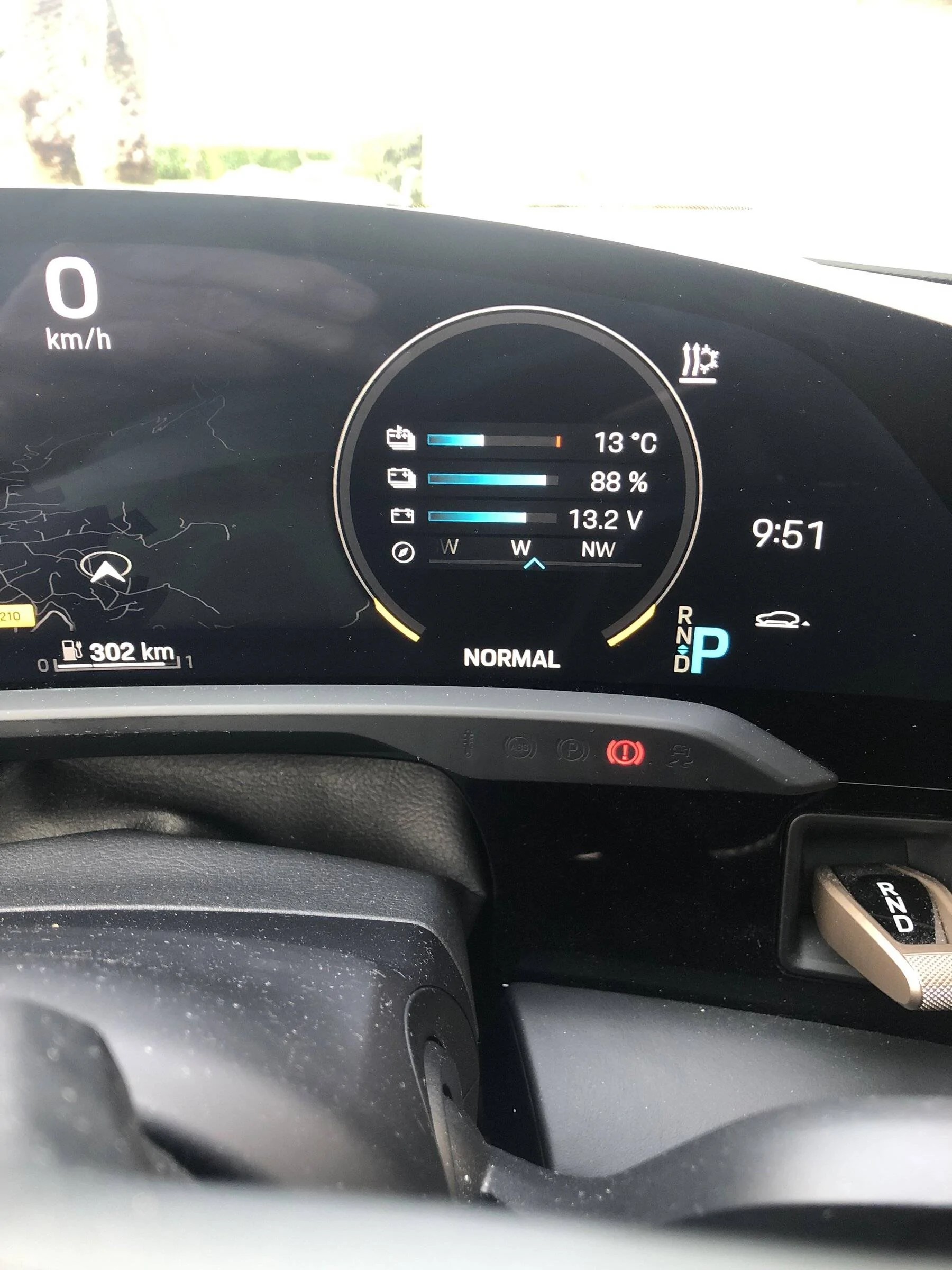

When it was time to leave, the battery had heated up a bit to 13 , nowhere to the 30 C that has been described here. But still heated.
