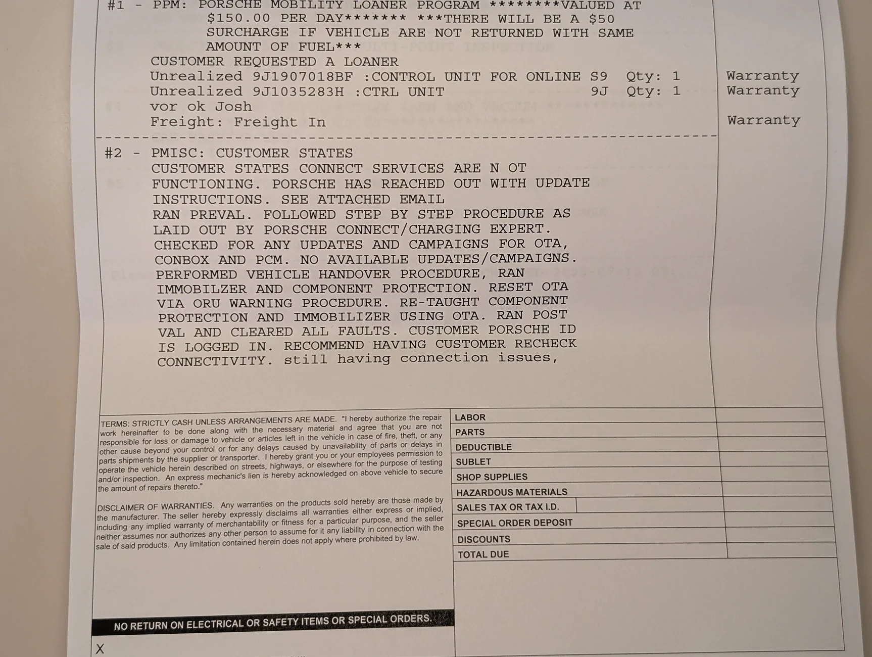

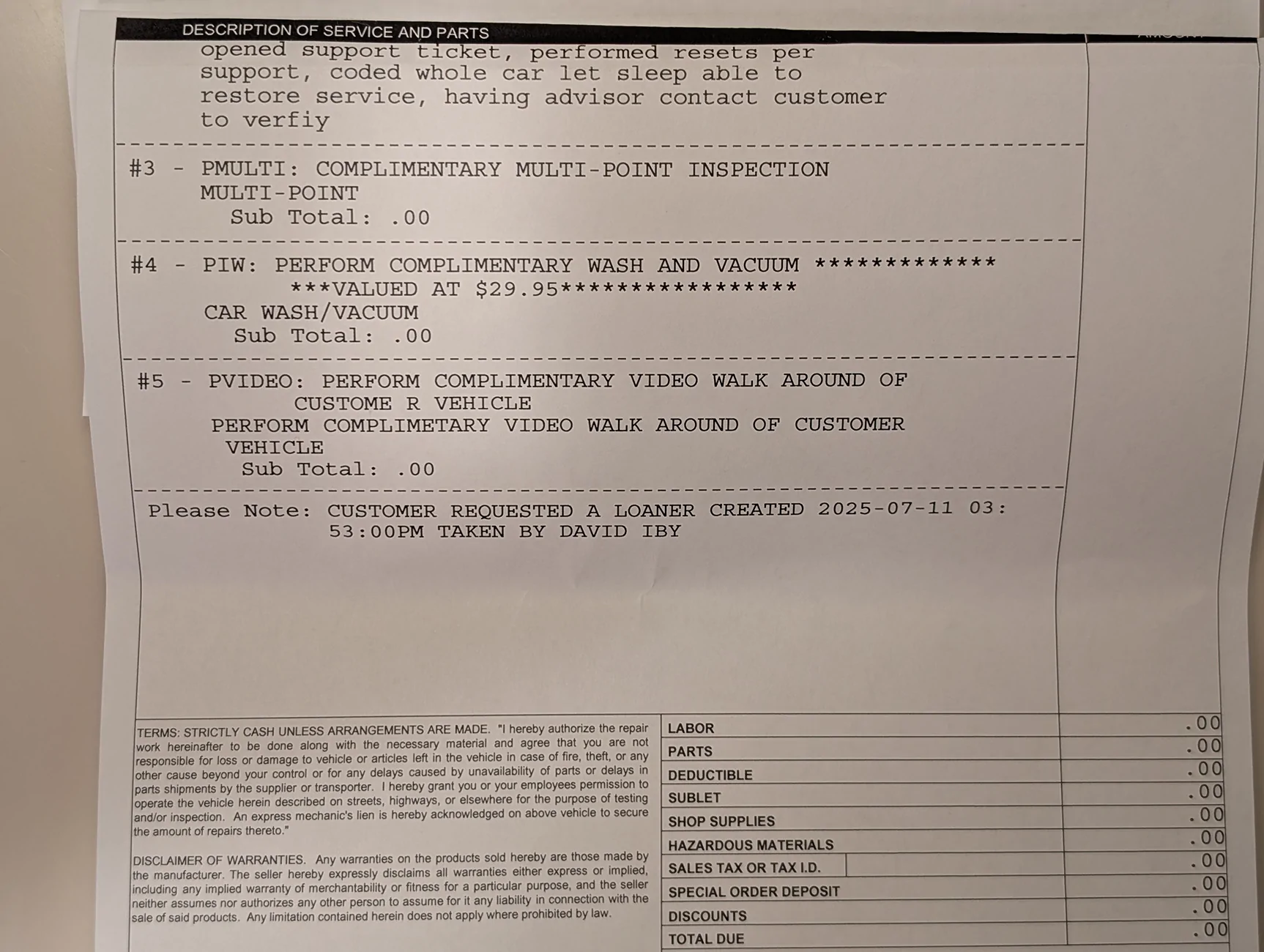

My J1.2 is back in my garage today, with its connectivity issues fixed. It was the end of the day when I picked it up and I wasn't able to talk to the service advisor, so I still have frustratingly few details about what actually fixed it, but the answer seems to be:
"performed resets per support, coded whole car let sleep able to restore service".
Huh. So basically every module in the car had to be reintroduced to every other module, then they all took a nap and when they woke up again all was well.
I didn't even lose any of my settings.
Time in the shop: 16 days.
I've attached the receipt in case this proves helpful to anyone else, but I still don't have the actual list of tasks that Porsche sent to the dealer. There were apparently 2 such lists, the first didn't fix the problem so they got a second one. I'm still trying to get my hands on those lists. If I can do so I'll post them here too.
There are 2 parts listed on this receipt, the conbox and another ctrl unit. I don't believe these were replaced; it's a little strange that they're listed here, but I think "Unrealized" means they were not needed. I don't think they were ordered either.

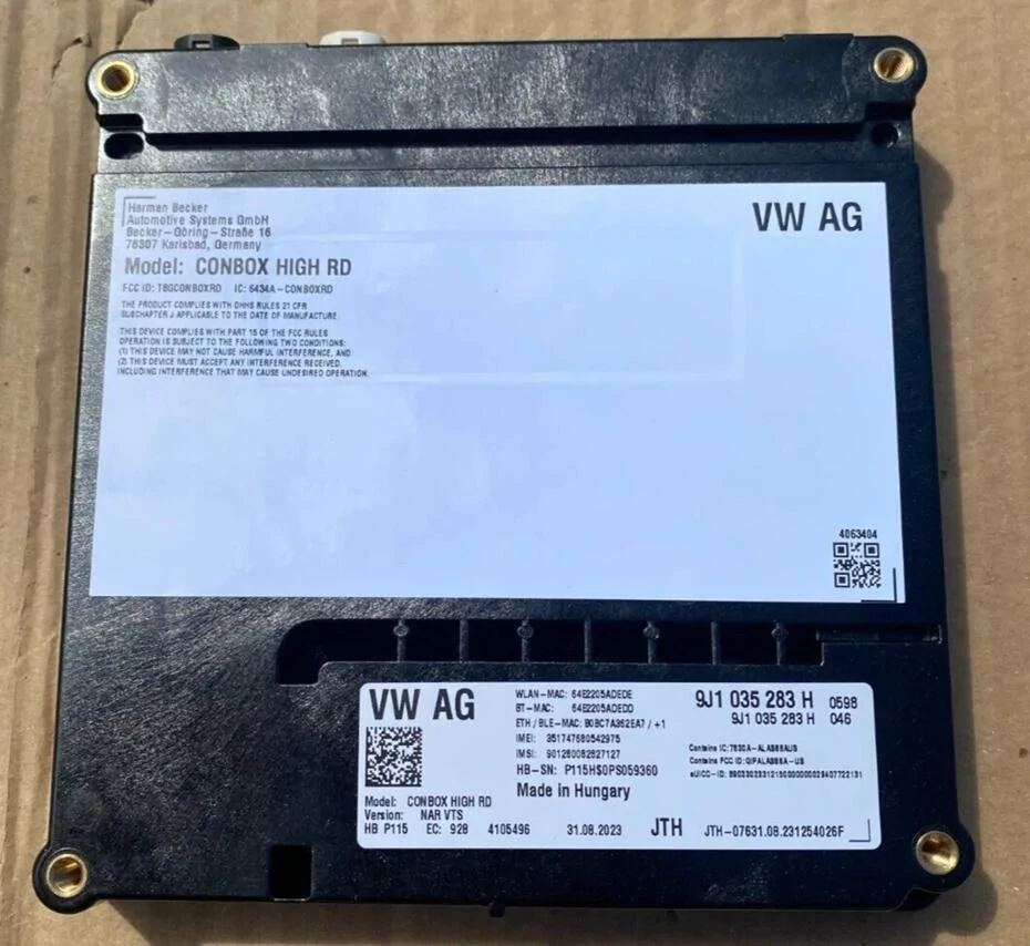

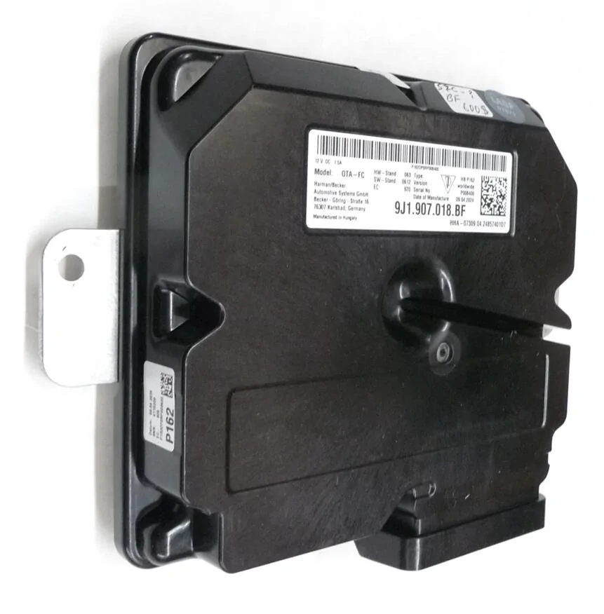

Thank you for posting receipt. I looked up the two part numbers - full names and photos below.
Interesting that dealer said power disconnection which worked for 20-24 Taycans does not work for 2025 Taycans. Also, the fix for your 2025 did not require hardware replacement.
"Vehicle handover procedure" in the service notes is likely something like this TSB: 2022 Taycan – Ensuring Porsche Connect Functionality During Vehicle Handover
9J1035283H Conbox High:

9J1907018BF Control Unit for Online Services (Formerly Over-the-Air Function Controller (OTA-FC) ):
Porsche Taycan Can't log in to PCM - ideas? 1755961341563-ch
