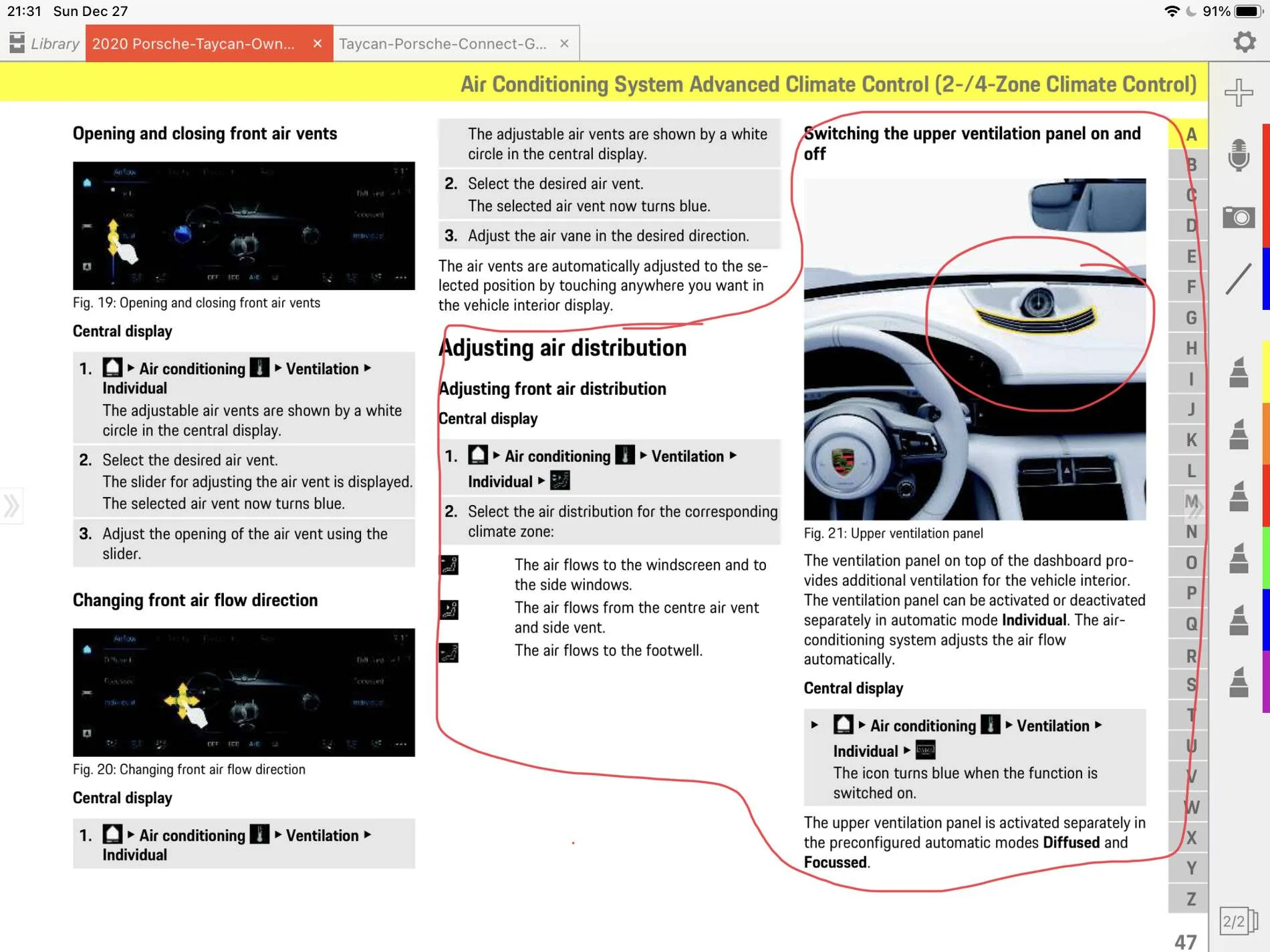

Maybe this can help if you have not tried it yet.
I believe the center vents in front of the sportcrono clock offer additional ventilation to the upper center portion of the windshield.
(Do not know what the non sprotcrono glare shield looks like similar I believe).
Page 47 US manual.
I am in rain, snow and mountains. Have only had the car 2 months. Temps currently 5 to -5 C.
I had a little misting on the front passenger window a month ago. Adjusted the center vent with this procedure. Have not seen any misting since.

Thank you, I’ll have a play around and see what results I get. However, that said, surely the Max Demister option should channel hot air at all sections of the screen, otherwise it’s a simple design flaw?
